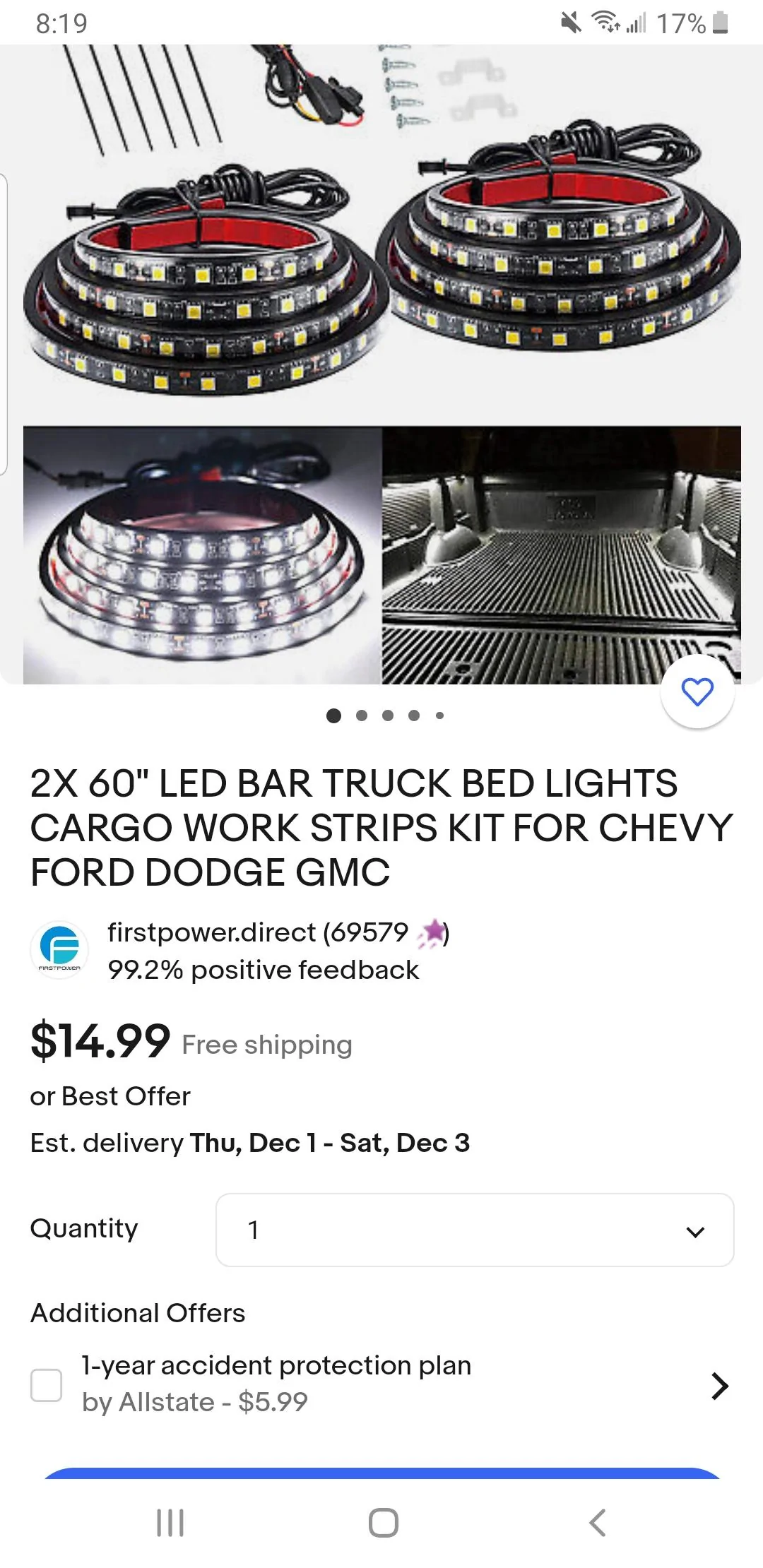

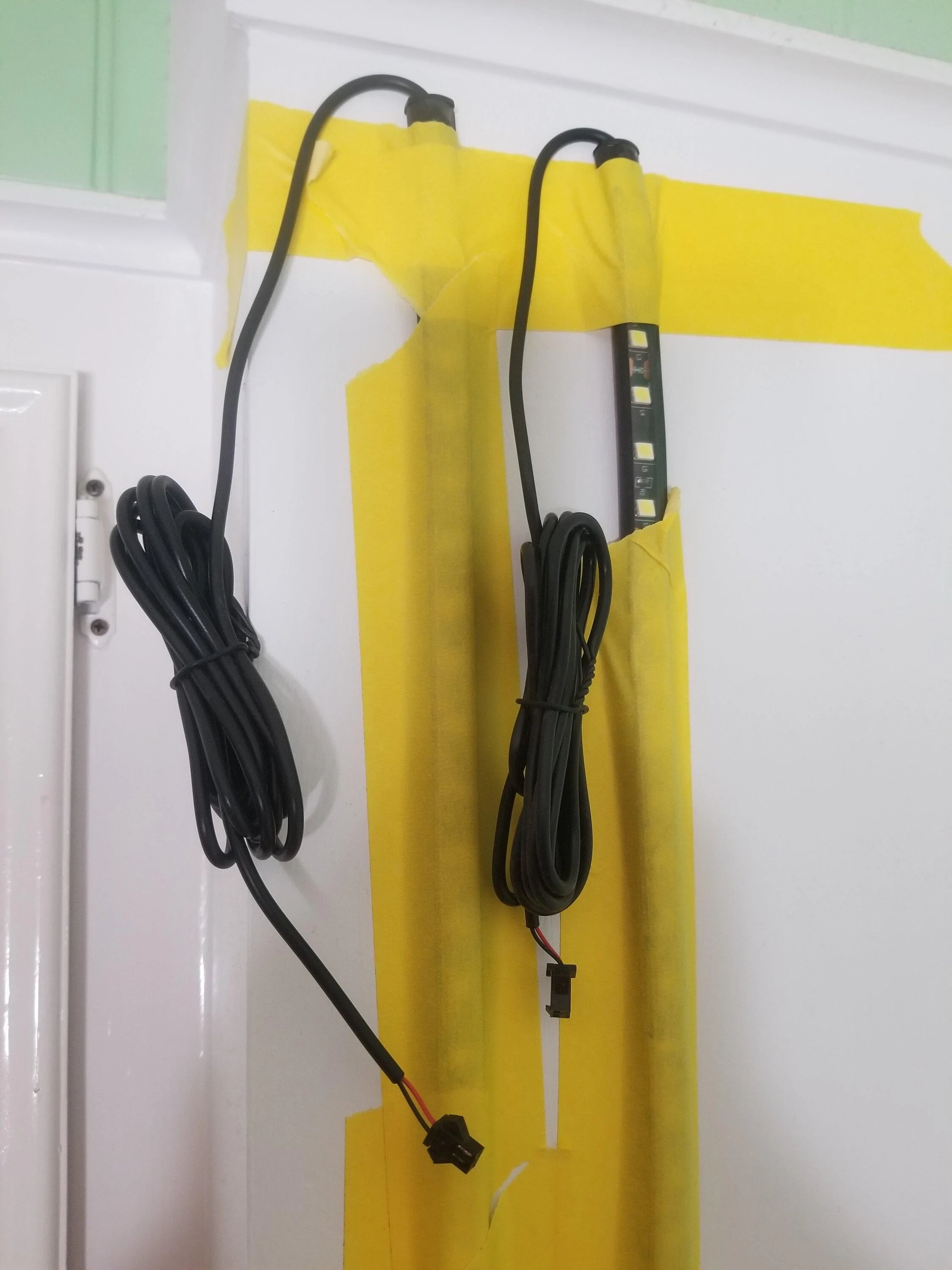

One of my many projects is the bed lighting. I have had this kit in its box for about 7 months now waiting on this truck. This is a pretty much plug n play kit. Your wiring is red to red, black to black on the Flex bed plug in. $27 from evilbay. The hardest part is going to be feeding the wires into the bed box to hide them.

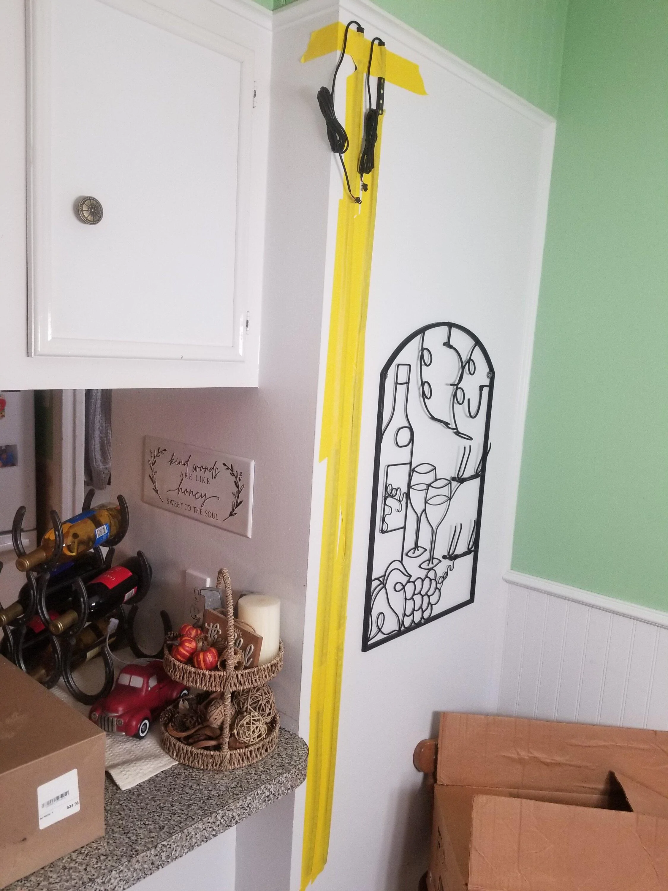

Of course its 40° out now and the LEDs wont uncoil. So my eureka moment was to tape the strips up on the wall in my dining room. I am hoping that the warmth of the house will help straighten them out over the next few days.
Could you send a link for these? Thanks

Wow, the price went down. Here they are. Maybe I only payed $20 for em. I honestly cannot remember.

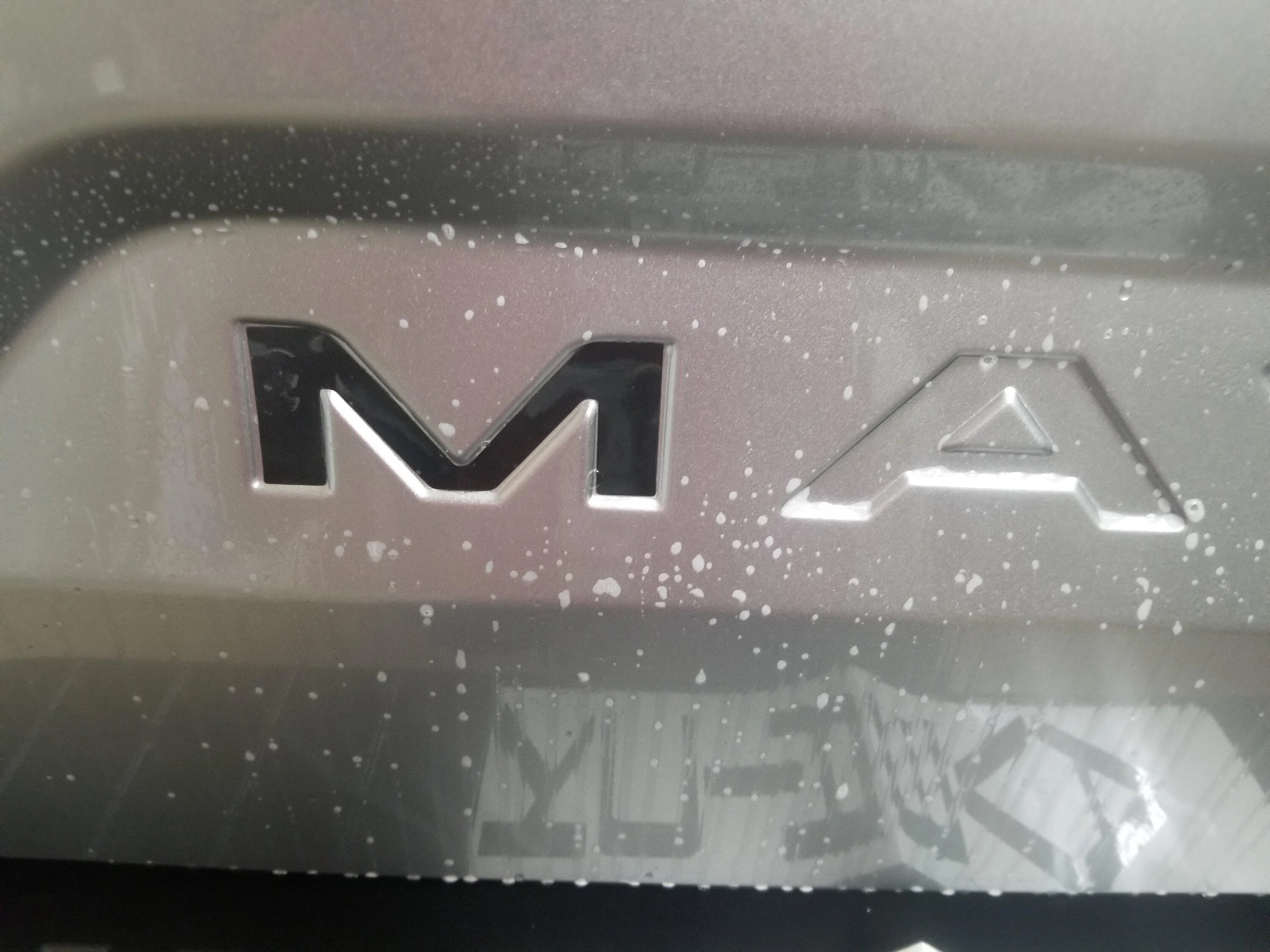

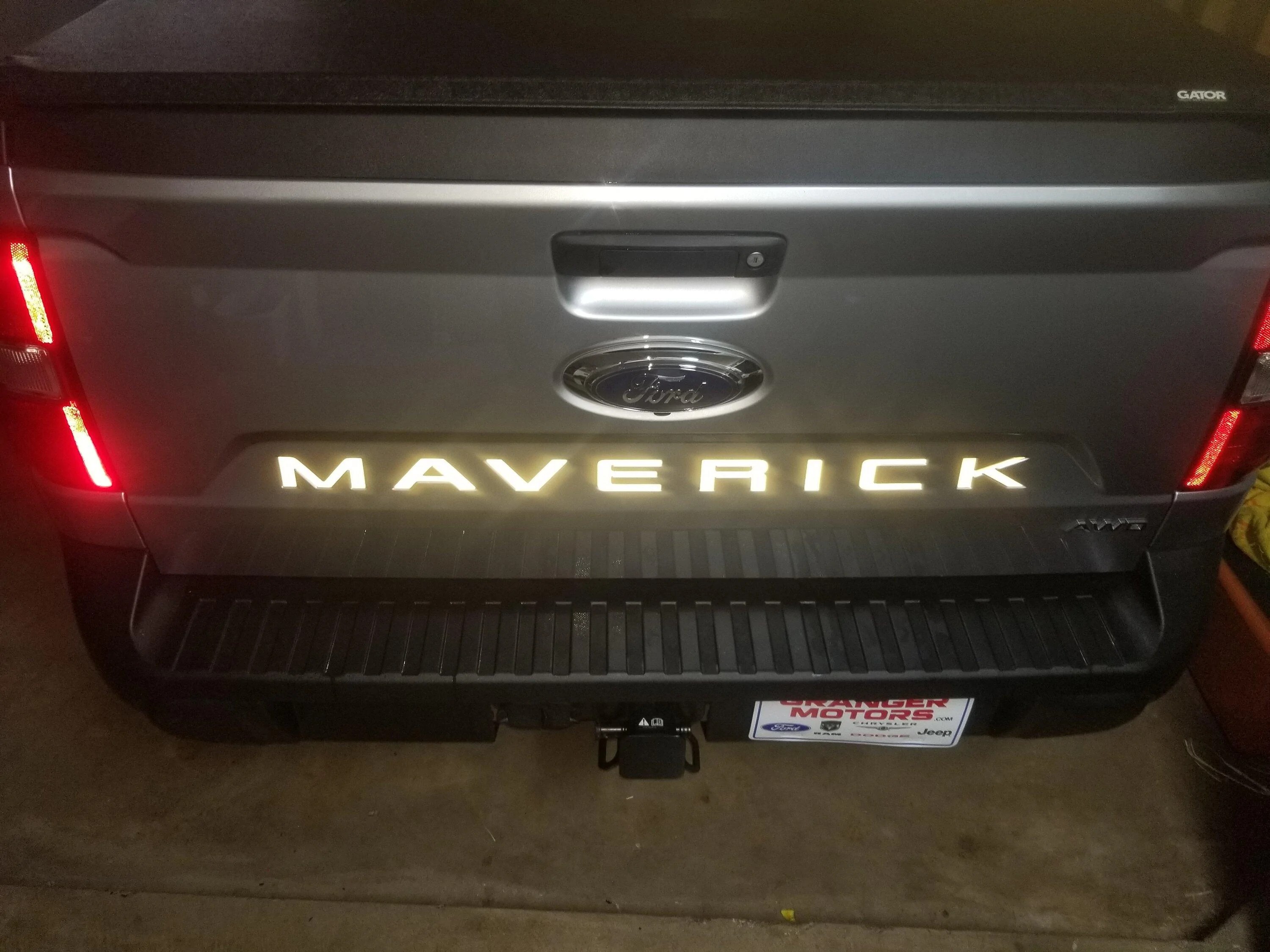

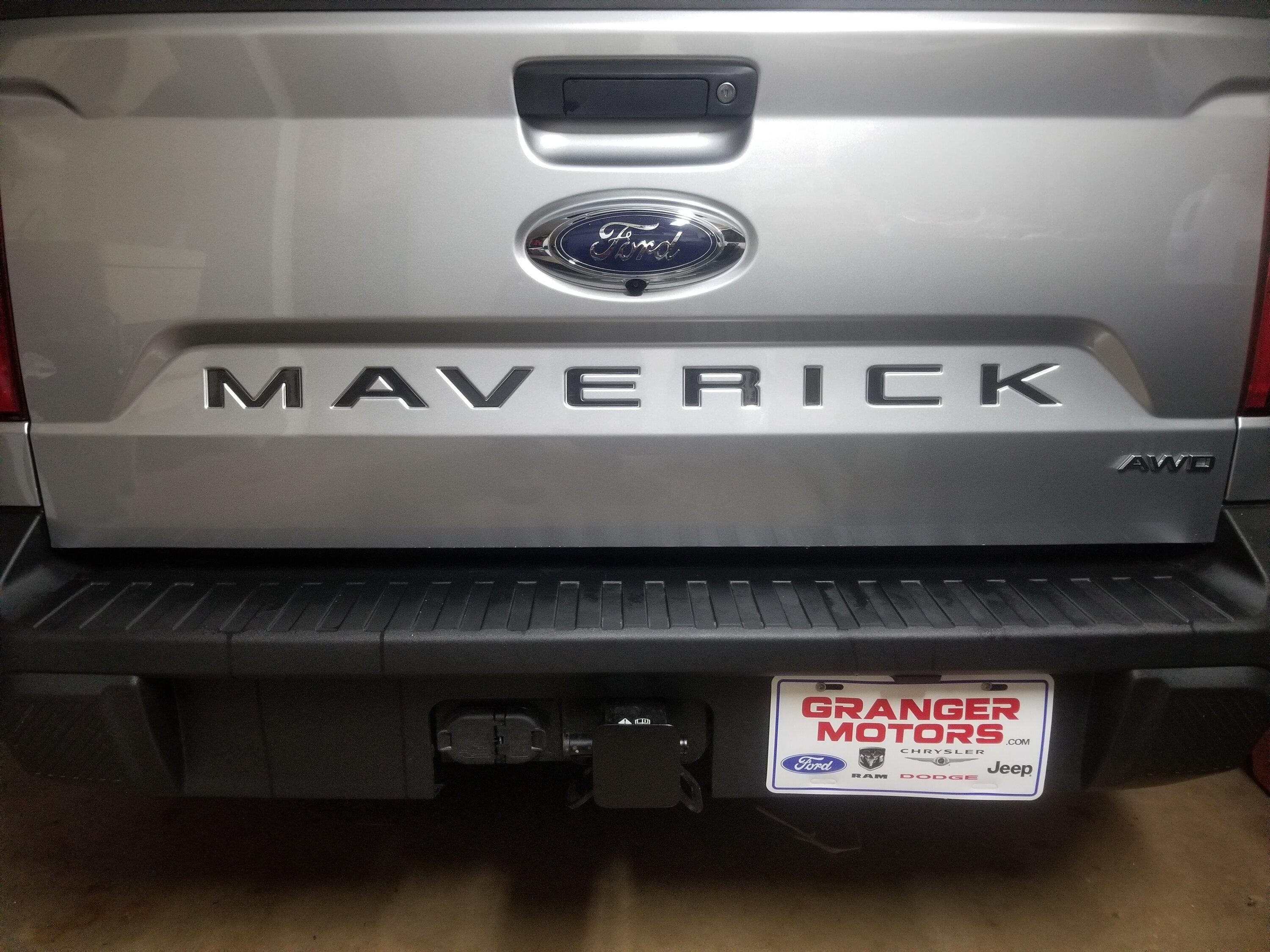

Heres todays how to for the novice. Maverick decal letters. Decals on a car arent just peel and stick. After washing and drying the area where the letters go, you put a "few" drops of soapy water in a spray bottle. You spray where the letters go, then peel and set them in place. This allows you to slide them around to get them where you want them. When they are where you want them, then you press down on them gently with a paper towel to wick out the water. I went with reflective black.

I was scared 💩less doing the tailgate letters, the soapy water made it much easier.
Is that iconic silver?

I went with black matte on the tailgate letters and just realized that we’ve got twins. Iconic silver XLT, but fraternal not identical, EB and hybrid
