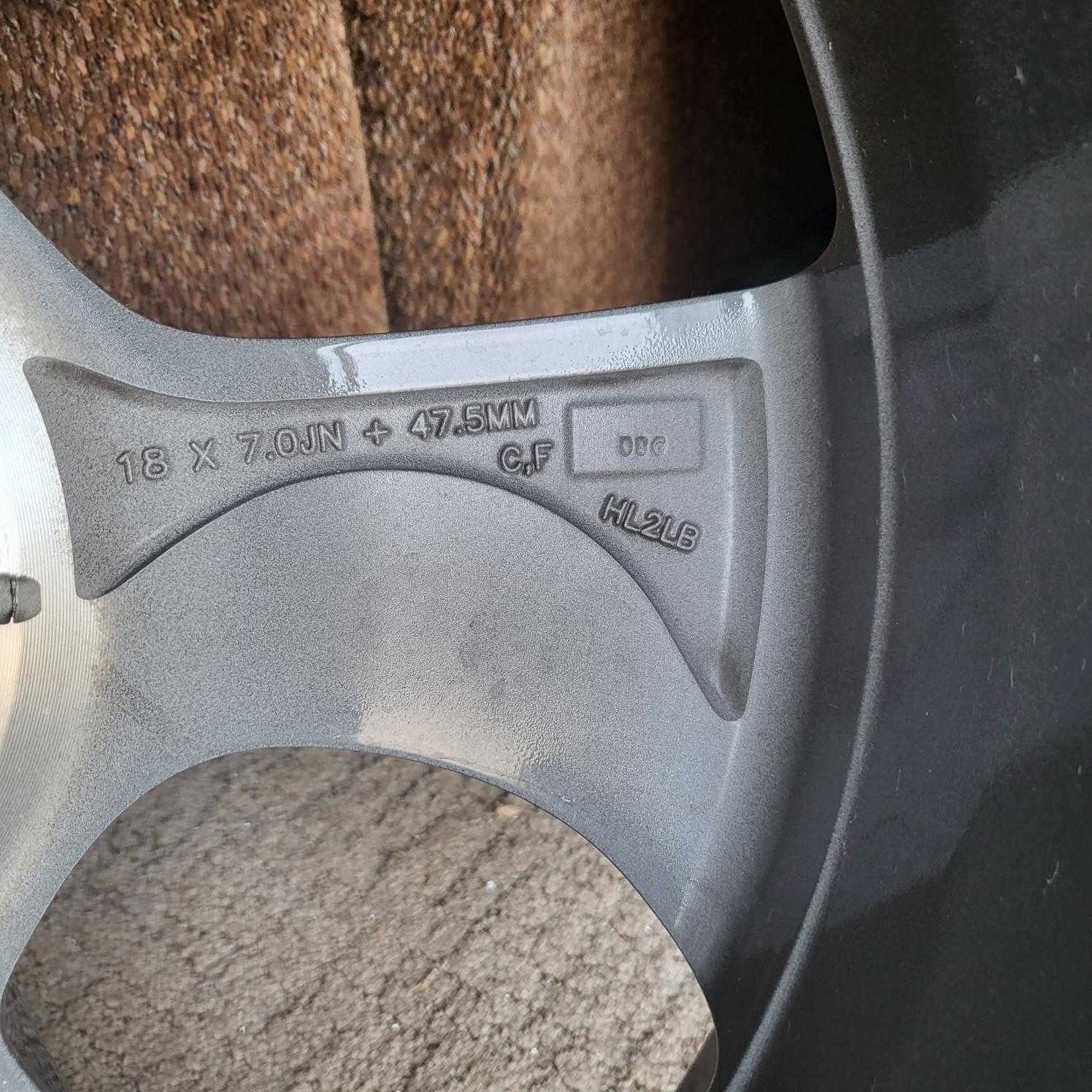

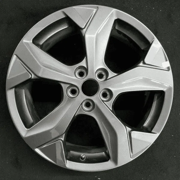

Jumping in this thread. I got a set of the standard Y-design Mach-e 18" wheels. They look like this. I think the color is going to look nice with the catcus grey. Was looking for something cheap that was an improvement to the steelies, and managed to get these for $800, hardly used with tpms installed.
I have never swapped wheeles before, so not exactly sure what I am doing, but I think I can just take the old ones off and put these on. Planning to do it myself. I've heard the tpms will program itself.
I was a little worried about the sizing and offset but asked around these forums and people said there would be plenty of space. They are 18 inch diameter, width of 7 inch and an offset of 47.5MM. Tires size is 225/60/18.
Only thing I am not sure about are the lugs. I think I an just use the lugs from the steelies.
I too think you will be fine with those wheels with the stock tires. you may want to go with a larger tire (235/60 or even 245/60) when those wear out. That will look better and fill up the wheel well better.

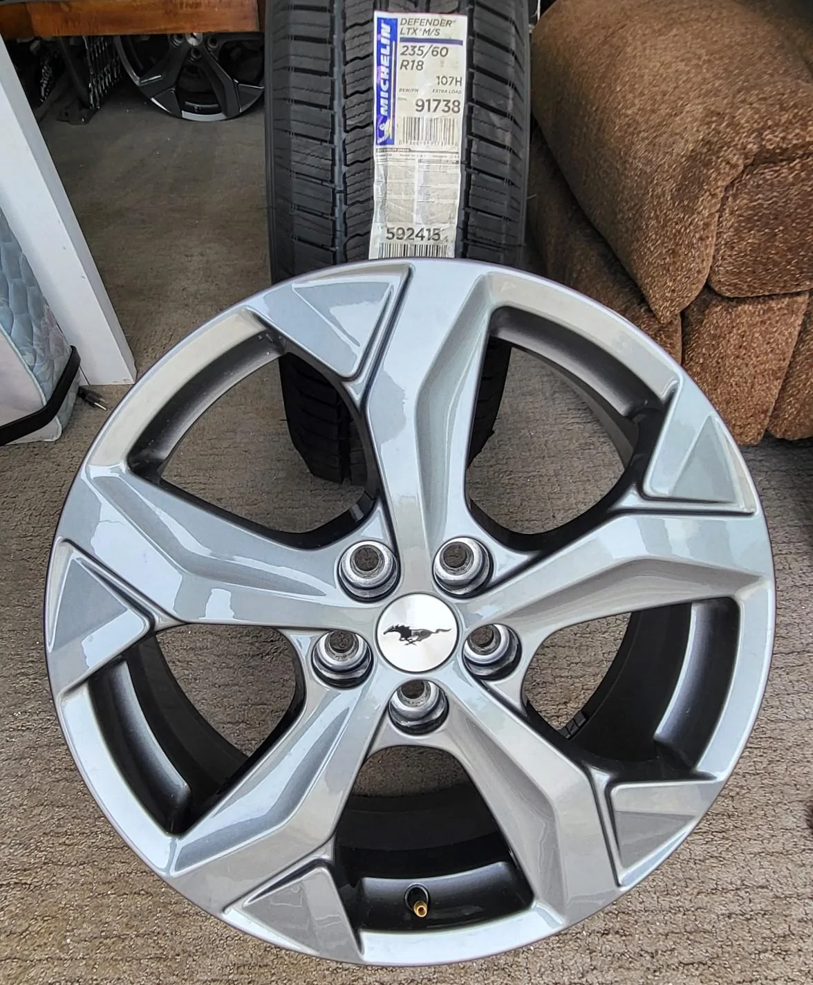

I also bought that exact same set of wheels for my Mav (if it ever gets here) for $250 off of FB Marketplace. Already have new Michelin Defender tires 235 60 18 to go on them. I may have to get some spacers due to the 47.5 mm offset. I will have to test fit when I (hopefully)get the Mav. Please post some photos when you get them mounted. I would love to see them on a Mav. Also, will be interested in seeing what lug nuts you use. Best of Luck!

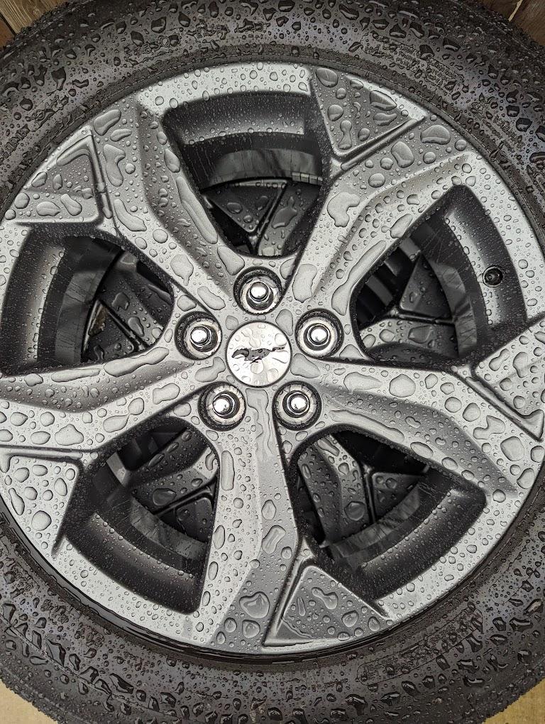

I got these nuts off of amazon (https://www.amazon.com/dp/B00B2FCAMI). I think they should work. Here's what it will look like:
My hybrid xl is due in a few weeks. Lining up a set of these to swap as well.
Looking forward to seeing pictures of yours first!

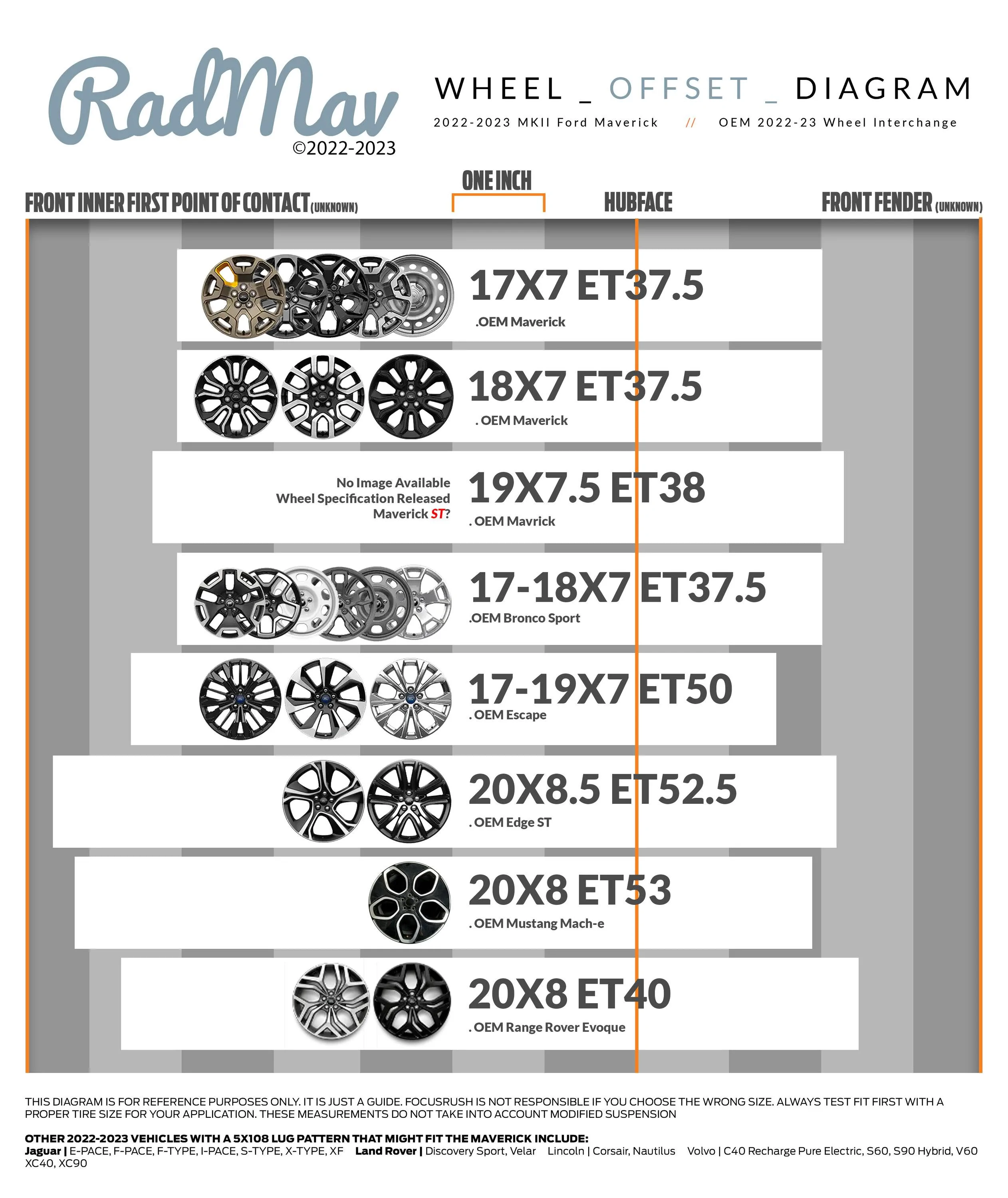

My math says they should sit 3/8” inward from stock. I doubt that will be noticeable.

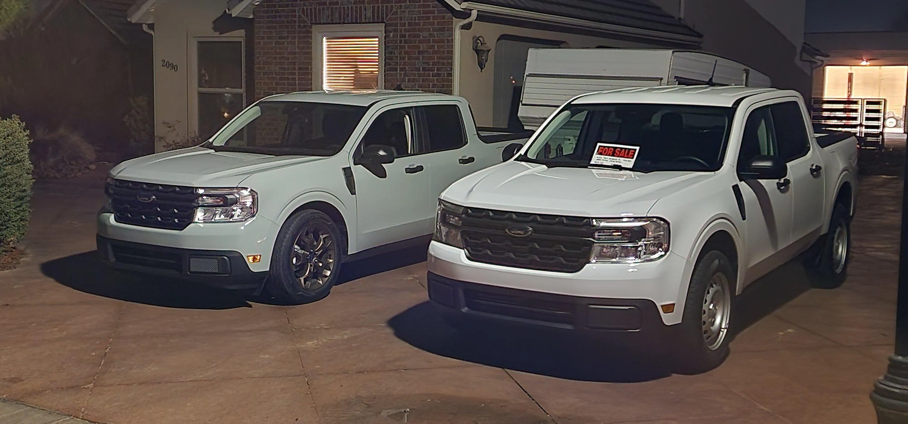

Put these on about a month ago... I knew I wanted these Mach-e 20s when I first saw them. Not a fan of the plastic inserts they come with, they look much better without, IMO. All your trucks look badass with their new wheels, so many options with this bolt pattern.
