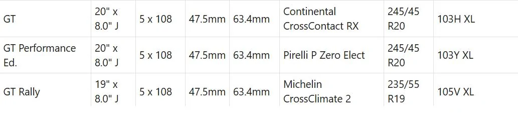

I don't know of anyone who has tried them yet on a Maverick. The only other major difference I see besides the diameter(18" on Mav versus 19"-20" on Mach-E)is the offset. The Mach-E has a 47.5 mm offset versus 37.5 mm on the Mav.
I'm not a wheel guy so I don't know if this will make a huge difference just throwing out here so you have the info. Here is a nice chart I found to break down the different dimensions of the Mach-E GT, GT Performance, and the GT Rally. Hope this is helpful!
Ford Maverick Mach-E performance wheels - anyone install? mach-e wheel dimensions

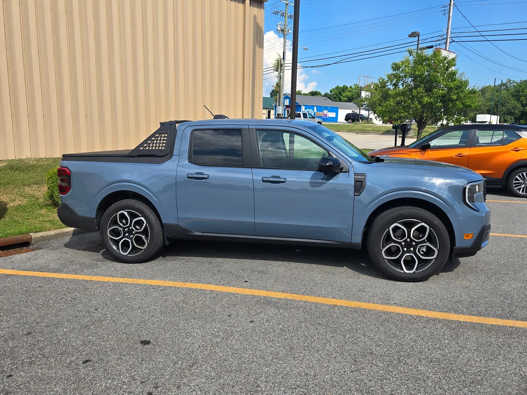

They fit just fine with 255/50R20 tires.
Ford Maverick Mach-E performance wheels - anyone install? 20250710_170011
