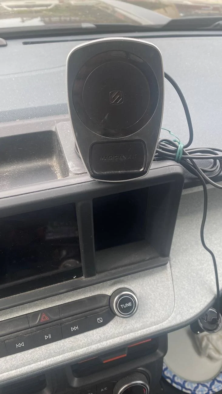

Speed 65 MPH. Phone in phone holder above front cubby. Farther from the noise than driver's ears, but it was consistent placement for comparison purposes. Phone never moved. I only had to tap record and stop.

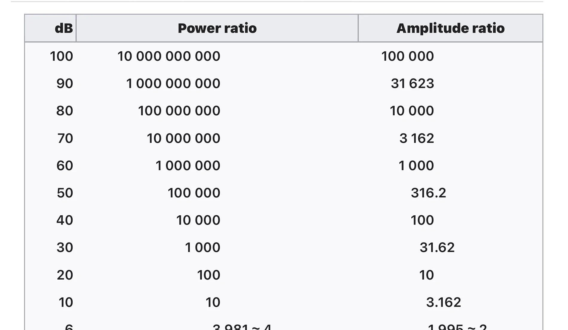

dB is a logarithmic scale : a few points means a lot

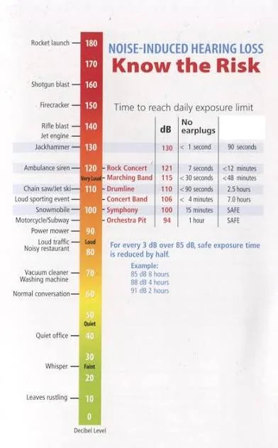

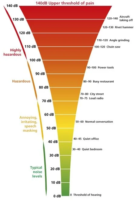

For reference:

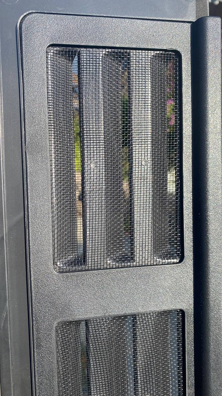

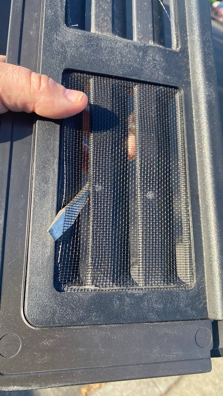

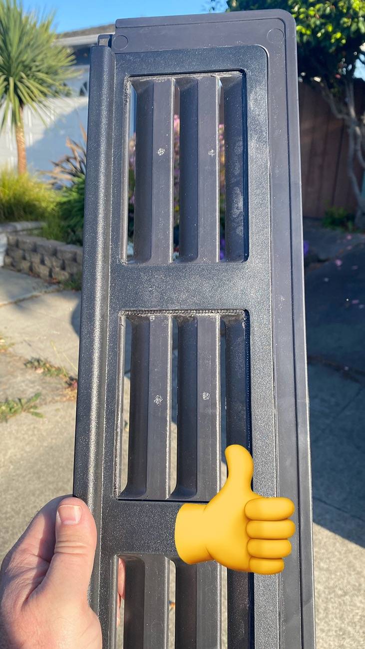

After coming to grips with I couldn't stand the whistle, whine, hum, or buzz above 35 mph, and I probably wouldn't put them in and out every time I parked since it requires the key to be "on" so you can use the powered windows; I made some modifications.
IT IS THE SCREEN DOOR MESH MAKING THE NOISE. So I cut it off. It is metal wire mesh sandwiched and glued between two layers of plastic. Probably plastic cement was used. Not wanting to risk breaking the plastic I cut out the wire.
Ford Maverick Mabett Window Vent Honest Review IMG_3353
Ford Maverick Mabett Window Vent Honest Review IMG_3358

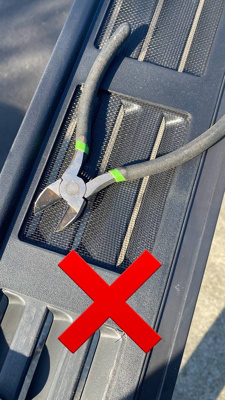

Cutters would take too long and you have no starting edge.
Ford Maverick Mabett Window Vent Honest Review IMG_3354

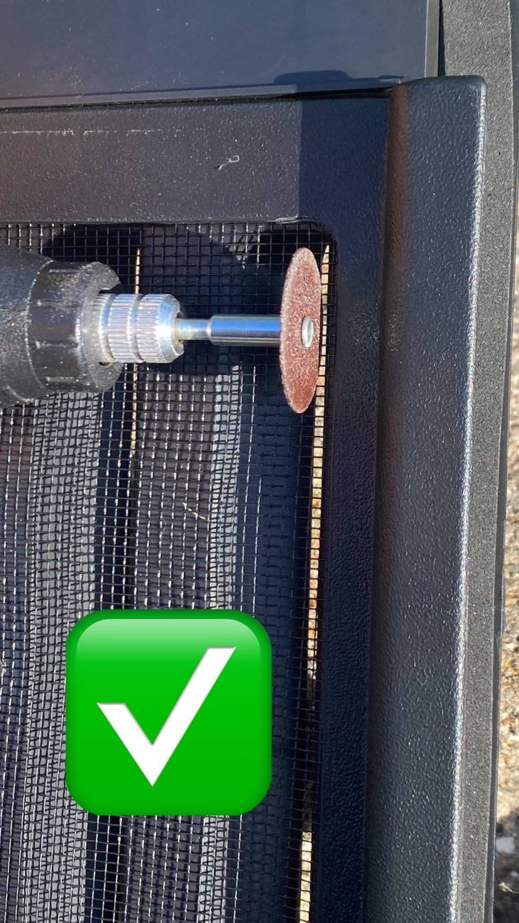

Took 60 seconds with a small cut off wheel. Use the clippers for any "hairs" left behind.
Ford Maverick Mabett Window Vent Honest Review IMG_3359
Ford Maverick Mabett Window Vent Honest Review IMG_3360
Ford Maverick Mabett Window Vent Honest Review IMG_3357
No whistle. No buzz. Just normal road noise. And NO BUFFETING at 65 MPH with fronts closed.
Up to you what to do. But now I'm more inclined to leave them in for prolonged periods.

Well - someone is ready for the summer heat!
Yeah, I'm glad you found something that works for you. To me, the screen is the only advantage these have over vent shades.
