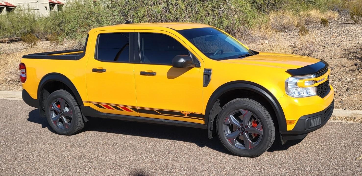

Here’s what they look like on my Maverick. The jacket I had done is added just for fun.

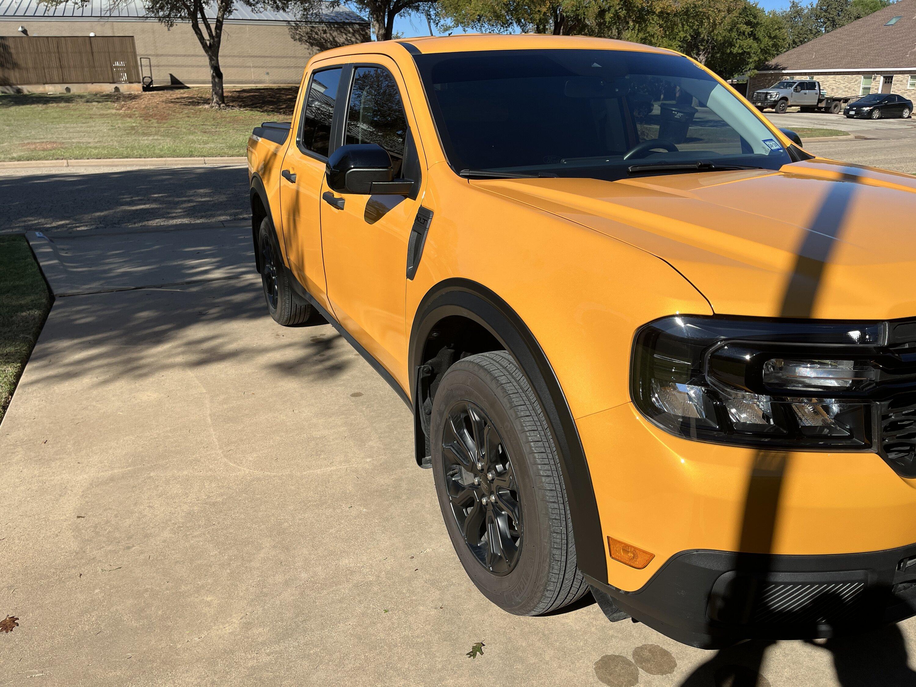

Installed mine on Saturday with mud flaps. Also installed bug deflector, grill bar lights.
Back 2 flairs went on perfectly. Front 2 flairs, tabs did not line up had to drill new holes and sticky tape would not hold. Had to use silicone.

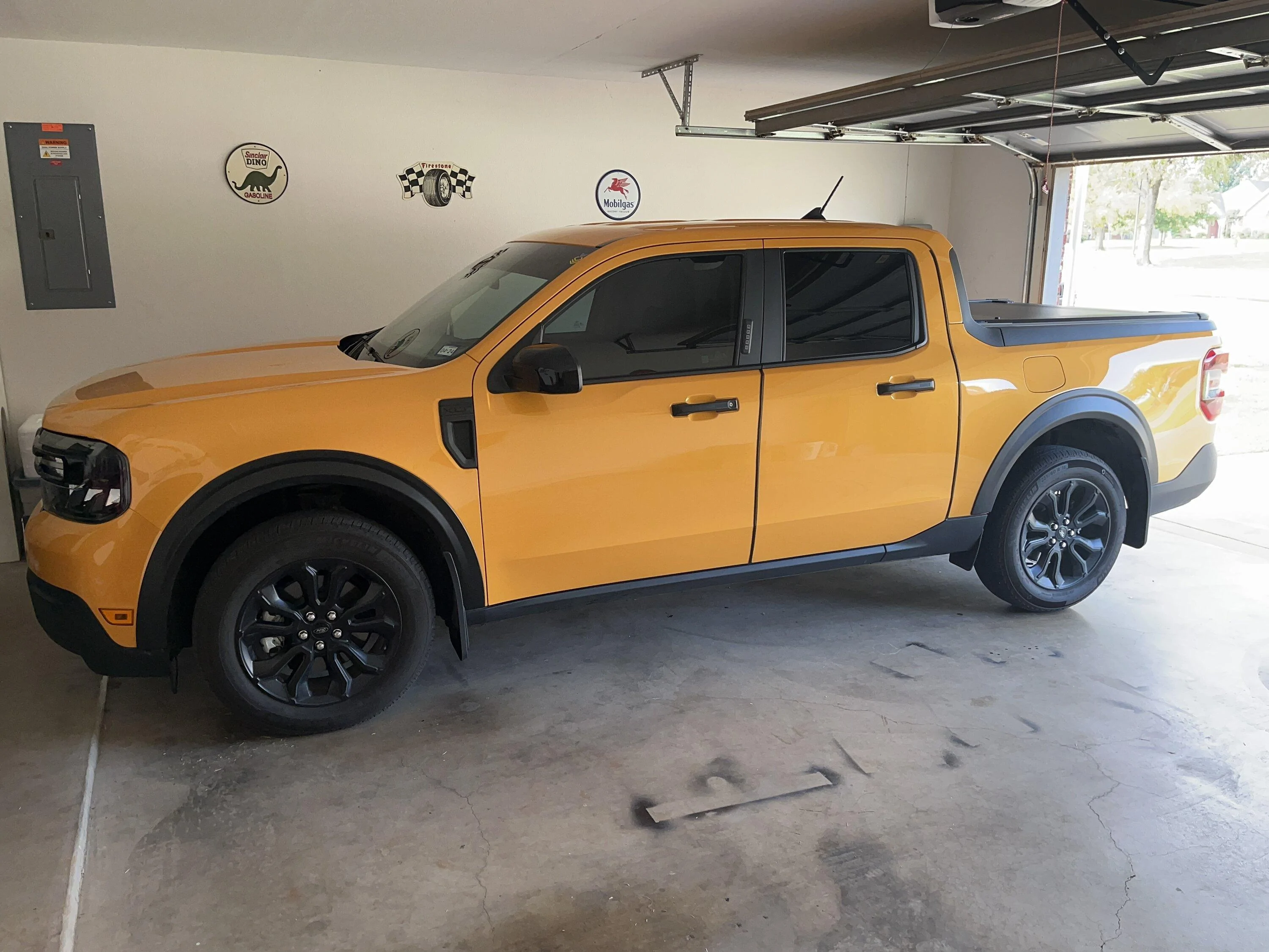

I sanded down the top edge of the flairs to avoid any sharp contact with the paint. I got the factory dye seam sanded smooth. My tape would not hold in 2 spots so I used clear silicone and now they stick great. My tabs did not line up correctly on the front 2 fenders. Had to drill new holes on 2 of the 5 tabs on each front fender. I hope you have better luck than I did. 🤟

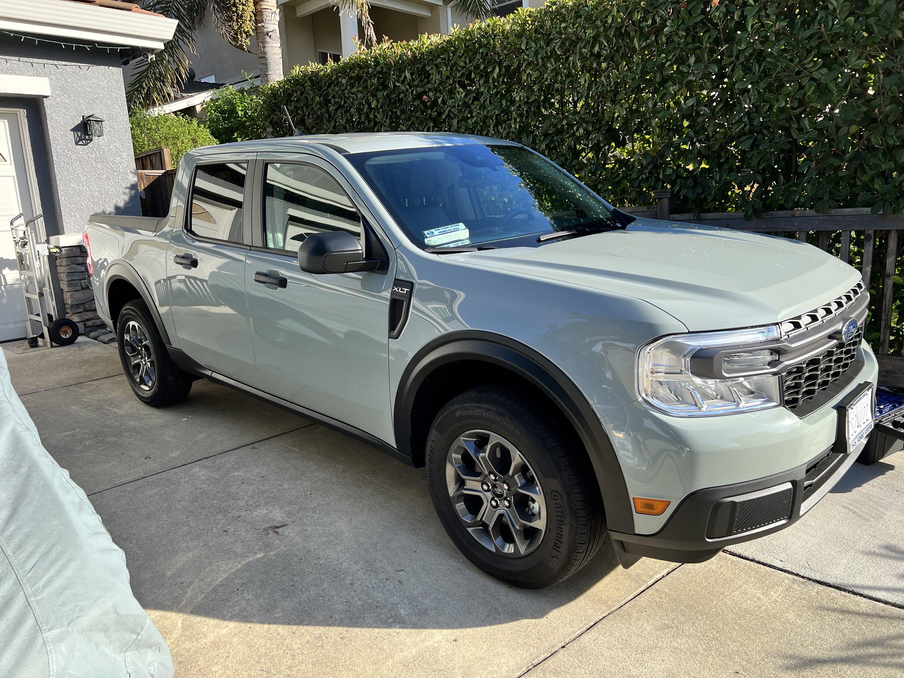

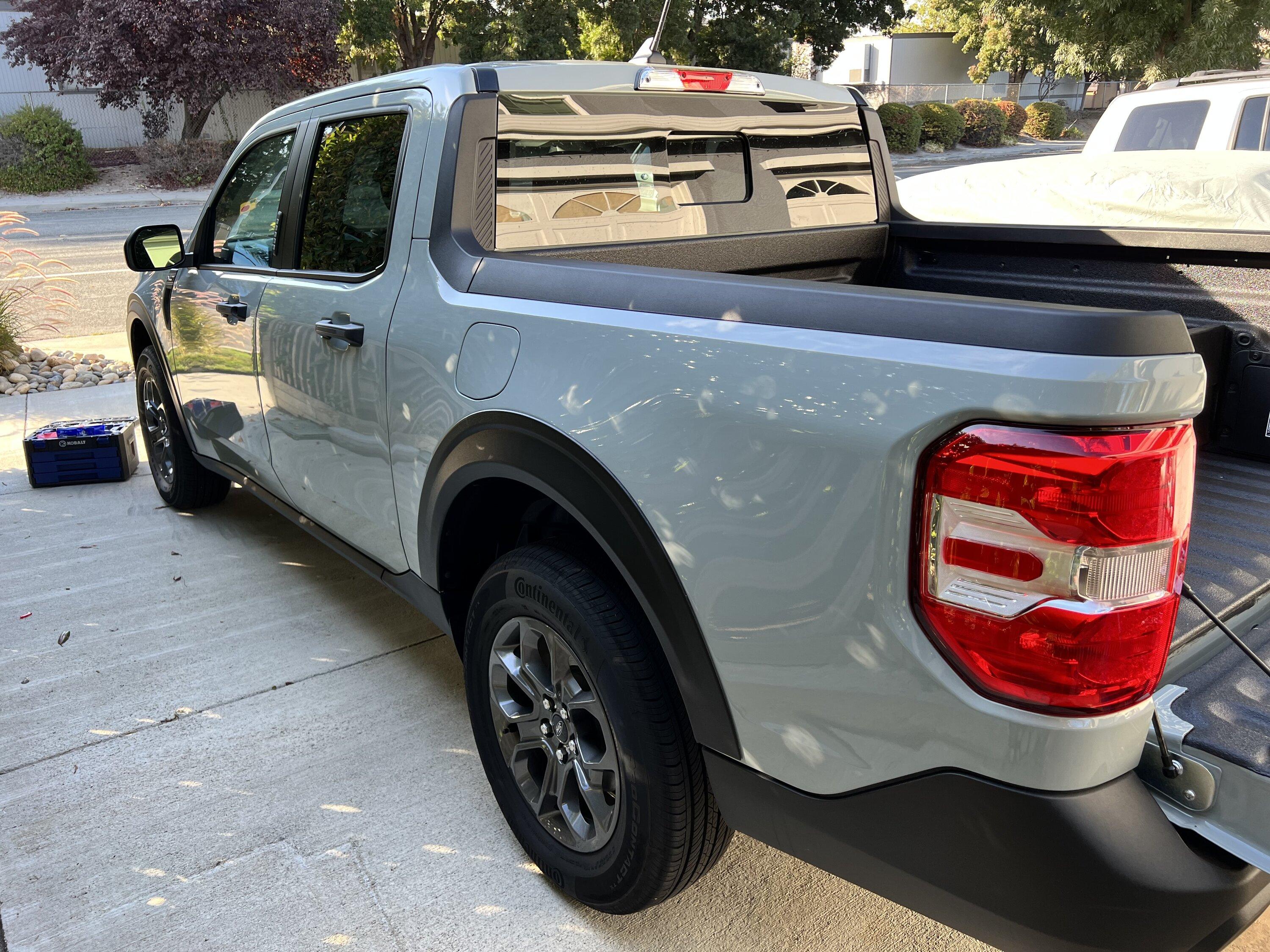

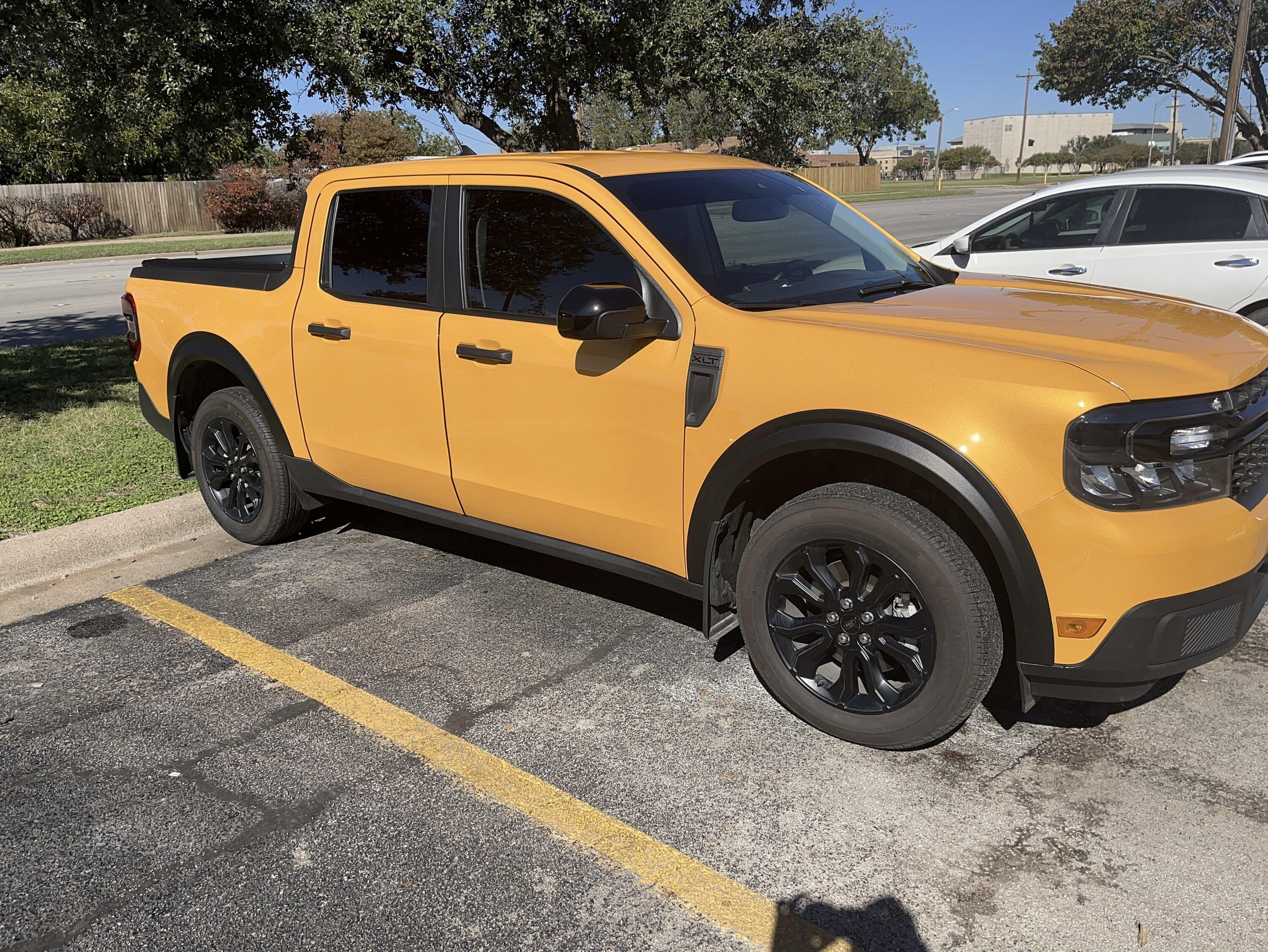

Installed mine. For $100, they are great. Only issue is the rear ones leave a gap and the paint shows under them. The front ones fit better, covered up the paint completely. I added some Xpel paint protection strips where they touch the paint. The sticky tape that came with them did a great job, no gaps where they attach. They went on easy, took me about an hour, because I added the extra PPF. Would have taken like 30 minutes otherwise. Overall 4.5/5.
