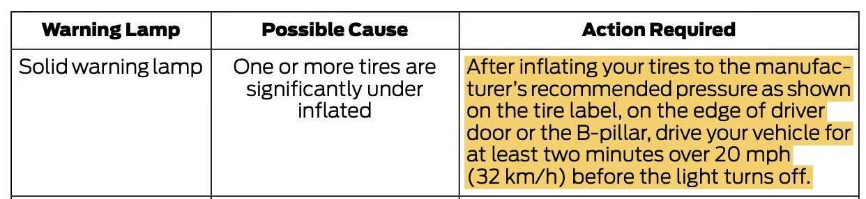

After a stint of cold* weather my low tire indicator came on. Check one of the rear tires was 27. The others were 28 but the 27 had the indicator on it. Filled the tire back to 31 lbs. and the light stayed on. It stayed on for about four days and then it reset just today. Not sure of the why on this. Any ideas.

Cold is in am before driving after sitting 10 hours of so at ambient temp. These are small lightweight tires which contain less air than most tires. They can gain/lose about 1.2 lb of pressure for every 10-11 degrees of change in ambient temp. Road heat after 75 mph 6-8 miles can add ,3-4 lbs depending on ambient temp. Bottom line = make pressure adjustment if you have to add air during driving. If you air tire to 35 warm it's most likely going to be 31-32 in am.

Your door jam lists the recommended tire pressure. 31 is too low which is likely why your light stayed on.

....Filled the tire back to 31 lbs. and the light stayed on...
There's a sticker on the driver's B-pillar with tire pressure specifications you should use for your truck.
Probably 35 lb per square inch.
