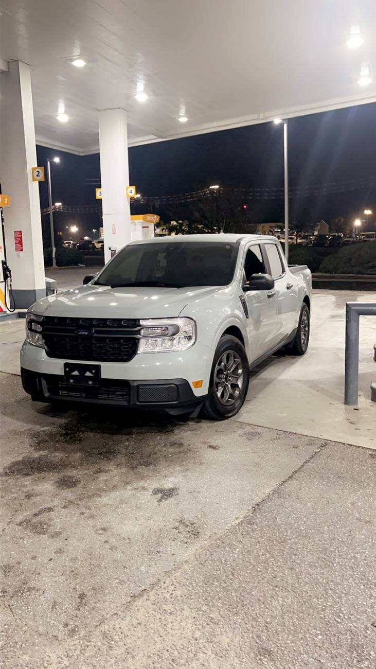

So I put the Eibach Pro Kit spring drop on my Mav this past Friday. Love the way it sits now, and I actually like the stock XLT 17” rims. That being said I would like to have a bit taller/wider tire to fill in the little bit of gap. Anyone know a good tire size to achieve this? Or have any recommendations? Info and pics are appreciated!

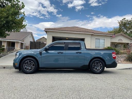

Ford Maverick Lowered XLT Tire Size Question! 1731336509345-u1
I'm using Atturo Trail Blade X/T All-Terrain Tire 235/65R17 on my Stock 17 inch wheel. My 2023 Maverick XLT Hybrid is also Eibach dropped No rubbing.
