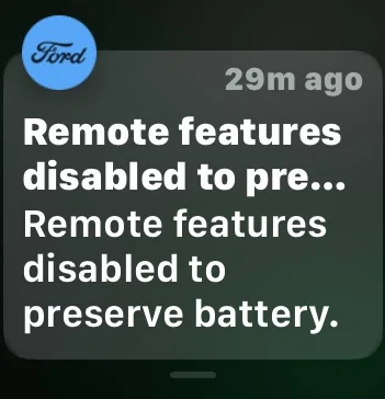

Yesterday I received this Apple Watch notification. My 22' Lariat is an ICE, with only 9k miles. I drive about 5-8 miles a day, give or take depending.

I started getting them sporadically over the last week or two, also. Ecoboost and no prior battery issues since I reset the BMS... hmm, probably around Nov-Dec '22.
I think there's a chance it could be FordPass issues, but if I were you, definitely reset the Battery Monitoring System. It's extremely easy, takes 30 seconds or less.

Resetting the Battery Sensor
When you install a new battery, reset the battery sensor by doing the following:
  1. Switch the ignition on, and leave the engine off.
Note: Complete Steps 2 and 3 within 10 seconds.
2. Flash the high beam headlamps five times, ending with the high beams off.
3. Press and release the brake pedal three times.
The battery warning lamp flashes three times to confirm that the reset is successful.

Welcome to the club who experience battery issues. After 2 years of this nonsense, I replaced my battery with an Interstate AGM battery, reset the BMS and changed the charge level from 80% to 95% with ForScan. So far, no more battery issues (knock on wood) for the past 3 months.

Remote features have a constant small drain on the battery. They are turned off when the battery is down to, I think, 12 volts. This happens when an ICE Maverick is driven sporadically and on short trips. The battery does not have a chance to fully recover.
We mostly use our Mach-e. So the Maverick just sits in the garage waiting for short trips to Home Depot, etc. Our battery needs an external charge every 6 to 8 weeks (in moderate CA weather)
