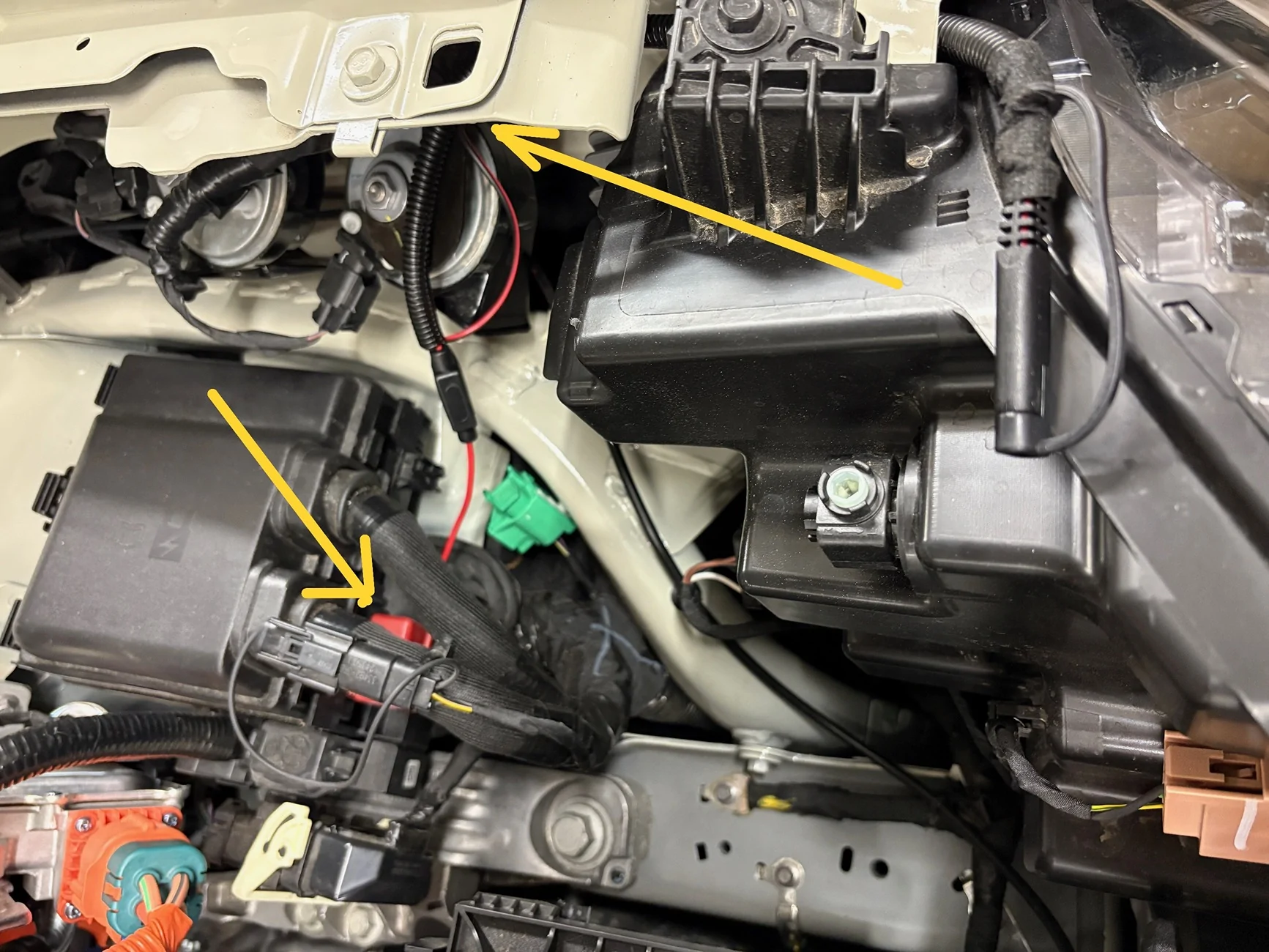

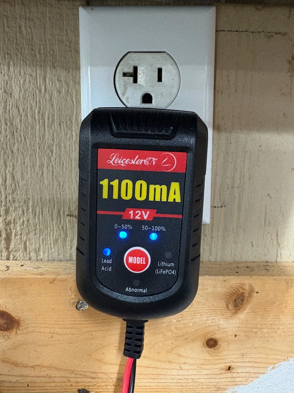

I've had very good luck with these low cost battery trickle chargers from Amazon (have had 4 of them on cars and tractors for years). We're only driving the Mav about once a week on average right now, and sometimes it would go into a soft battery saver mode (no alarm or alert, just no dome lights when you open the truck... would start right up but damn annoying!). Trickle charger time!
The trickle charger comes with the 2-conductor quick connects including the built-in fuse holder. Sweet! I just wanted a convenient place to connect it all up and make it easy to use, and I didn't want to have to keep the hood up or have any possible current drain when in use.

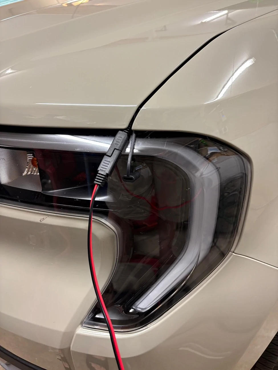

I decided the large jumper cable tap under the hood was perfect to connect to the +12v trickle line, and for a ground, I just used one of the screws holding down the horn bracket. There's just enough cable to position the quick connect at the gap of the hood. With this arrangement I just pop the hood, pull the connecter out an inch or so, then close the hood completely. Then I plug it in. Disconnecting it is even easier... I just unplug the quick-connect, slip on the prong cover, and push it into the gap where it's sight-unseen.
So far, so good. It's been weeks and no more safe-sleep mode.
