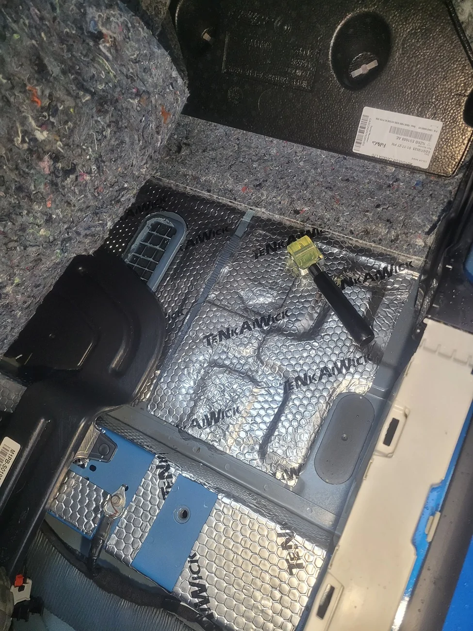

As I mentioned before, phone app dB meters can lead you astray...Now that I have this sorted out I put a thin piece of mass loaded vinyl in the back cavity of the rear seat. Noticeable difference to my ear and a dB meter showed a 3 or 4 dB reduction. Also, my local tire shop said once the tires break in they will be less noisy. He was right. On my local pavement, the db meter says 67 dB. I think I'll try insulating the rear fender wells next. After that, a search for another 50 HP. Liking my Lobo more all the time.

Sorry about the slow reply and lack of posting skill. I am really old…Yes, some of the 300T potential could be what I’m looking for. Picture attached for person asking about rear seat insulation.

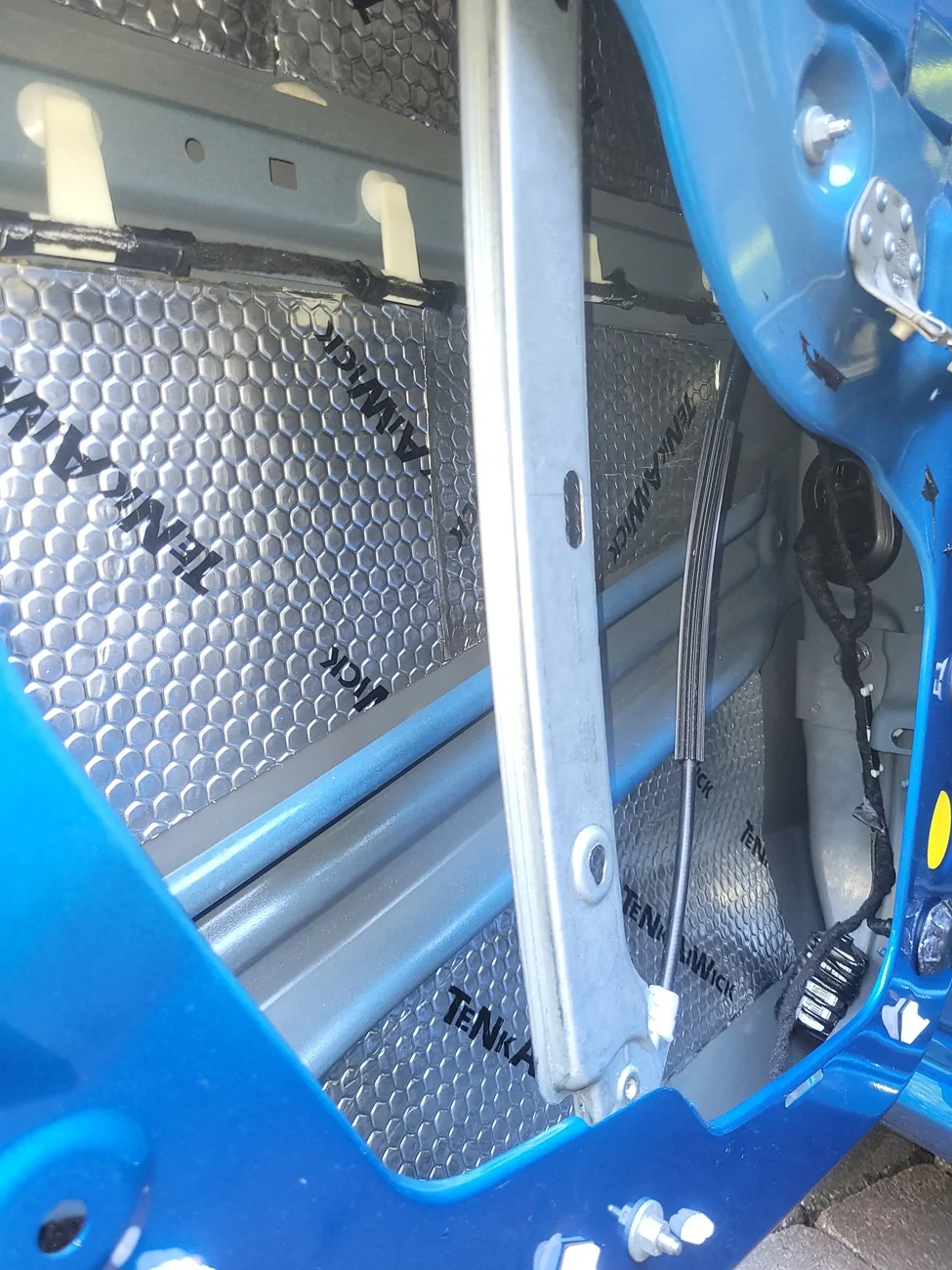

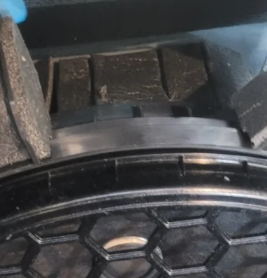

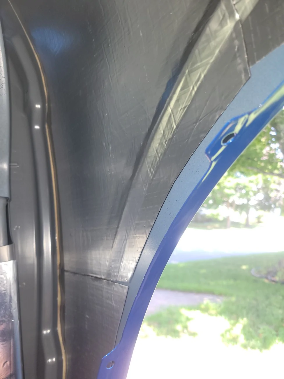

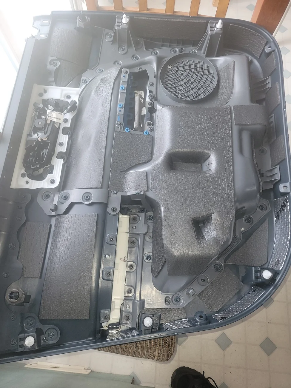

My Lobo seemed quite loud at highway speeds as well
I have applied sound deadener in the fenders, doors, under the carpet, the roof and under the back seat.
I also applied 4mm foam over the aluminum butyl deadener under the back seat, the rear wall of the cab and roof.
Plus I foamed the door panels.
The doors close with thud.
At idle I am reading 48db and on a 20km ride which includes 50% stop and go, 50% highway I am averaging 67db with a peak of 72db.
The truck is limousine quite.
The exhaust tone is still there went I push it because it is ducted into the cab via the sub woofer.

Is not the fake engine sound from the speakers?
F100Lobo
Sep 2, 2025
132
328
Montreal
1977 F100, 2013 Focus, 2025 Maverick Lobo
No, the sub woofer is ducted outside above the gas tank.
Blocking the duct doesn't work, you'll lose the sub woofer effect.
I tried 😏
