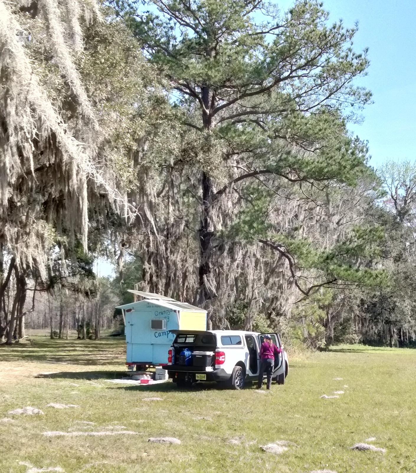

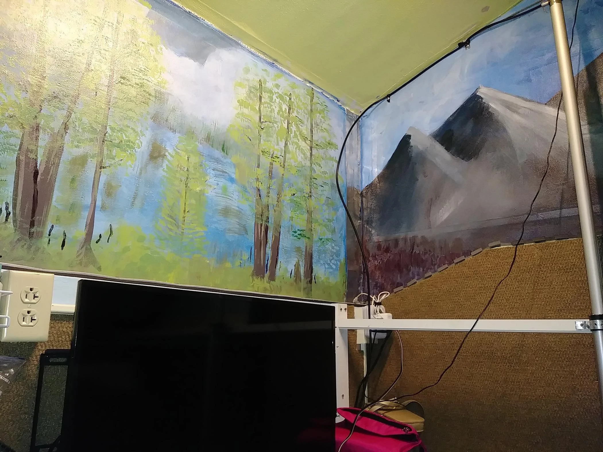

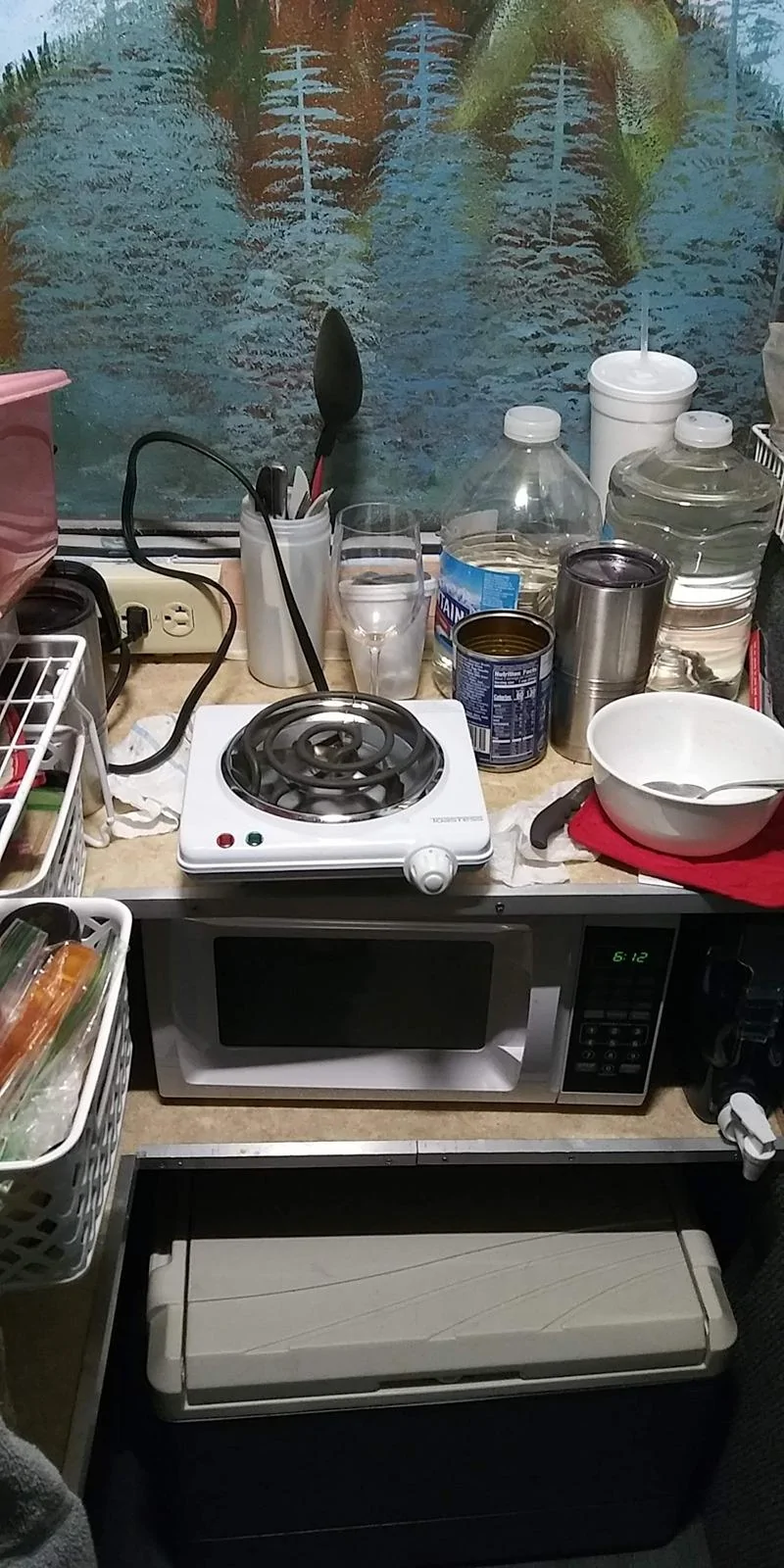

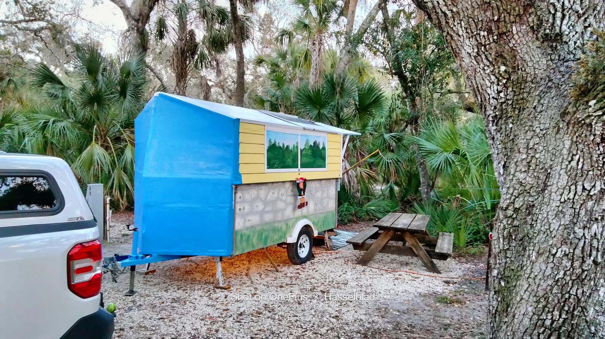

Started my rig from scratch, seven years ago to be pulled with the PriusV. I've added 800 watts of solar to the roof with a 2KW power bank, estimated weight is 1300 lbs, we have two beds, top flips up to allow seating on bottom bunk, have Bluetooth stereo, 32 inch TV with sound bar, galley has microwave, cube refer, and either a hot plate or a gas stove and air conditioner, we've been able to get by without heat down to 35 degrees due to R-7.5 insulation, two hot bodies, refrigerator heat and power supply when off grid camping. Estimated cost $4200, considering some maintenance and adding boondocking abilities the original price to build was $2800. We've been using it for the past five years.

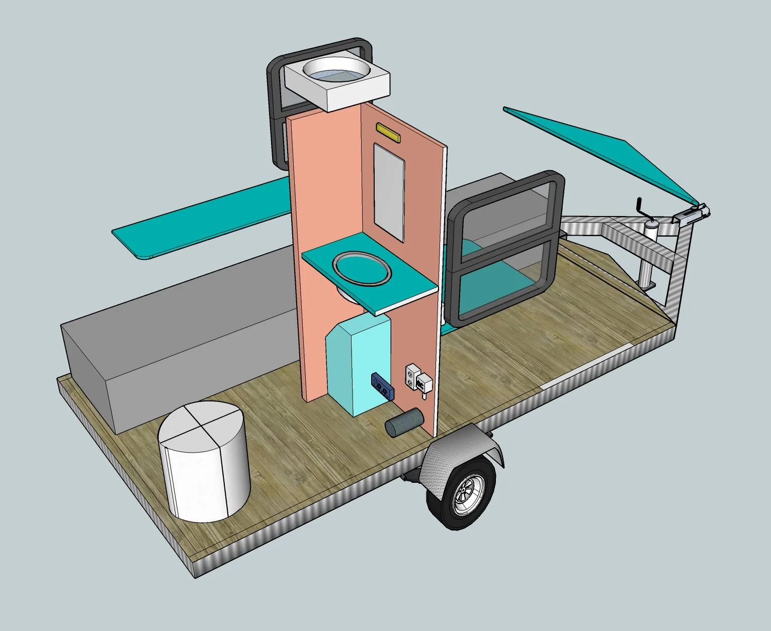

The trailer new from https://legendmfginc.com/thunder-v-nose/ . The odd size takes in the V-nose. They come mostly with ramp doors but I wanted the cargo for walk in. In future switching the rear doors so I can install a trailer door latch and use as exit. Yes it is fully insulated. I had to remove all the wood side panels to install support frames for the RV windows for after cutting window areas. Bought all the conversions parts right from Amazon. The center hub I call it has all the electrical and plumbing located under the sink area including a in room stand up AC unit. I did not buy the combined AC/Heat unit since I already had the ceramic heater.
IF designing to carry motorcycle in trailer it would be best to do some of the following work for proper payload and tongue weight.
NOTE: A very important point to make here, not only is gross vehicle weight a factor but also the tongue weight which can not exceed 200 lbs. I spent about 3 weeks calculating the weight of every item to be install from wood paneling, fan, sink, electric converter water pump and tanks, etc. I used a couple different website online to calculate the tongue weight by placing each piece from center of axle front or rear. The tongue weight on my trailer is 10% of my gross weight and I try to keep it that way when packing by carrying a cheap bathroom scale with me.
I used a easy to use 3D CAD program called Sketchup to make all my layout changes prior to build. At the end of project which took about 30 days, I was 95% on target from my calculations. I have enough spare to carry two electric bikes inside the trailer. With the concept I had I have the capability to shift center of gravity to meet my Maverick specs.

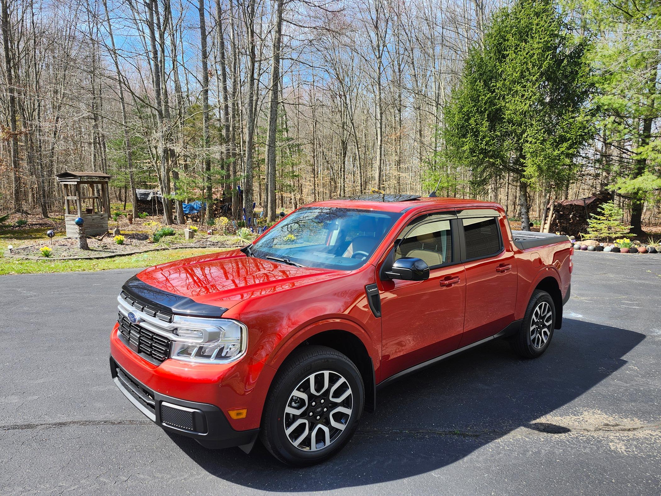

I have a 2023 Maverick Lariat loaded. I have a love/hate relationship with it. Things that annoy me are the random double honk exiting the truck, having to hit the OK button multiple times, the driver assist always telling me to put my hands on the steering wheel when driving on a straight road, collision alert flashing when another vehicle in front of me a 1000 ft away makes a right turn, the 12Volt battery going into sleep mode if parked a few days especially in cold weather (the battery is only charged to 12.5volts) Recall coming for this from the latest news this week. But hey I love the truck and glad I got it after waiting 480 days! Good color choice, it likes to change colors in different light.
