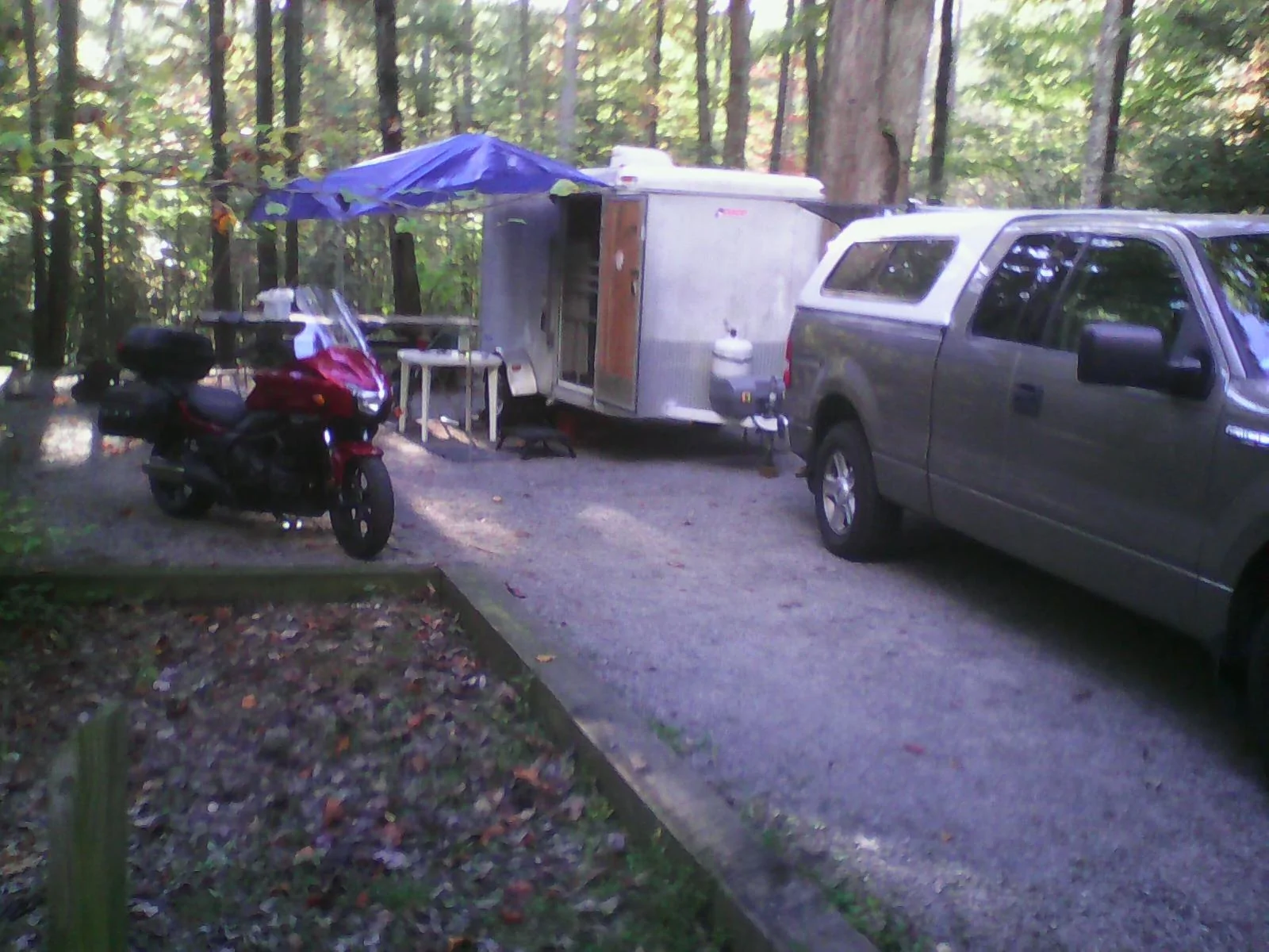

did this about 10 years ago with my f150 . I used a 6x10 enclosed trailer with ramp door for hauling mc . mc out have queen size type Murphy bed that folds down. Had propane tank mounted on front plus 6x10 tarp on side . Used lawn chairs and fold up table for rainy days with bed folded up . Had camp portapotty for night . Wired for 120 and 12 volt . sliding/roller screen door for side door to keep bugs out . Had Rubbermaid cabinet with storage and two wash basins inside front of trailer for meal prep and clean up . Floor was carpeted with indoor/outdoor carpet . Most items used already had or yardsale bought . Basic camping but worked for us . Trailer 1 k and mc 500 lbs . Haven't used with Maverick but would work with any model especially if not hauling mc .
