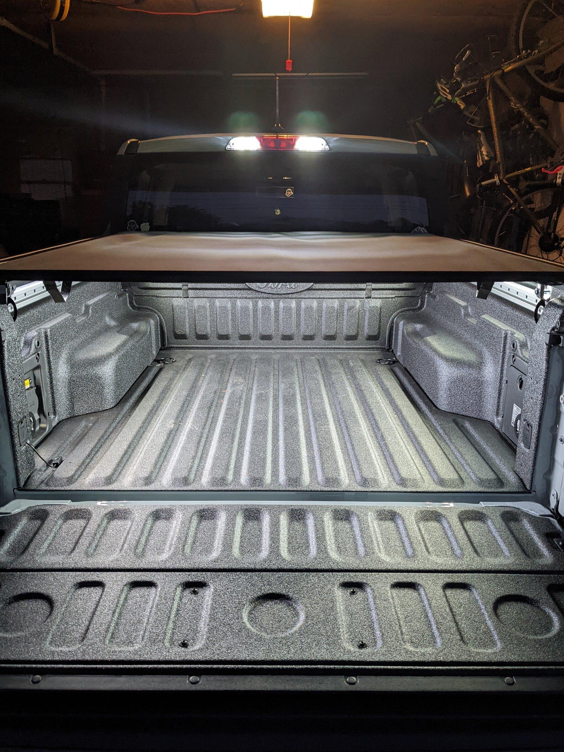

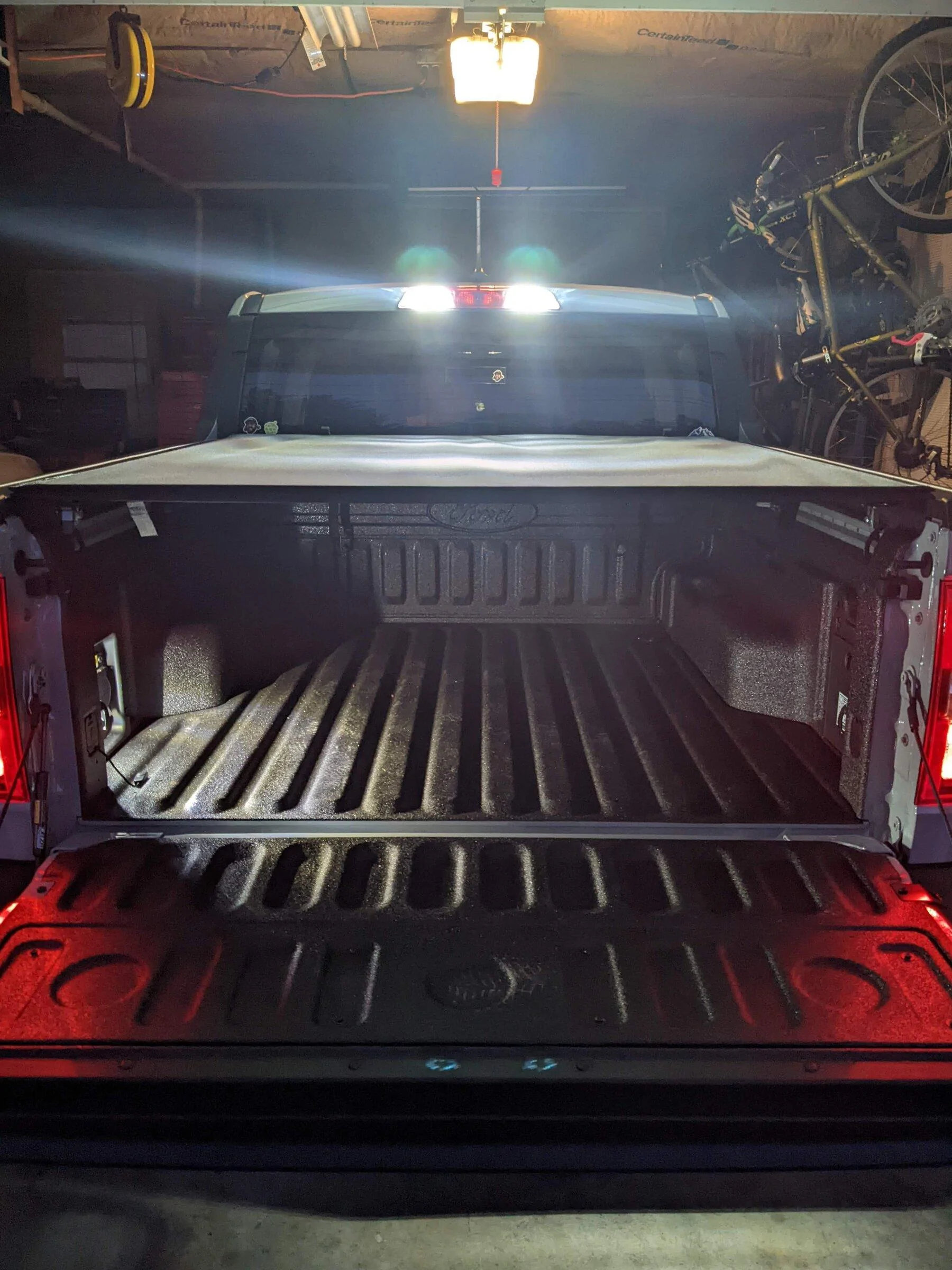

I've got the OEM box lighting. It is OK at lighting the box in conjunction with the overhead cab lights. I recommend upgrading the overhead cab lights to LED as that made a significant improvement alone.
I added LED strip lights along both sides of the bed and the comparison is night/day. See below:

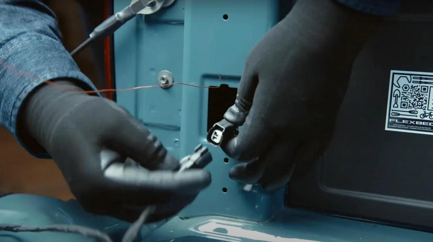

On each side of the bed is a little plastic cover... That pops off and leaves you with a factory plastic harness. When you bought your truck, it will (should) come with (1) opposite pigtail that gives you two bare wires to splice in with your accessory of choice. Those 12v pre-wired circuits exist to "hack" your bed with some DIY projects. Video here: Hack Your Maverick: Electrical
