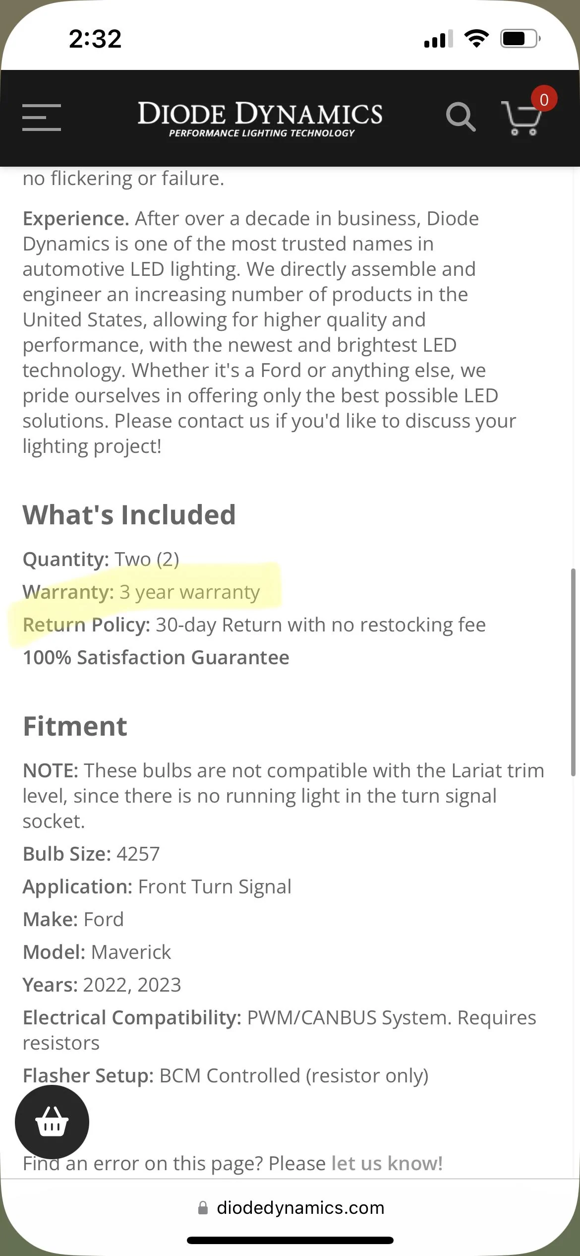

Ford Maverick Lasfit vs Diode Dyanamics IMG_3365
Going to chime in here with my EE background
I have to say with a 3 year warranty on the DD bulbs, pretty sure we know which ones are built better. I’m guessing LASFIT doesn’t do as much longevity testing and that’s why they aren’t making it past 1 year. The DD also have an (optional) external resistor which will be better for heat dissipation. LASFIT is probably constrained as to what size resistor they can fit inside the tiny bulb housing. Aka both might have the same resistance but the LF resistors might only be .3 W and DD might be 1W (for example, I don’t own either of these products but also going to buy some new bulbs once my truck comes in). Higher wattage resistors withstand heat better (and are larger in footprint/size) and I assume that’s why the LASFIT bulbs overheat quickly (on top of being in an enclosed housing with other heat generating devices: LEDs)
DD $90 with hyper flash resistors 3yr warranty
LASFIT $50 ā€œbuilt inā€ resistor 1yr warranty
If your LASFIT bulbs burn out once within 3 years you are already saving money going with DD.

While the resistors could lower bulb operating temperature due to lower current going through them.....
The resistors are not there to make the bulb happy. They are there to fool the Ford CanBus ( or whatever they call this generation) into thinking there is the right current going THROUGH the bulb to prove it is on and operating. If that current is out of range, it will shut down that circuit.
That is where a LOT of these LED replacement bulbs are a pain to get figured out.

Eh not sure. Was trying to take a guess at why people are having LF bulbs die after the 1 year warranty and why DD bulbs are more expensive.

That is correct. I don’t know how much current a typical halogen bulb draws, or what the threshold for the current monitor is. But what I do know is if a large enough current is sinking across a resistor placed in front of the LED to trick the truck but the resistor is too low wattage, it could change the resistor’s properties and cause problems.
It’s pretty simple for someone to take the stock bulb out of the truck and measure the resistance and then slap the same ohm resistor onto an LED bulb. But if someone doesn’t take the time to figure out how many watts of heat the resistor will need to dissipate…
I’ve never tried designing an LED replacement bulb but halogens get pretty hot. Whether the truck is expecting the same current draw from an LED or the cutoff is some marginal current above zero, I do not know
