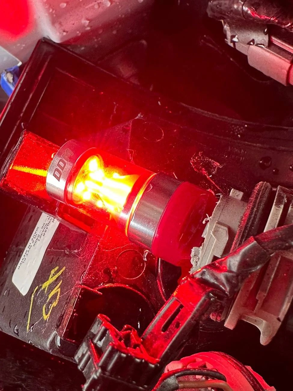

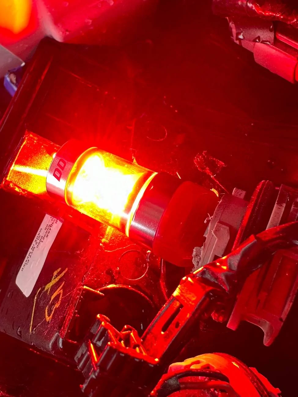

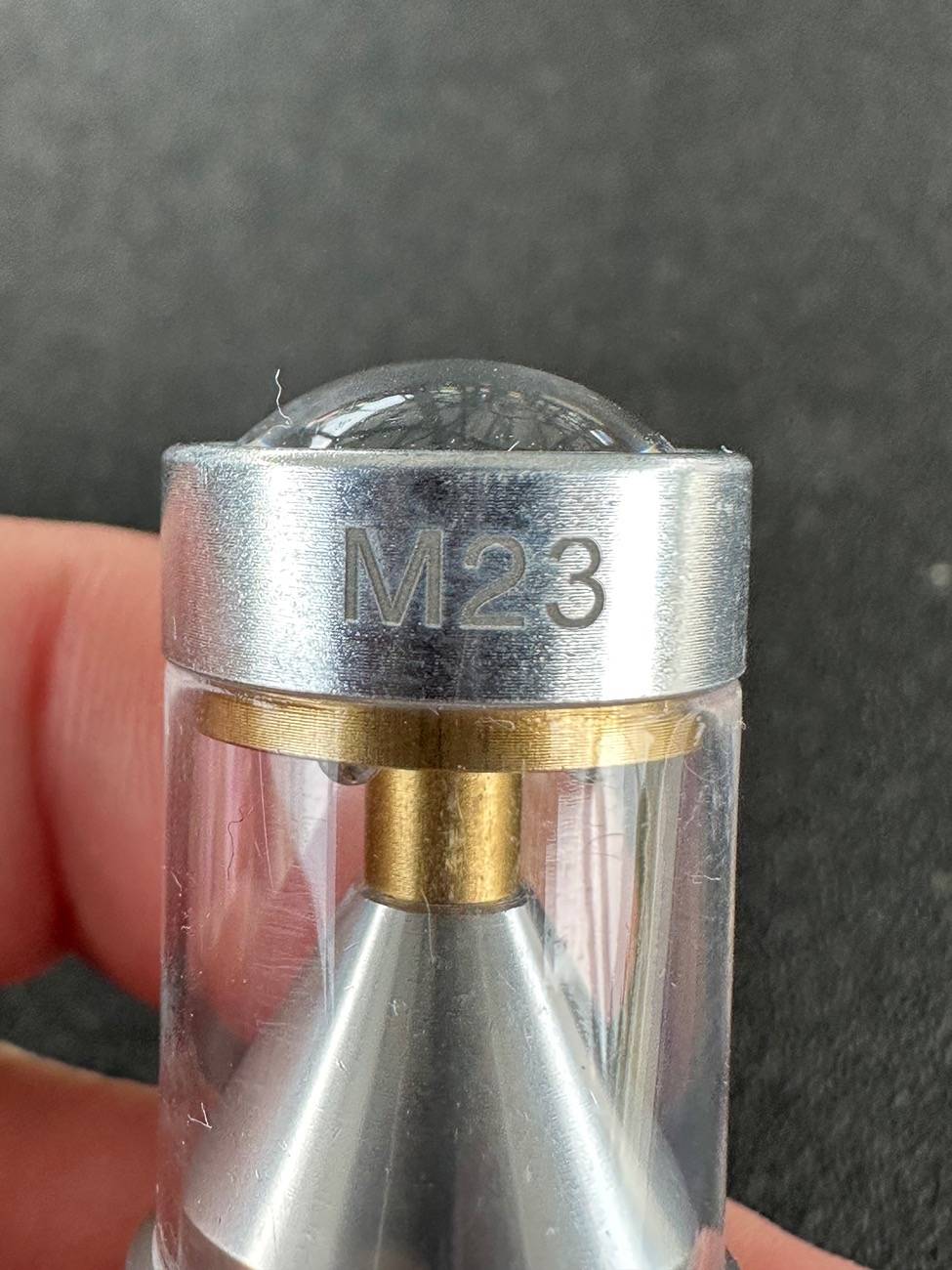

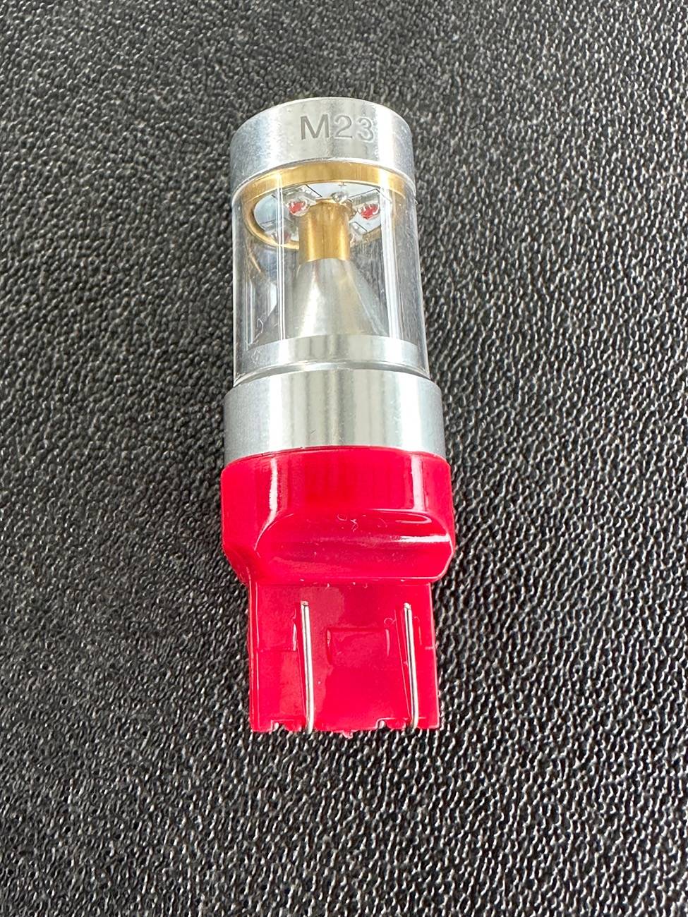

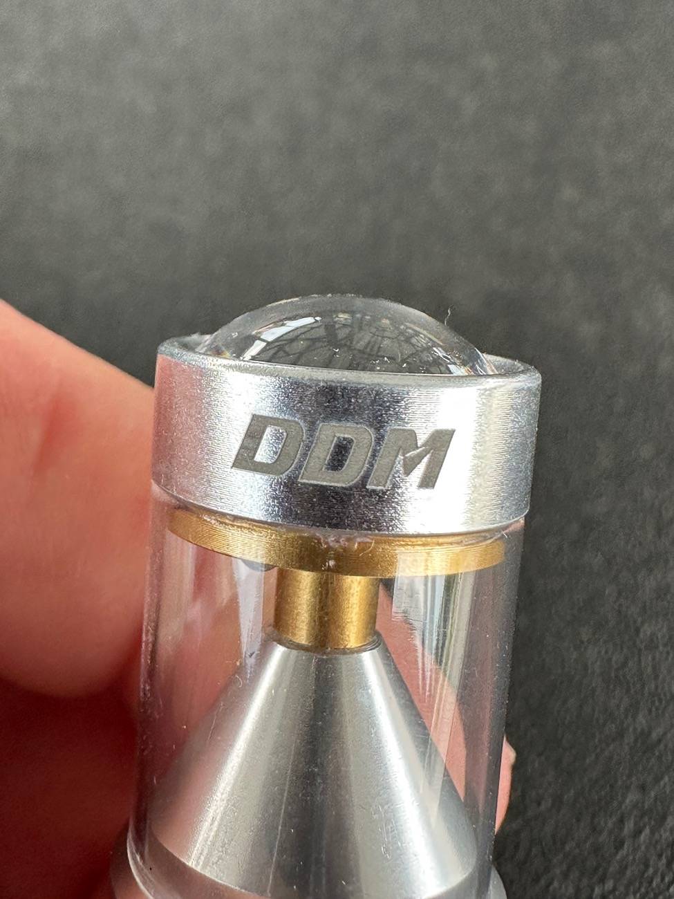

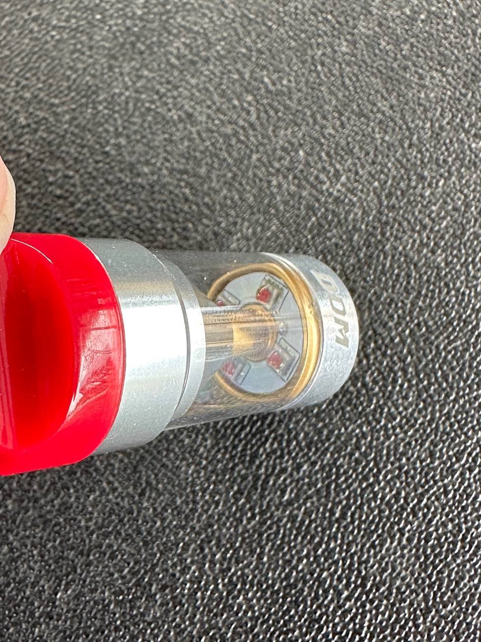

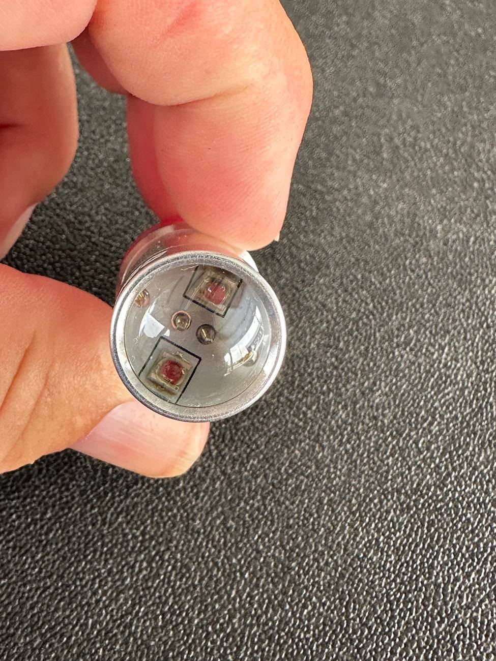

I’m using these DDM LAMPS Got them on Amazon .they have 6 CREE LED in each, also only $33 per pair. I’m still waiting on the recall as my truck is still in the shop waiting on a wire harness. Part is expected to ship in November .(4 months for a repair)
