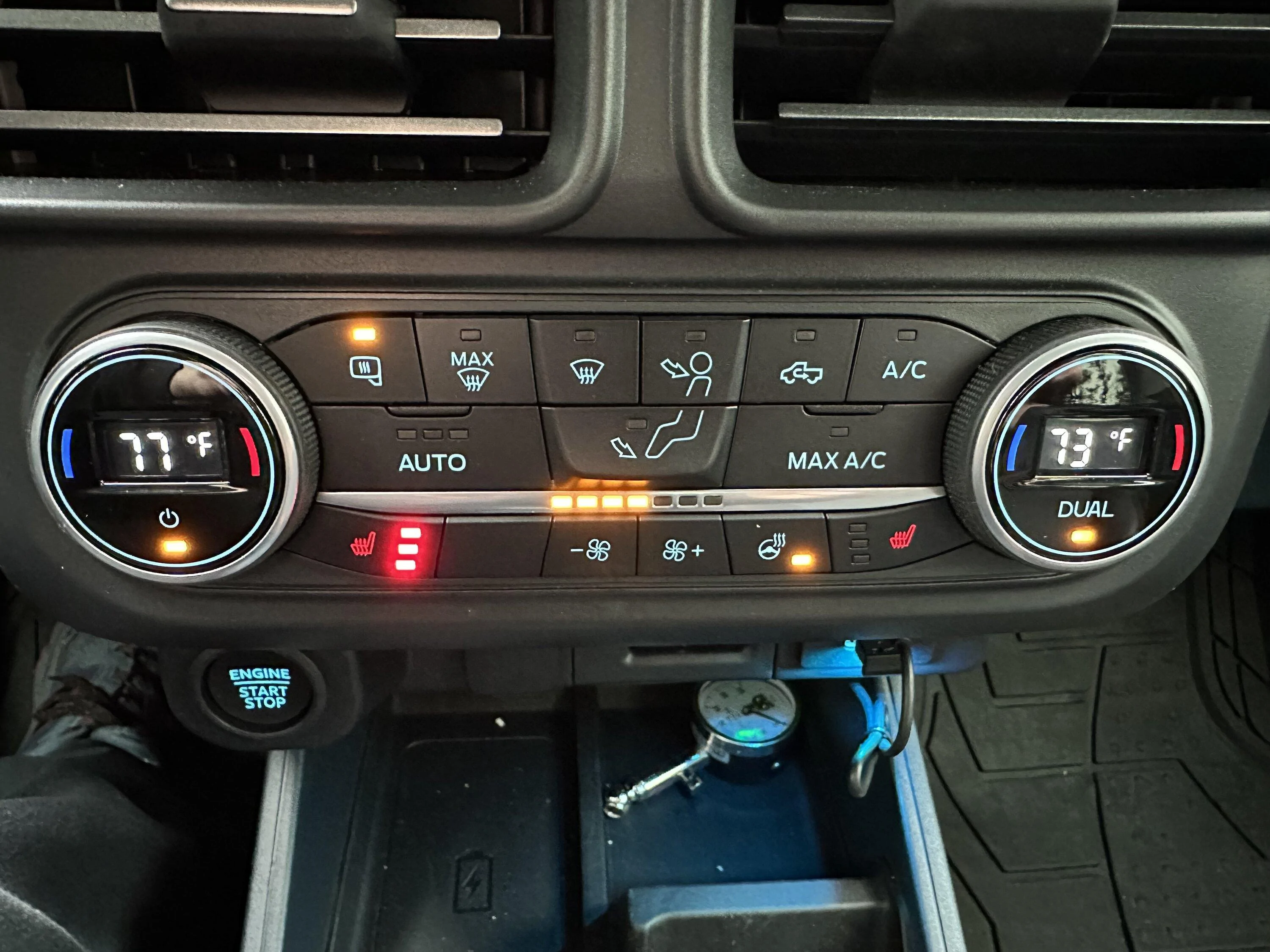

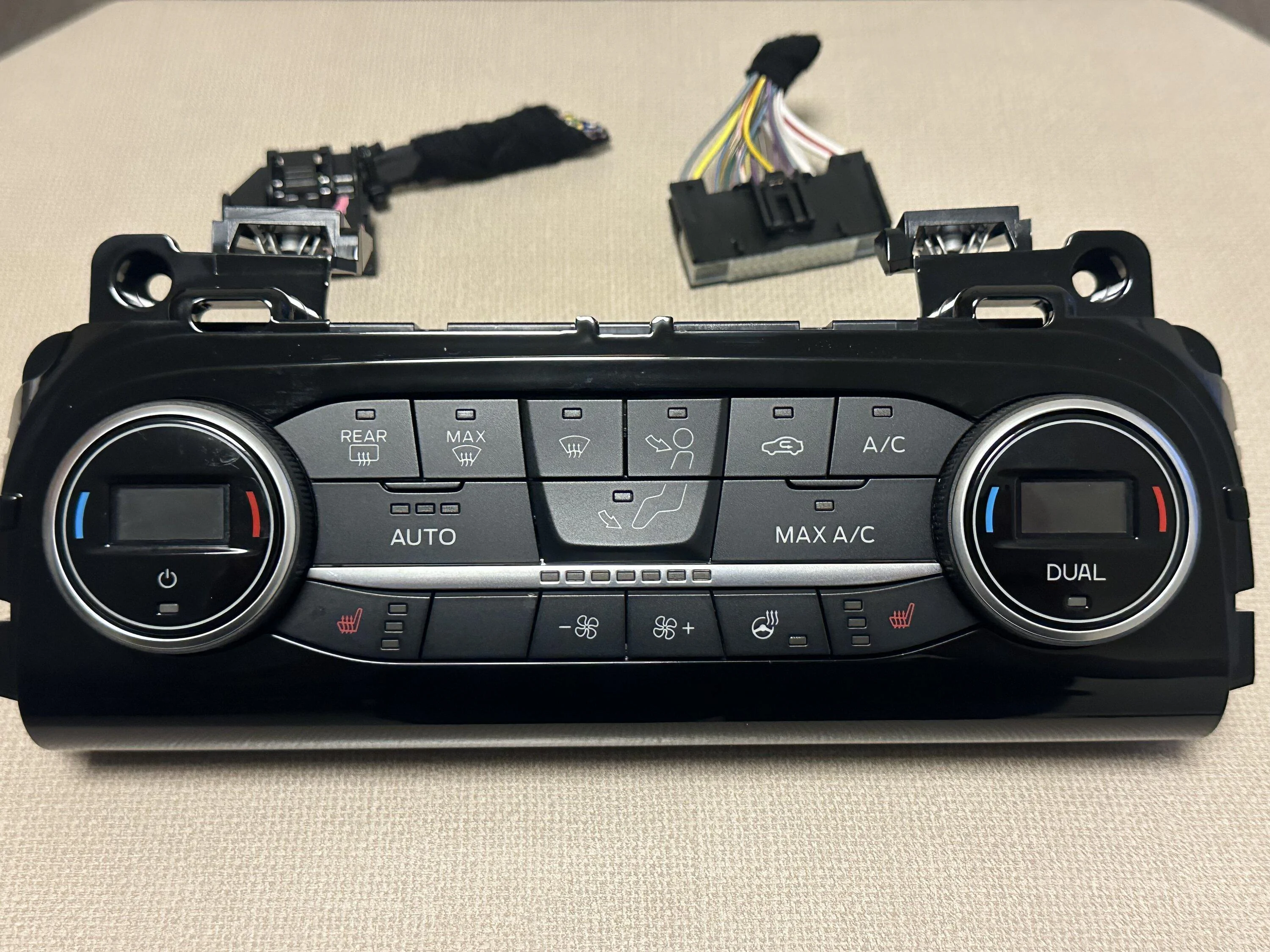

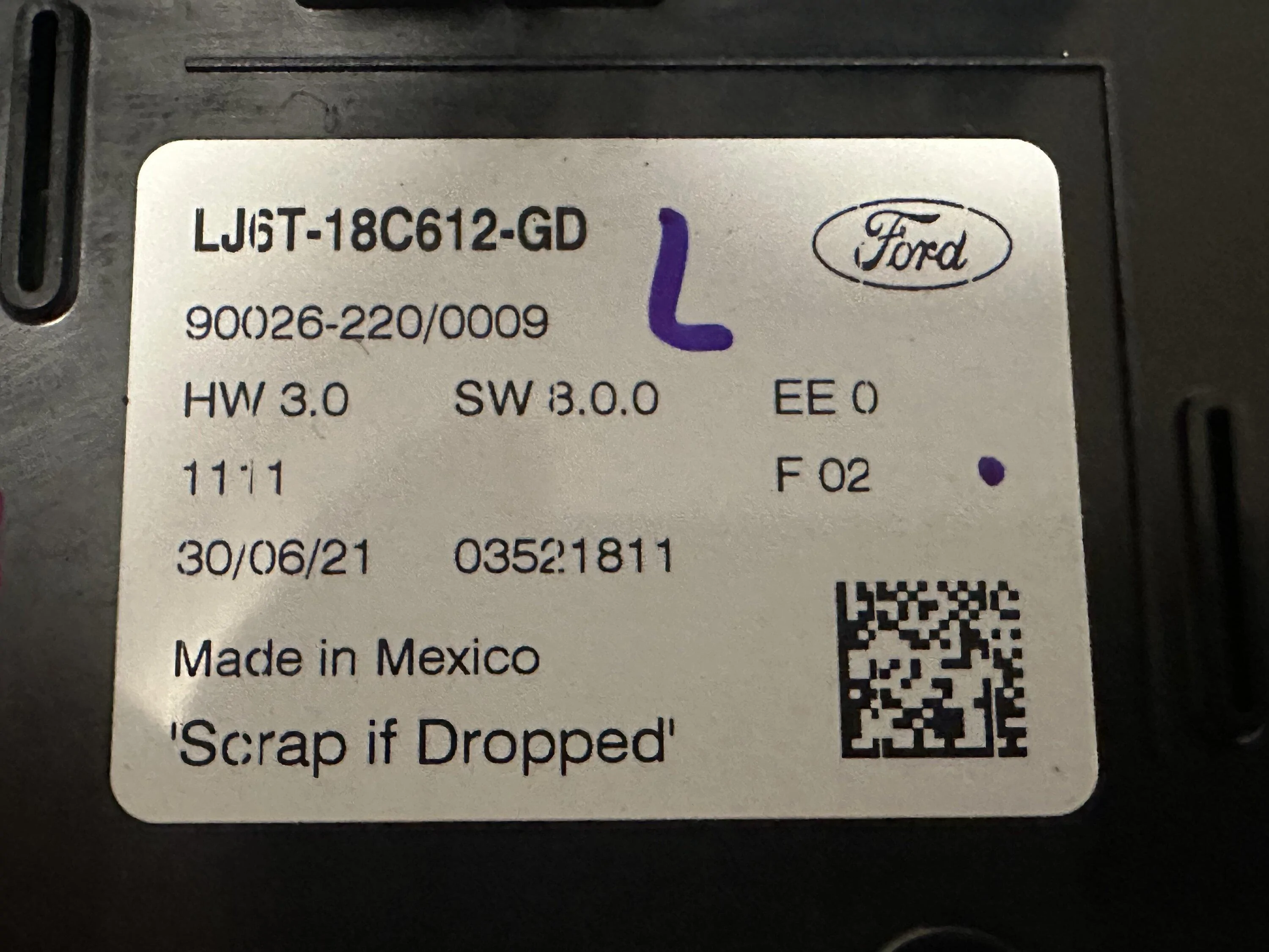

Here is the Dual Zone Control I just installed today. From a 21 escape. Part #LJ6T-18C612-GD
Nice job, Fortunately I bought an early Maverick 12/15/2021 and it already has the digital readout on the knobs.
LJ6T-18C612-GD
Nice, did you have to use Forscan to swap this in? Before I tried it I hadn't seen anyone else mention this specific part number and it was needed. This was what got me to end up breaking the seal with Forscan :)

That number is for hybrid with heat seat and wheel correct? I think I’m gonna do this in mine.
I believe that is a EB with heated seats and no heated steering wheel.

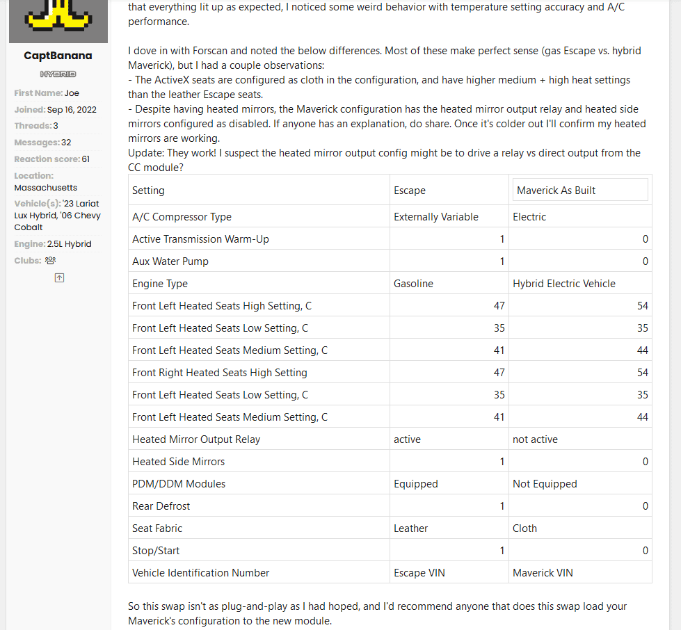

Very nice, I've been going down the rabbit hole of this topic, and I got a dual zone part # LJ6T-18C612-GB
But the vin number they provided doesn't seem to match the GB module. They seem to be advertising LJ6T-18C612-GD. My part says it was fab'd in mexico, so im not sure why this LJ6T-18C612-GB part number is so hard to find, and where I do find it is in the foreign market (russian). Anyways, I believe I can use the part with the FORScan magics.
But I am also struggling with some terminology about how to complete the update with FORScan.
His solution was to update the module with the modules original configuration.
Ford Maverick Lariat Dual-Zone Climate Control Swap 1706647882562
@CaptBanana
I see you've done a lot of research, and if you can I like to ask for your help with something.
Ford Maverick Lariat Dual-Zone Climate Control Swap 1706648413014
The last sentence on the bottom of the picture says you recommend to load *your* config, So I am assuming you mean when I connect FORScan, (after the psychical module change has taken place?) or before I remove the no digital display module? Do the modules themselves hold the instructions? which would mean all modules have firmware, like a bios of a PC?

Basically once you connect FORScan you will go into the module and then click on "Save" for the AS-BUILT data. Then after you have swapped out the original HVAC module for the replacement, you will go back into FORScan and "Load" the original module date onto the replacement module.

Ah okay thank you. This clears things up. we want the the current module to give the same instructions to the newly installed one.
But, Redneck Garage on his video says
Looks like he says its the opposite. This gives me confusion

Hey all. I joined the digital dual HVAC club today. Ordered a used Escape panel and fit it in beautifully. The buttons are all correct with mirror heat and truck icon for the recirculate. I truly enjoy the digital readout on the knobs. Tested all functions perfectly including heated seats, steering wheel heater and manual fan settings. I love it.
