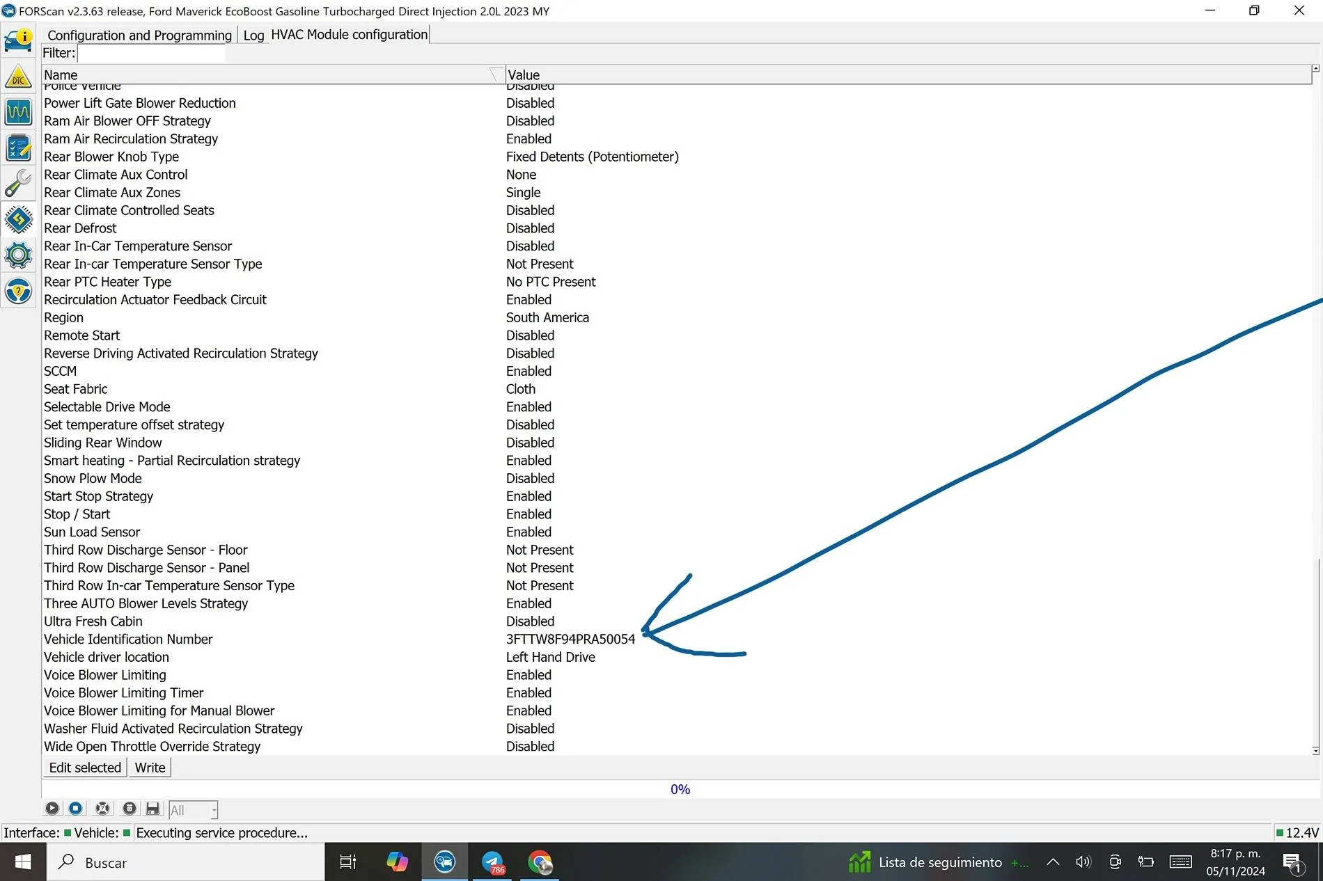

pantera156
Pantera
Feb 25, 2024
86
Porto Alegre
lariat 2.0
I bought it at a scrapyard in Spain, from a FOCUS 4. But, it didn't work well until I changed this number for the original one.
