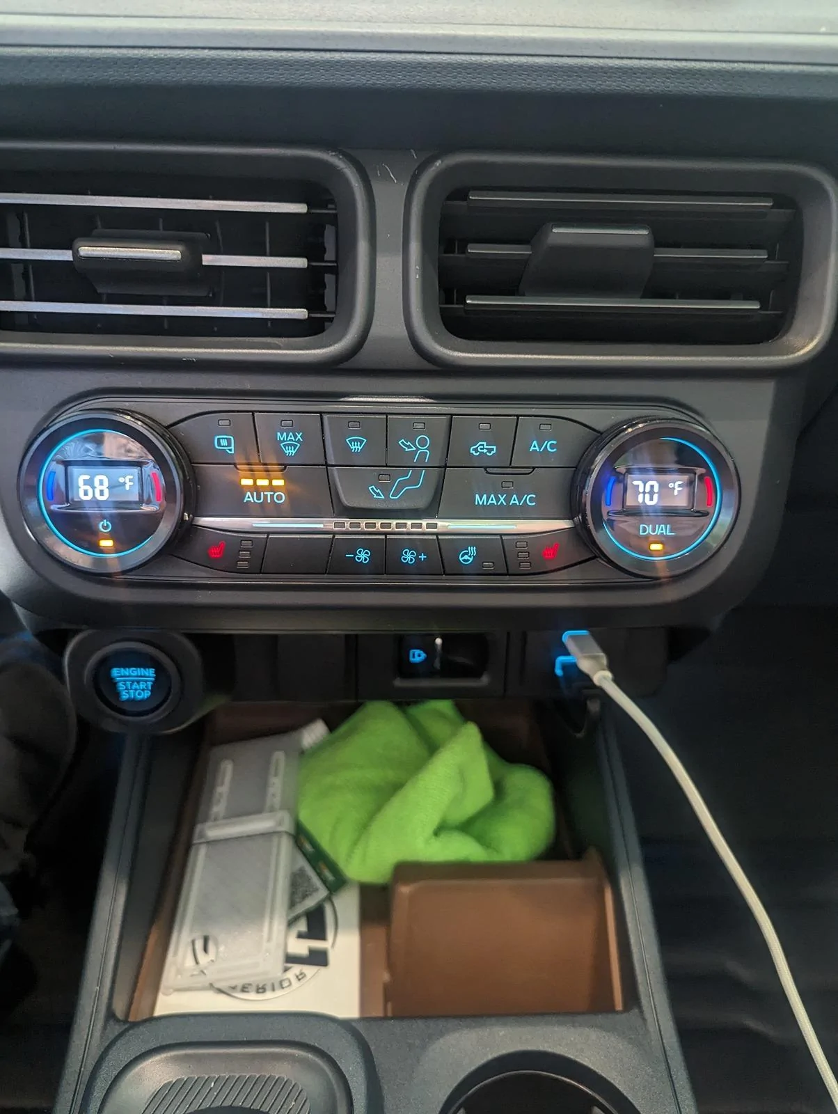

Hey all. I joined the digital dual HVAC club today. Ordered a used Escape panel and fit it in beautifully. The buttons are all correct with mirror heat and truck icon for the recirculate. I truly enjoy the digital readout on the knobs. Tested all functions perfectly including heated seats, steering wheel heater and manual fan settings. I love it.

I joined the digital temp read club today! 2020 Ford escape pull. Under $100 and took 15mins to swap. Very happy

Would you happen to have the part number? I want to replace the one in my 2023 Lariat Hybrid and I don't want to do any forscan.

This is the part number that i received and it worked perfectly. No updates needed on my.
Part #LJ6T-18C612-GD

Ordered from Amazon, Aunginsy is the Brand. Fit and finish is exactly what I wanted.. took about 10 days from China.. LINK 7 piece kit

I just did mine. I have a 2024 Hybrid Lariat. As noted by other I just backed up my original hvac module when i plugged in my escape module it was programed for gas, and just updated it. The only thing I tried to see about doing was swapping the knobs out of the case into the maverick. I like the blacked out bar more than the escape's silver. I couldn't figure out how to remove the knob/buttons and didn't want to break it. If anyone knows how to do that. Let me know.

The buttons are pretty easy to pop out. They look more intimidating than they actually are. I just took a little hook tool and was able to pop them out and swap out the Maverick buttons on mine.

I am sorry, I was not clear. The buttons are not what I mentioned, I said the knobs the dials with digital displays. I wanted to swap the entire housing but couldn't figure out how to take the Knobs (dials) off. Again this is so i could keep the black out center bar.

Oh gotcha, I misread what you were trying to say. I'm not sure on that one. It would probably take disassembling the entire housing to get the knobs out.

Yeah, I did completely disassemble everything I could including the control board the silicon membrane and can see how the knobs snap in. The issue appears the the spinning knob part is too large to be pushed through. I am assuming this part separates but again I don't know how and don't want to destroy them.

Yeah that's definitely beyond what I would want to try and attempt to do with mine lol

I have this digital one from a hybrid. Also works. Didn’t need Forscan. LJ6T-18C612-GC
