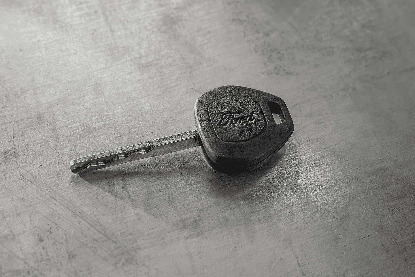

Without the fob the engine won't start correct ?
Correct, you can't use just a bare key blade. The fob contains the microchip for SecuriLock, Ford's PATS (Passive Antitheft System) AKA engine immobilizer. That's the thing select Hyundai/Kia vehicles are missing, making them notoriously easy to steal (see news reports).
Long story short, you have two options. Use the flip key as is or see if you can source a basic Ford key with the built in microchip. Not sure if they make one compatible with Maverick.
Ford offers one on some of the larger commercial trucks/vans that looks like this (the black plastic house holds the chip). Not sure if it's compatible but don't see why not.

You can certainly get a non remote key but it does need to have a chip in it which you need to pair to the vehicle. With that you then don’t need to carry a regular remote type key.
If you still have your 2 original keys you can pair any new chip key yourself with or without remote.
I have done this myself and have one simple non remote key that I can use for things like water sports (since it doesn’t mind getting wet and is smaller to carry). I ordered this blank from Amazon and then got it cut by a locksmith (which took some finding for this particular design of key) then paired it myself. There was another thread on which blanks to order and the pairing process.
This applies to XL /XLT, Lariat being a bit different so can’t speak to that.
