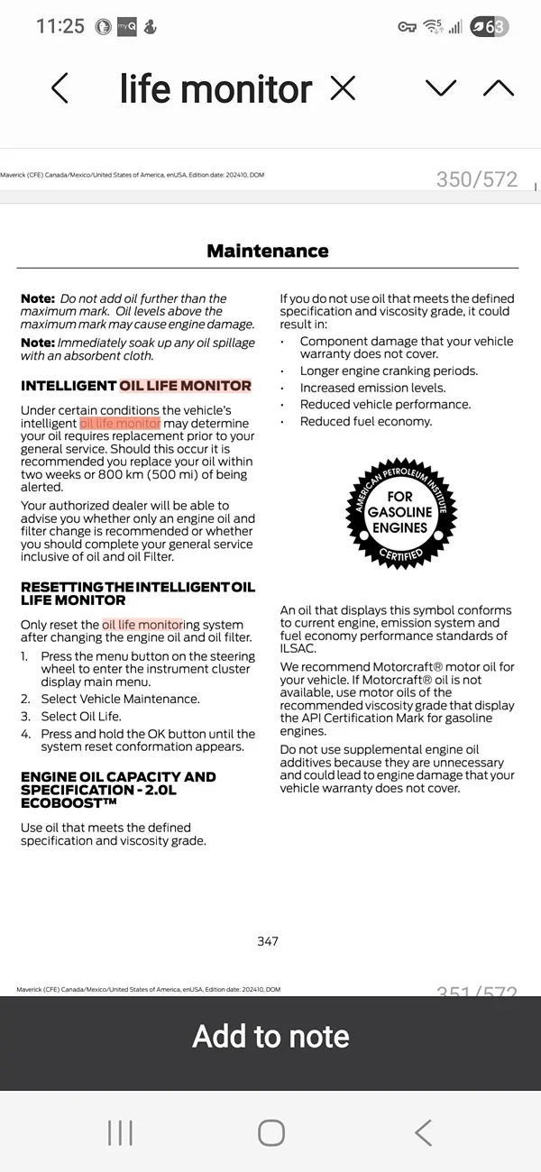

Ummm, with the little bit of info provided by you I will give you the easiest answer...get an oil/filter change and then reset your Oil Life Monitor.
Page 347 in my 2025 Manual has all pertinent info.
Ford Maverick Keep change oil light from coming on Screenshot_20260313_112533_Samsung Notes
You should be good for quite awhile after that...then change your oil and filter again when it comes on.
Other then that, more information is required.
