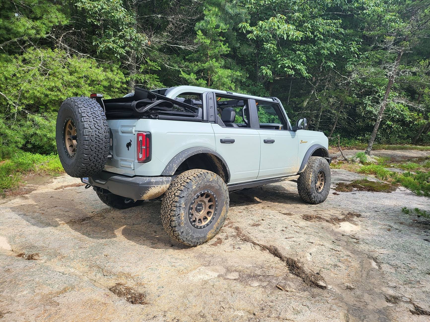

As I said, I'm ordering an AWD Hybrid & my plan is to lift it around 2", swap out the 19's for some 17's, and go up to a 30" tire. I'm also looking at adding the Prinsu roof rack. I used to do a decent amount of off-roading but now it's mostly just dirt roads & trailheads. I know that I'm going to take a hit on MPG but I should still double my current ride which will be nice since it's also my daily.

All of these are valid points. I looked at the Tremor but for what I'm doing, some dirt roads & trailheads but mostly DD, I think the AWD will serve me just a well but with better gas mileage.
I've had my IFS Bronco lifted 3.5" & riding on 37's for over 3 years with quite a bit of serious off-roading & no issues. Yes, I know that it's axles are stronger but the difference in angle & additional load is, at worst, comparable. I know plenty of people with lots of miles on lifted Subarus & 1 person with almost 30k miles on a lifted EcoBoost FX4 Maverick. Yes, lifting an IFS vehicle puts more stress on the CV joints but in my experience, as long as you're not abusing the vehicle, you can mitigate your chances of doing any damage. & if I do damage an axle, that's the price to play.
As for the tire size, if you search 245/65R17 you'll see a number of people on here running them. Keep in mind that the factory 225/55R19 is 29" in diameter so we're only talking a 2.7% difference
