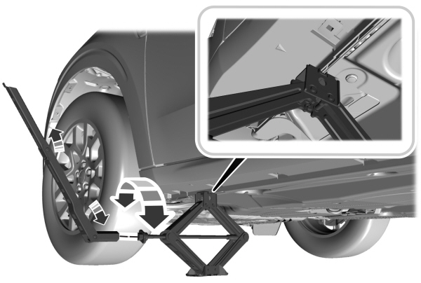

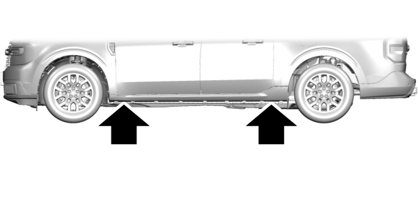

Modern unibody vehicles are designed based on the dealer model of a 4 point 2 post lift. As a DIY'r, you jack from the side on a Maverick, either at the lift point, or with a spreader in the center of the lift points, always on the side sill pinch welds.

On all of my other vehicles I have used one jack stand on the pinch weld and another on a rail or cross member. On my hybrid Mav I haven't found anywhere besides the pinch weld to put another jack stand because of the under body shield. I thought about the lower control arm but I don't like that option. I want it on the body of the vehicle. Anyone have some suggestions?
See post #12. You will have to remove the shield. Roll it up on ramps, remove the shield and use the areas I indicated in the picture at the link.
