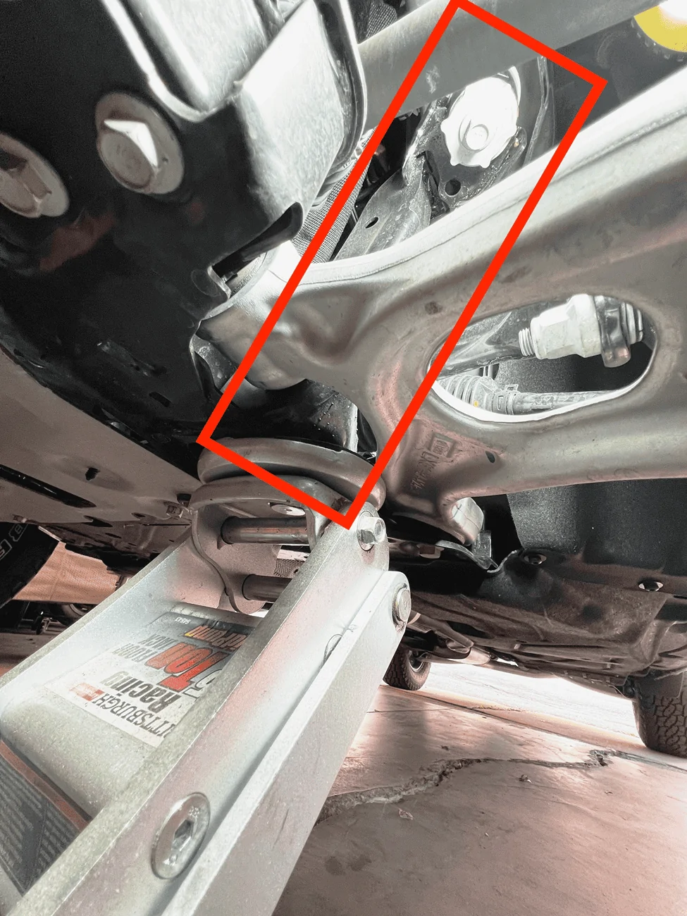

Here is an image where you can jack up the truck before putting the jackstands under the pinchwelds.

That looks like a great spot. Let me ask, that point looks close to the centerline, are you able to raise the entire front end with just one lift, or do you still need to lift left, jackstand left, lift right, jackstand right.

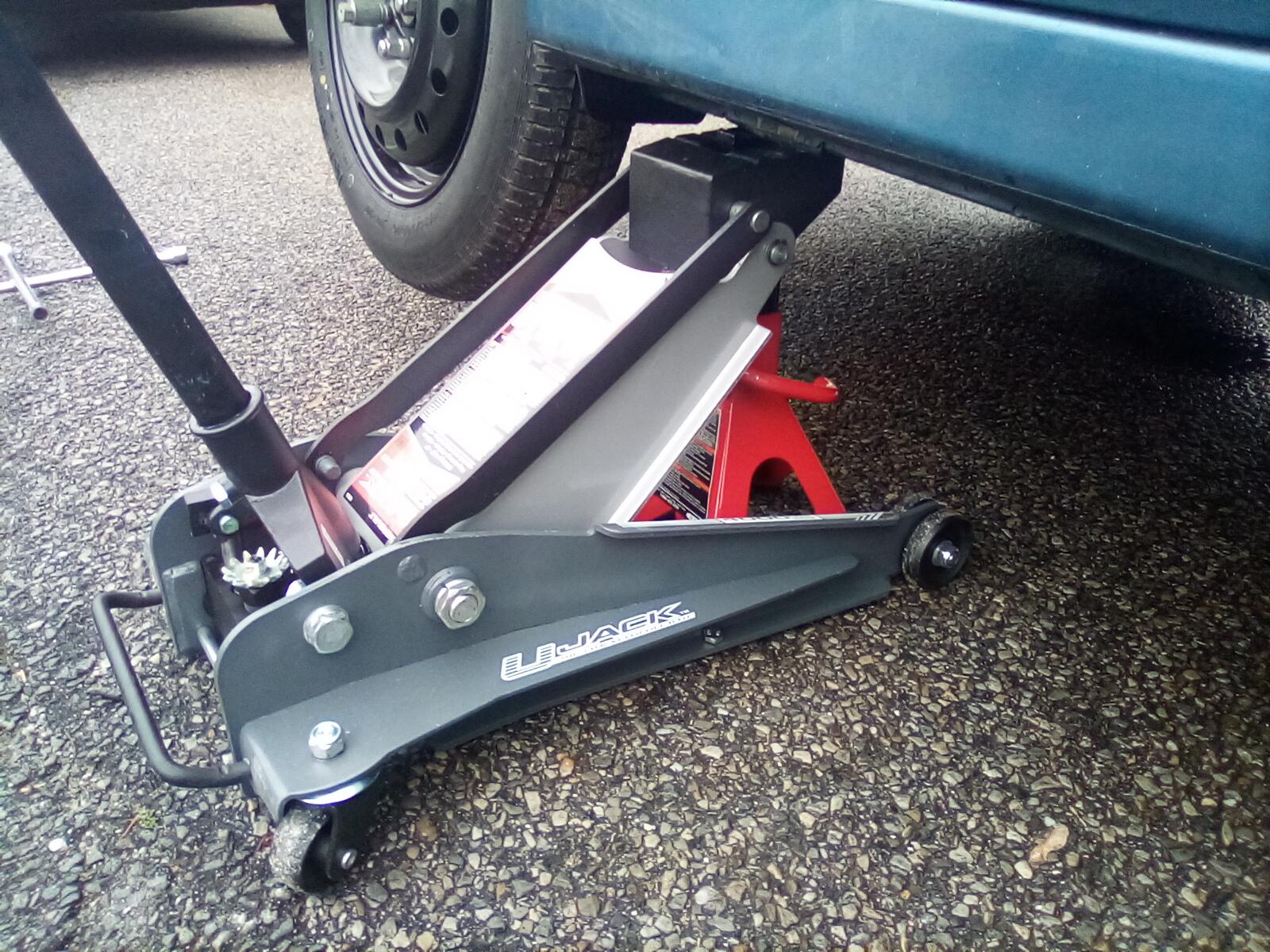

Went to change oil in my 2024 Lariat Hybrid tonite. I used the official jacking points for the front. I got a floor jack with one of those rubber blocks with a slot to not damage the multi fold metal. Once under the vehicle, it looked a lot easier to just put the floor jack under the lower control arm. Looks beefy enough. But I wanted to check in to the forum if others agreed the lower control arm is acceptable.
I use the UJack with their jack stands, works well. Not too expensive.

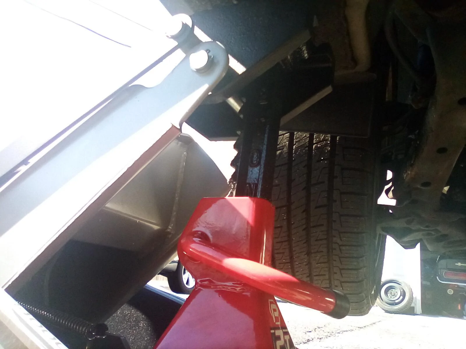

Ford Maverick Jacking on Lower Control Arm IMG_20240228_155749
Ford Maverick Jacking on Lower Control Arm IMG_20240303_111356
Unfortunately Ford didn't design to have a single lift point to lift the whole front with just one floor jack. Therefore you will need to do 2 separate lifts, left/right side and insert the left/right jackstand after each lift.
