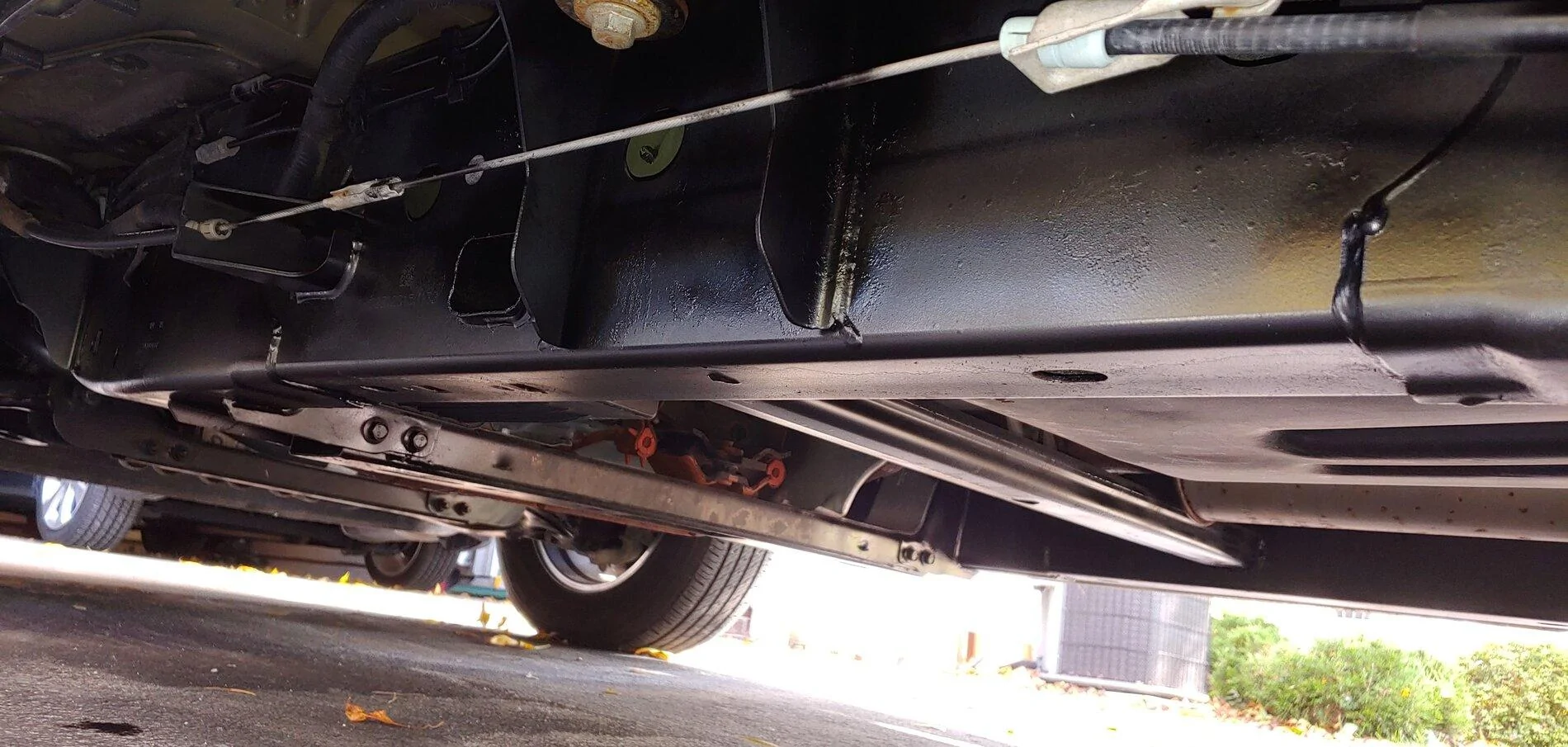

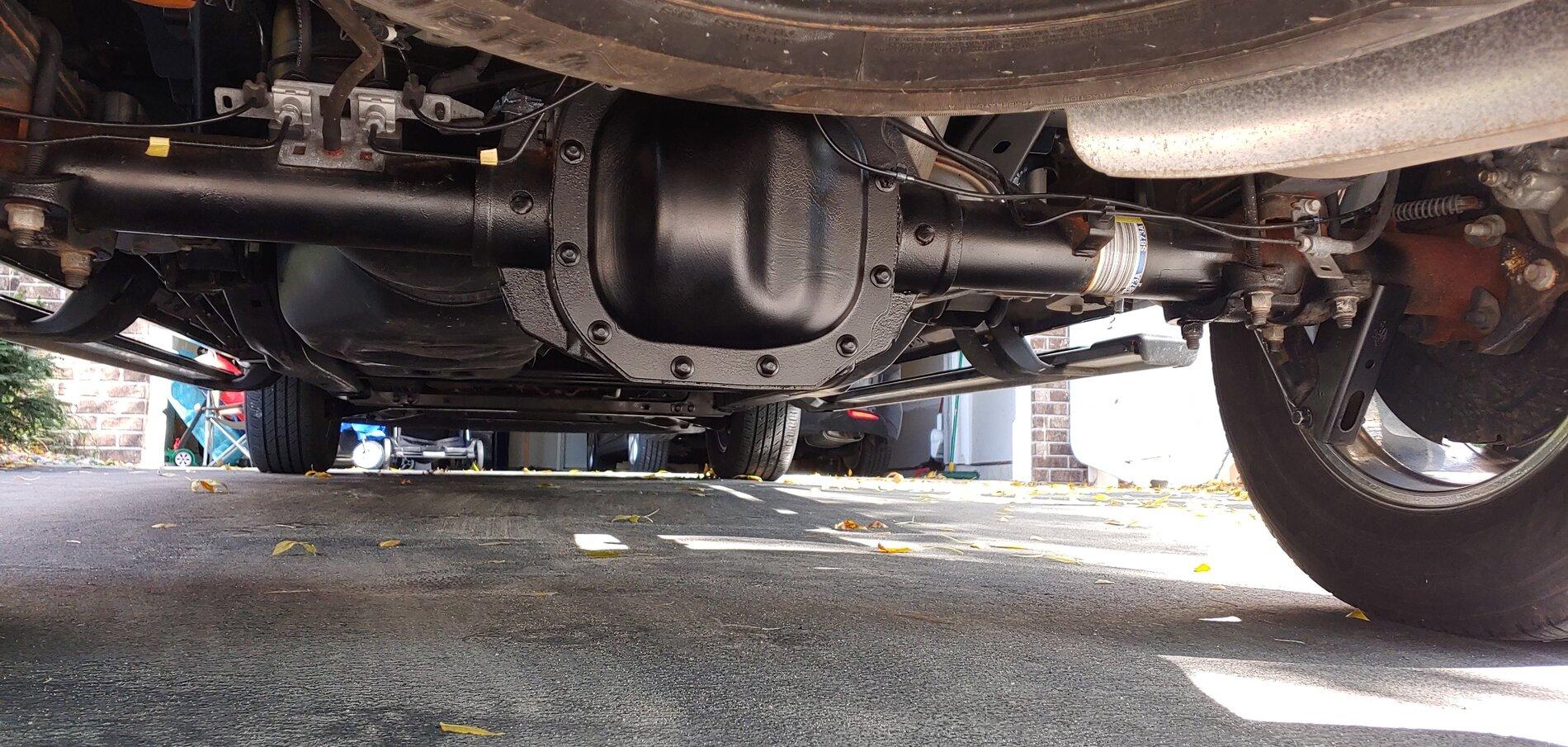

I see a lot of people against it, claiming it traps in moisture and promotes rust, but that has not been my experience. My 2015 F150 spent most of its life in Minnesota. When I bought it, I wiped down the entire frame with MEK and then I used Eastwood Rubberized Rust Encapsulator and also their Internal Frame Coating. 5 winters in MN and the frame still looks like this. Sure some spots need touch ups every year before winter, but it’s still this clean overall. On suspension and hard to reach areas, use Fluid Film.
