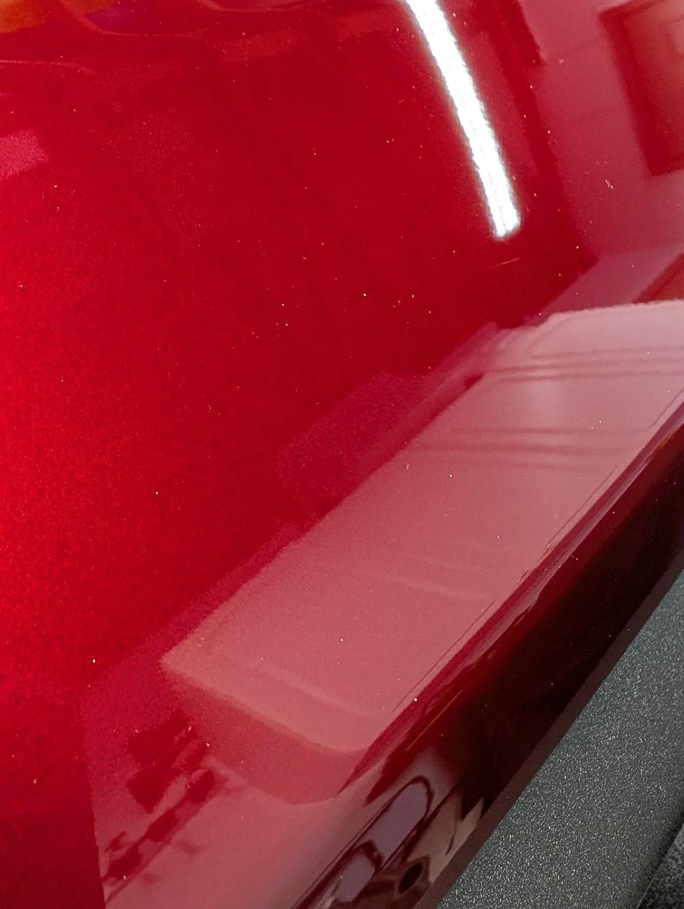

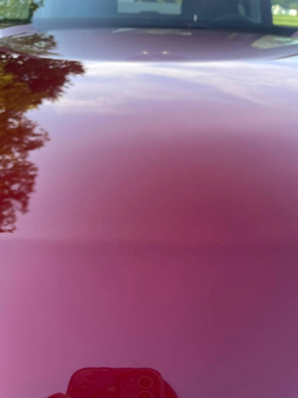

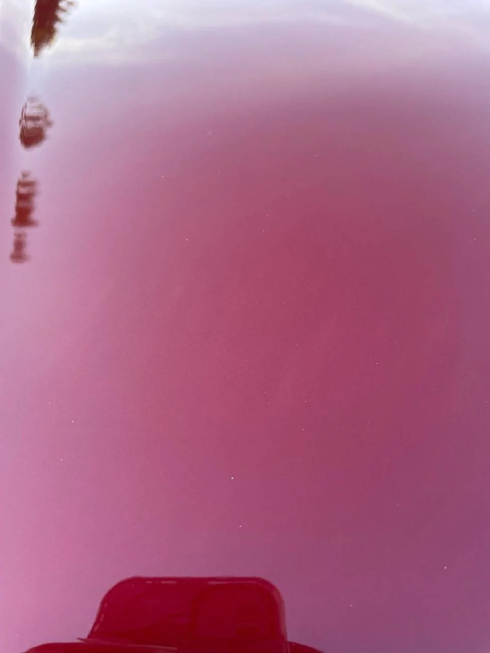

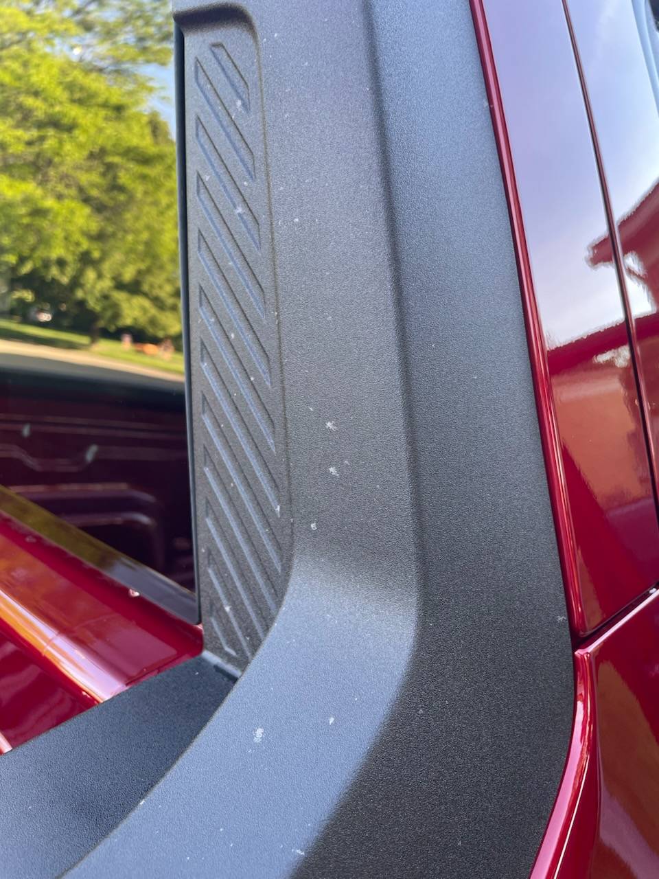

Picked up my 25 Hybrid AWD Maverick on Thursday. Looked it over good at the dealer (at least I thought I did). Drove it home from the dealer (15 min drive) and once I parked it in my garage and turned on the over head lights I noticed what I think might be rail dust? It's definitely sitting on top of the clear coat but doesn't want to come off easy and I don't want to scrub on it and scratch the paint. Also there is this strange white round circular outline towards the lower center of the hood. It almost looks like someone set down a bottle of cleaner on the hood but that doesn't want to come off either. Last but not least there is this strange white stuff on a lot of the black trim of the truck - almost like something splatted all over it. Unfortunately that doesn't seem to want to come off either. I plan on taking it to the dealer and seeing what they say but I'm not optimistic. I will post some pictures below but it's kind of hard to capture in a pic. Shame on me for not noticing this at the dealership:(

You want to hit the rail dust a few times with Iron-X or a similar iron remover BEFORE claying it. Hit it until it stops running purple after a few minutes.
Once the iron is removed, then you clay it to remove whatever's left

Took the truck back to the dealer today and my longtime salesperson looked at and so did the vehicle prep manager. They are calling it industrial fallout and not rail dust per se I guess. I did send these pictures to a trusted detailer I have worked with in the past and he said he doesn't think it's rail dust either. I guess industrial fallout is a fancy word meaning they don't know what it is.
Anyway my dealer said it needs to go to the body shop so they are working on getting me an appointment at the body shop. The strange thing is the white stuff that can be seen in the picture I posted of the black plastic trim pieces. It looks different both in size and pattern compared to the flecks that can be seen on the hood. Honestly I'm not sure what the heck is all over my new Maverick but it's pretty frustrating. Also the flecks on the mental hood I posted are pretty much all over the metal panels on the truck (all the sides, doors, and even the roof). I just hope they can get this fixed to my satisfaction as I am loving the truck so far.
