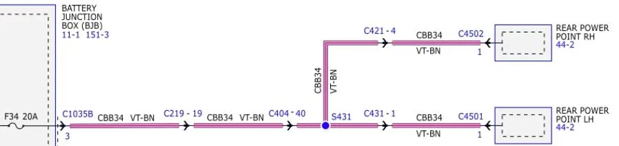

Thanks for the information. I seem to have a problem with the driver's side bed receptacle. The passenger's side seems to be working well and the driver's side did too before I overloaded it. Are the two bed receptacles on the same wiring or is there some sort of fuse that controls them separately and if so where is it? Thanks again!

The 2 12V bed outlet are on the same circuit.
Fuse in the BJB at Position #84 = Wiring Diagram F34.

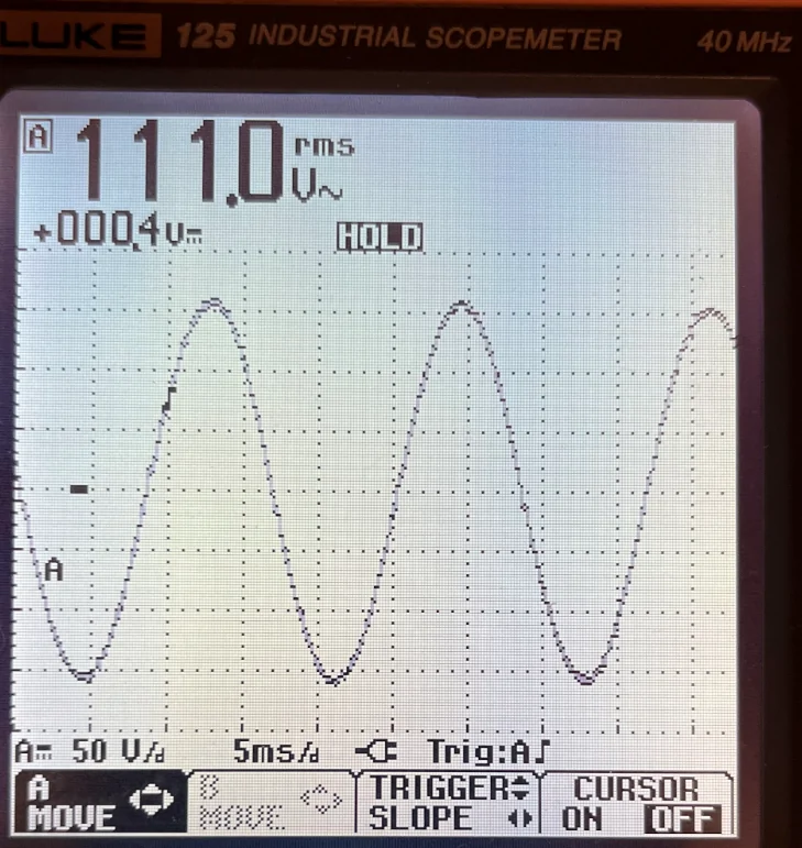

My Maverick 400W Inverter modified square wave:

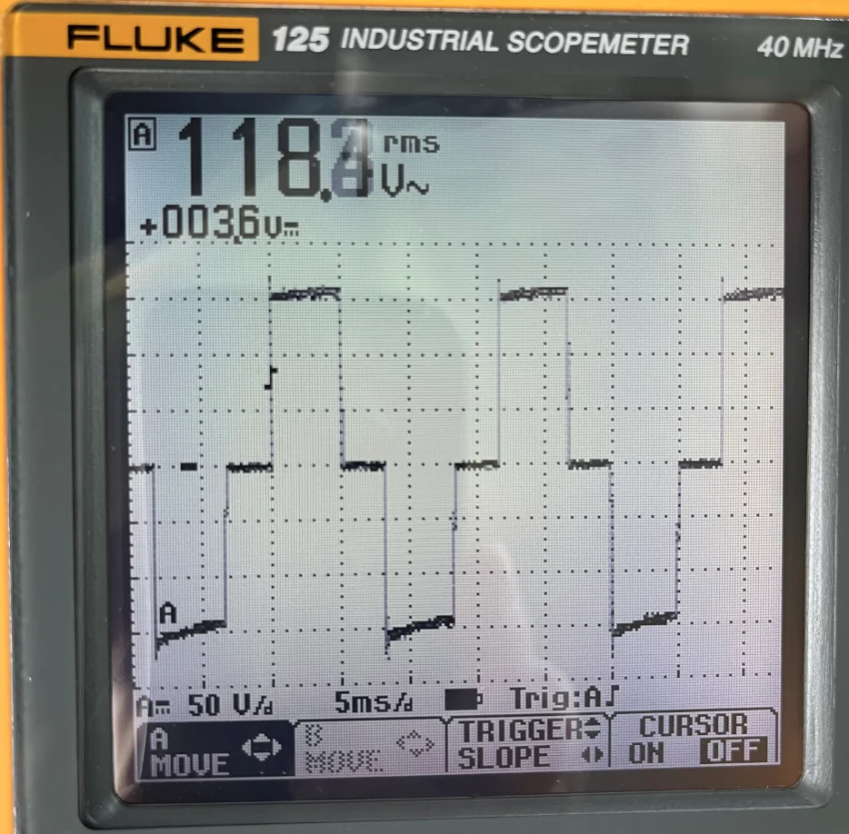

300W Pure Sine Wave inverter sine wave:
