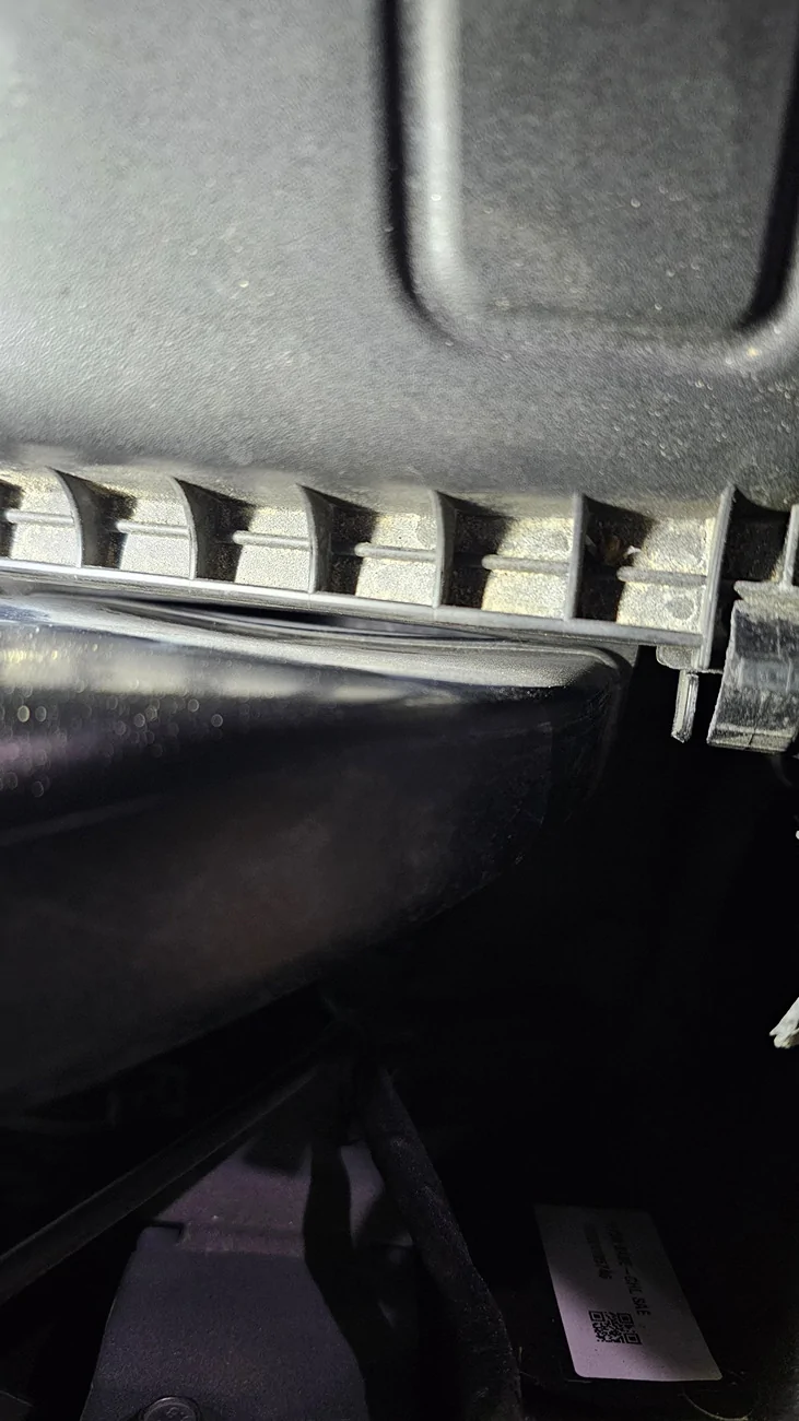

Is my truck unique here or are all the Ecoboost intake tubes like this? It doesn't fully seal into the lower airbox for some reason, there's a little gap that you can see in the picture below. Now, maybe this is for high speed conditions or something, but I can't help but ask. Also, one of my lower airbox grommets deleted itself into the ether, wondering where I can get another...

Parts that snap together like this aren't made to have a perfect seal. A gap there is nomal, and the majority of the air will still be coming from the cool location just behind the grille.
The grommet/insulator shows as a separate part number on online part sites, so you should be able to order one online or at your dealer. Part CC1Z9B929A
https://www.fordpartsgiant.com/parts/ford-insulator-asy_cc1z-9b929-a.html

I will have to look at mine next chance I get. If there is a gap I will definitely be coming up with some kind of DIY seal.

Thats fair, just wanted to see if it was common. And thank you for that, I was worried id have to order the entire airbox lol
Definitely let me know, im curious!
It's very common. Mine has the same gap. It's basically just how the intake tube is molded; it's not rigid enough to maintain the perfect shape. The only real drawback here is that it's pulling in a little bit of warm/hot air from inside the engine compartment but I doubt it's enough to really matter.
