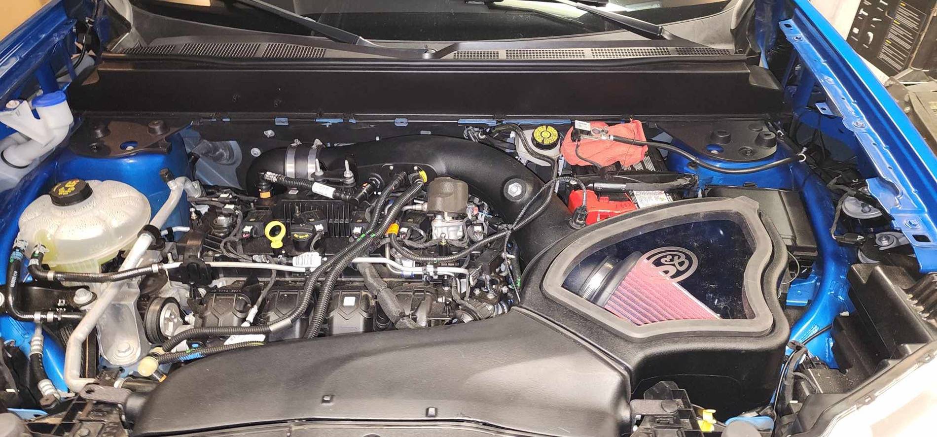

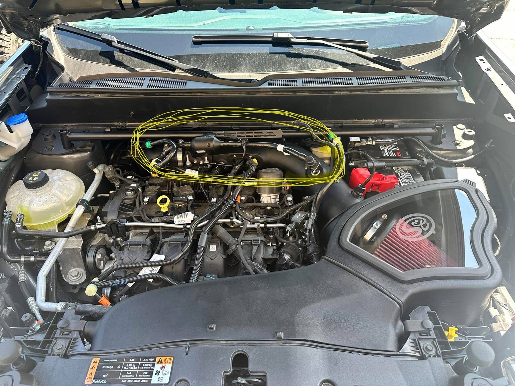

Question, I have a 24 XLT FX4 and friend has a 22 lariat. Both have SB CAI, on mine I have a factory “unit” that’s attached and plugged into the CAI whereas the 22 did not come with this part. Can someone tell me what it is? Thanks

Since neither of those pictures show a stock intake, who knows what has been removed, what has changed, etc. Other than making more turbo noises and using a much more expensive filter, did the new intakes do anything useful?
The part circled is the vacuum for brake booster and not included on lariat models as they use an electronic booster.
as for the SB intake, I’ve seen better throttle response, slightly better MPG, and the build up of boost better while maintaining lower intake temps.
