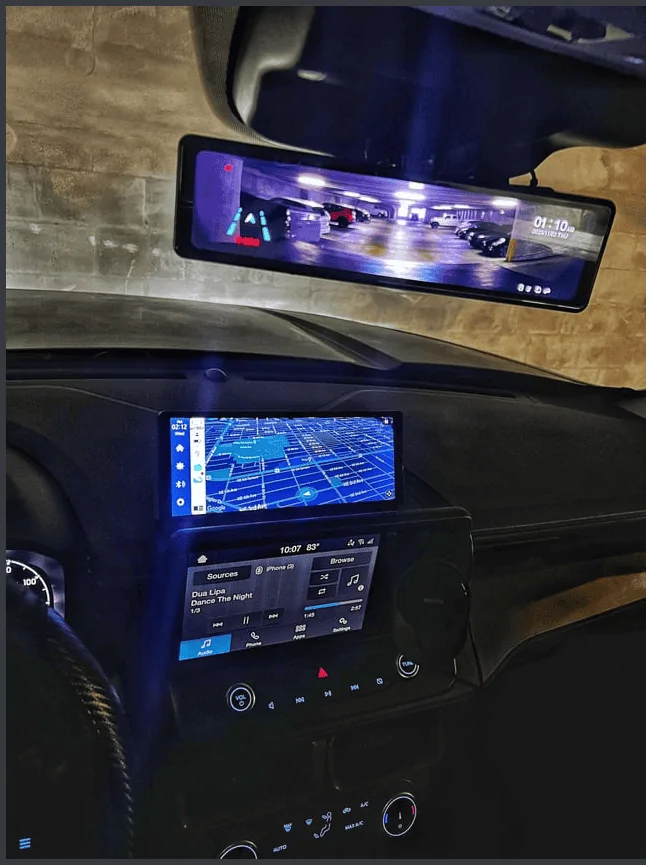

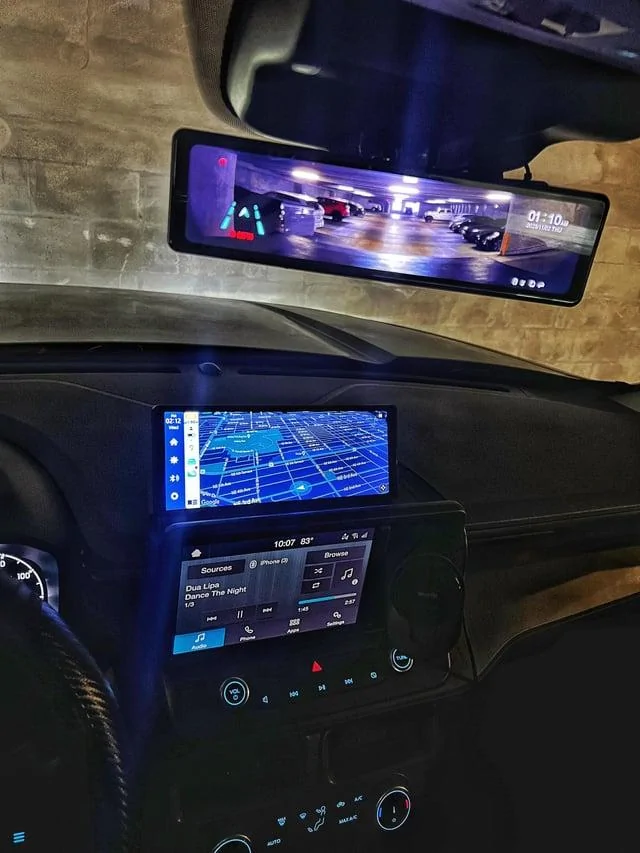

See this for more inspiration:
Ford Maverick Installing an External Carplay Screen (not using OEM screen) DIY Project jsrf0ei1j70c1
It keeps the OEM screen and adds a widescreen for AA/Carplay above.
My main gripe is that the OEM is hard to read in bright light - screen doesn't get bright enough to easily see maps while driving!

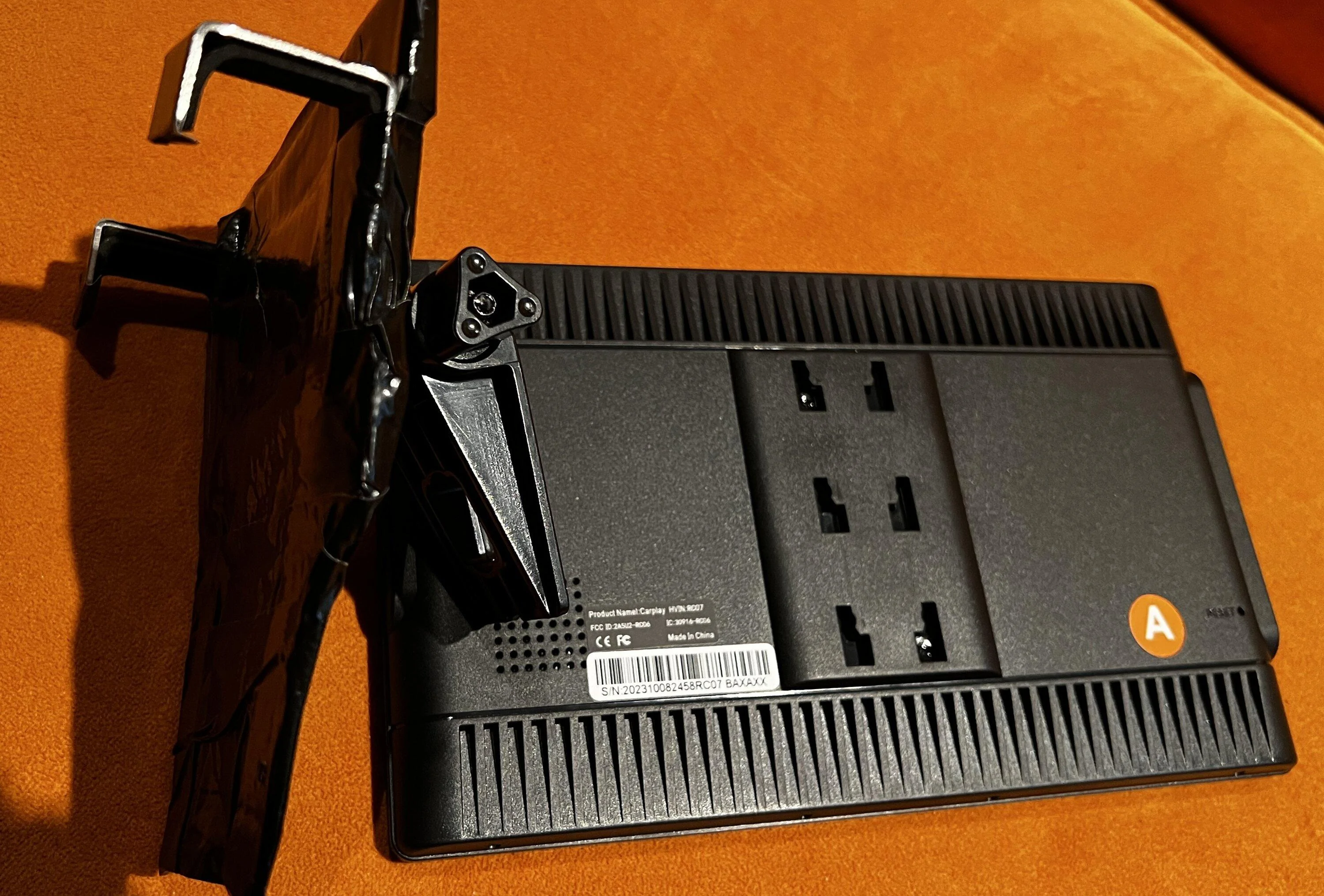

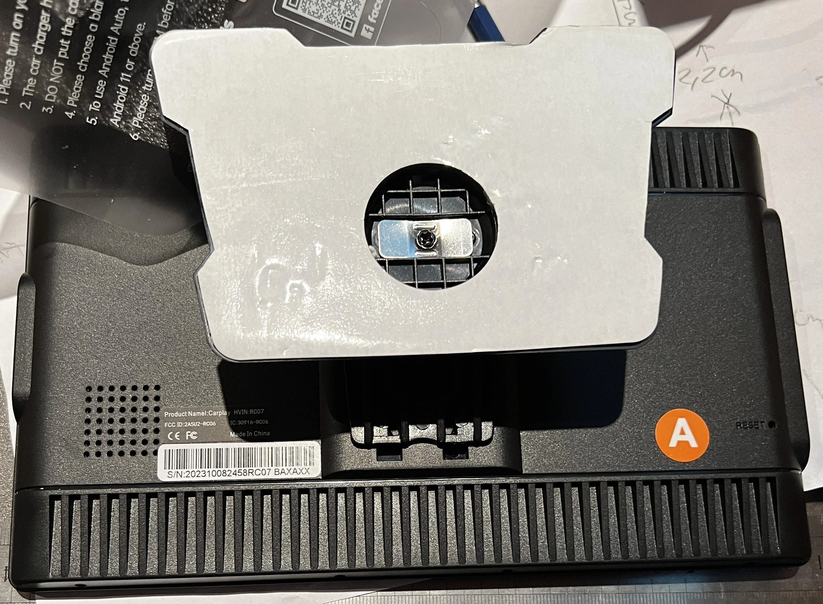

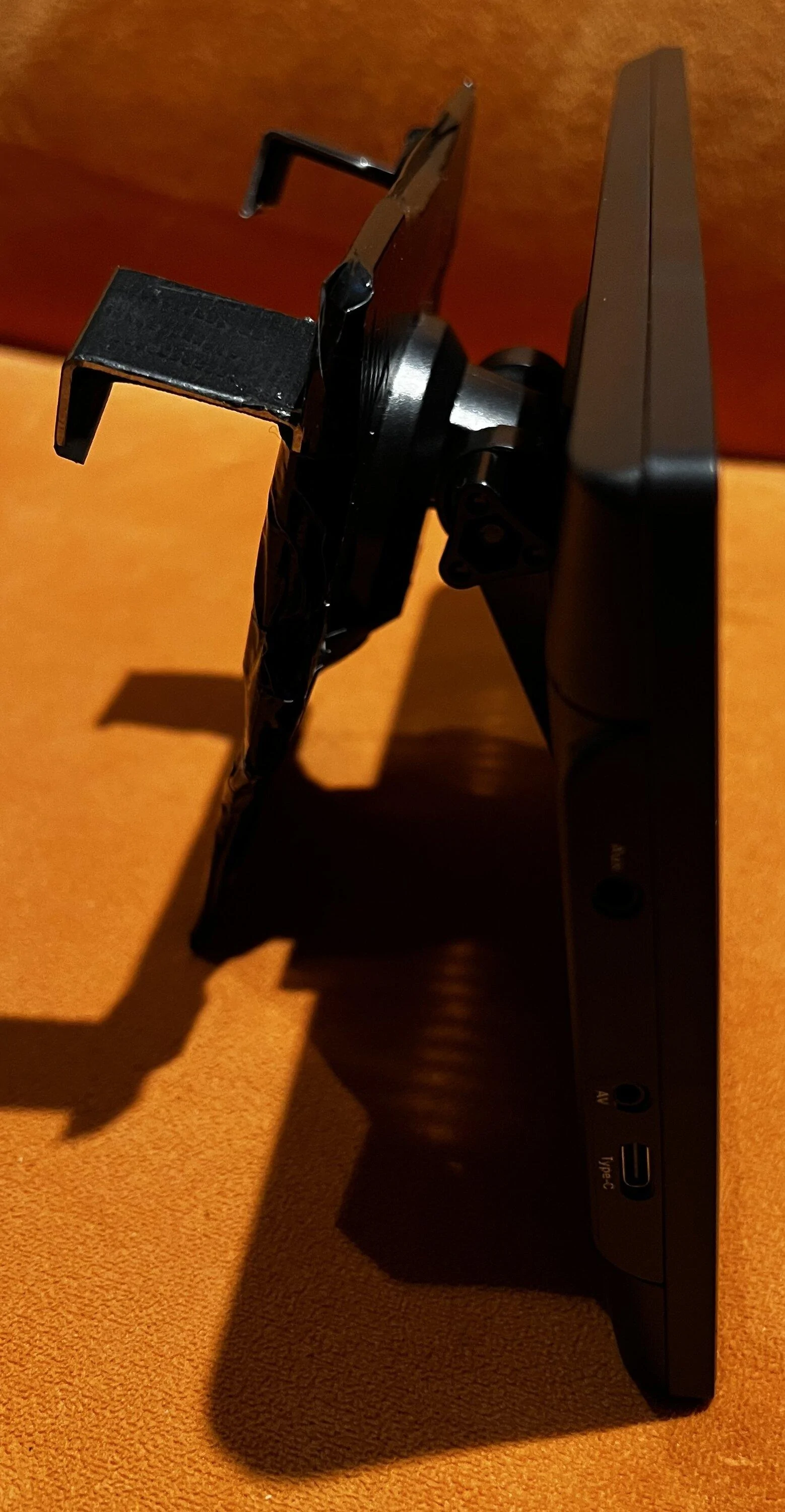

Here are more pictures,
This one shows the back of the Carplay screen (base of the project) with
the attached bracket
Ford Maverick Installing an External Carplay Screen (not using OEM screen) DIY Project IMG_2902
added 2 metal brackets (that had foam underneath them for protection) that came out of a towel bar (dollar store)
Ford Maverick Installing an External Carplay Screen (not using OEM screen) DIY Project ddddd

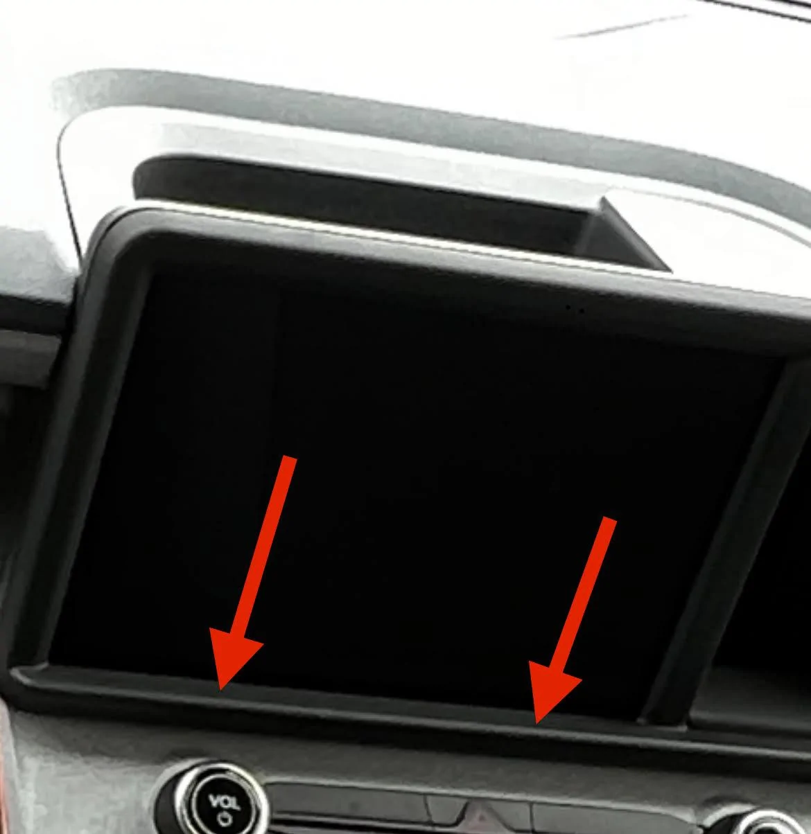

Pratical thing, the 2 brackets seats at the bottom lip of the screen (yes added 2 foam pieces at the 2 contact points)
Ford Maverick Installing an External Carplay Screen (not using OEM screen) DIY Project fffff
A bit of black duck tape for now (lucky me I don't see this when seating in the driver's seat) for
the primitive home made brackets:
Ford Maverick Installing an External Carplay Screen (not using OEM screen) DIY Project IMG_2914
Ford Maverick Installing an External Carplay Screen (not using OEM screen) DIY Project IMG_2916
Ford Maverick Installing an External Carplay Screen (not using OEM screen) DIY Project 1702560633133
What is the brand and size of the extra screen?
