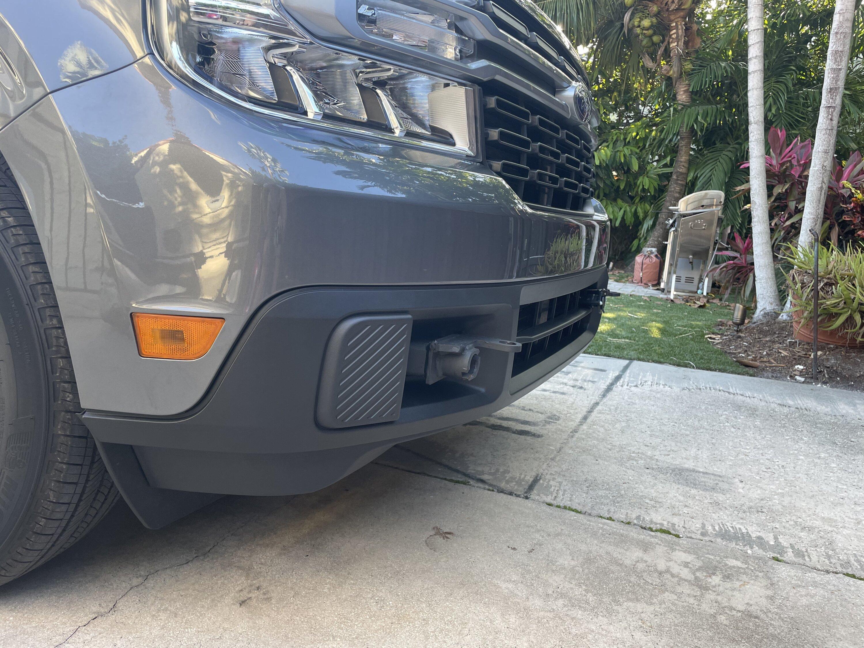

It was definitely pricier than I was expecting. The original install was about $4800. It broke down as follows (rounded):
Blue Ox base plate - $550
Blue Ox Ascent Tow Bars - $1050
Wiring Kit - $200
Demco stay n play duo brake system w/ monitor - $1350
12V Battery charger - $50
labor for this install was $1250.
Plus tax
the day of the install they were in constant contact with me. They did not like the idea of cutting the fascia and I told them I knew what to expect. they tried talking me into the roadmaster but I didn’t want to mess with the shutter system. Before I even got the car back from them, I had found the part number for the FX4 fascia and placed my order with Ford Parts. When I picked up the maverick, I was impressed and told hIm he should send a picture of this to Blue Ox, cause they did a much better job than what’s on their website right now. 🤣. All in all they did a great job cutting out the fascia, so I waffled on the expense and hassle of changing the bumper. But I had the bumper a week later and decided to go ahead and scheduled the work.
My additional expenses were:
FX4 bumper fascia - $340
Extra Labor - $250 - which I could’ve saved had I bought this originally.
If youre up the coast a bit and are gonna use these guys, their normal situation is, drop off the car in the morning, and come back the next day with your rig and they‘ll walk you through the connections. Coming from the treasure coast area, they may make an exception for you.

Thank you so much for the great information. Is the correct part number in 26217626 VA? If so where did you source it? My local dealer requires a service order so I can order the part and it’s $80 more than what you paid for it.
I doubt the link I’ll share at the bottom of this will work. But go to parts.ford.com
It’ll make you pick a local dealer, that’s fine. However, the key is - do not add your vehicle by vin though, because it will say this part is not for your vehicle. Just select the year, make and Maverick so you Generically look for maverick parts. Once your at this point copy and paste NZ6Z17626BA into the search bar. It should come right up. Let me know what price it gives you. Take note though in the thread here what we did to connect the bottom of the fascia to the bottom cover panel. Good luck
https://parts.ford.com/shop/en/us/body/bumpers/panel-14200257-1?pdp=y

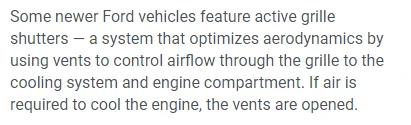

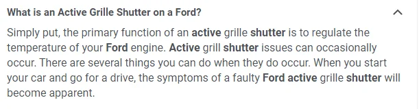

Let me preface this by saying that I have not done this to my Maverick.
But, in regards to the active shutters for the intercooler and radiator, they are not for cooling or emissions. They are for fuel economy (aerodynamics) and in fact the intercooler shutter is closed all the time in ECO drive mode.
Ford has used active shutters a long time. Generally you would remove the shutter itself and leave the motor assembly. It thinks it's opening and closing the shutter but there's nothing to move.
If you were to unplug the motor and remove it, you will get a check engine light. I've never looked to see if anyone has turned it off via forscan or used a dummy load, but I am very sure that many F150 and Focus ST/RS drivers have removed the shutters. I would think no issues with the Maverick as well.

Yes Brad, I know what the manual says. They could have some small impact on the time it takes to warm the engine when cold-started. The F150 and Focus communities state that it is low/no impact even in northern states, but I can understand how this is technically a benefit you will lose.
They negatively impact cooling when closed, of course. So if actually cooling, and not cold start warm-up time, is a concern then you have nothing to be worried about.
It's mainly done for aerodynamics as I stated previously. And it can be partially removed with no fault codes.
