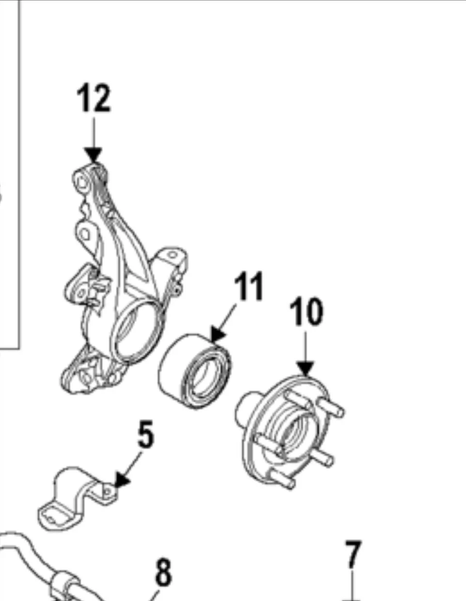

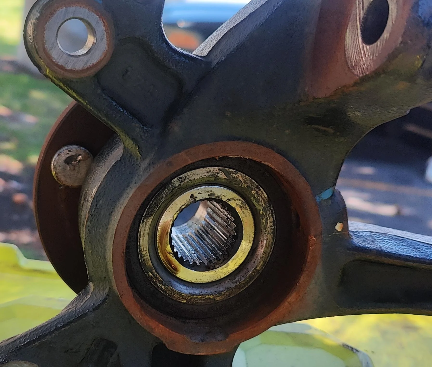

@MankDeems :
You quote " There is NOT ENOUGH SPACE TO KNOCK THE STUDS OUT THE BACK EVEN IF YOU BROKE JUST STUD 1 YOU HAVE TO PRESS THE HUB AND BEARING OUT MOST LIKELY DESTROYING JUST TO RELOAD STUDS! "
Dunno dude. Looks like there's room behind the marked stud below for the stud to be pressed out with the knuckle on the vehicle unless I'm missing something. I have yet to find a wheel hub where there isn't a single place to press out a stud.

@MankDeems :
Every day is a new day! It's hard to tell but I even peened it with my air hammer! That bitch is overlapping!!!
(Back side)
Ford Maverick I shot my own FOOT! NEGLIGENCE!!! 1000013784
The part diagram shows the spindle as a perfect circle disassembled too!

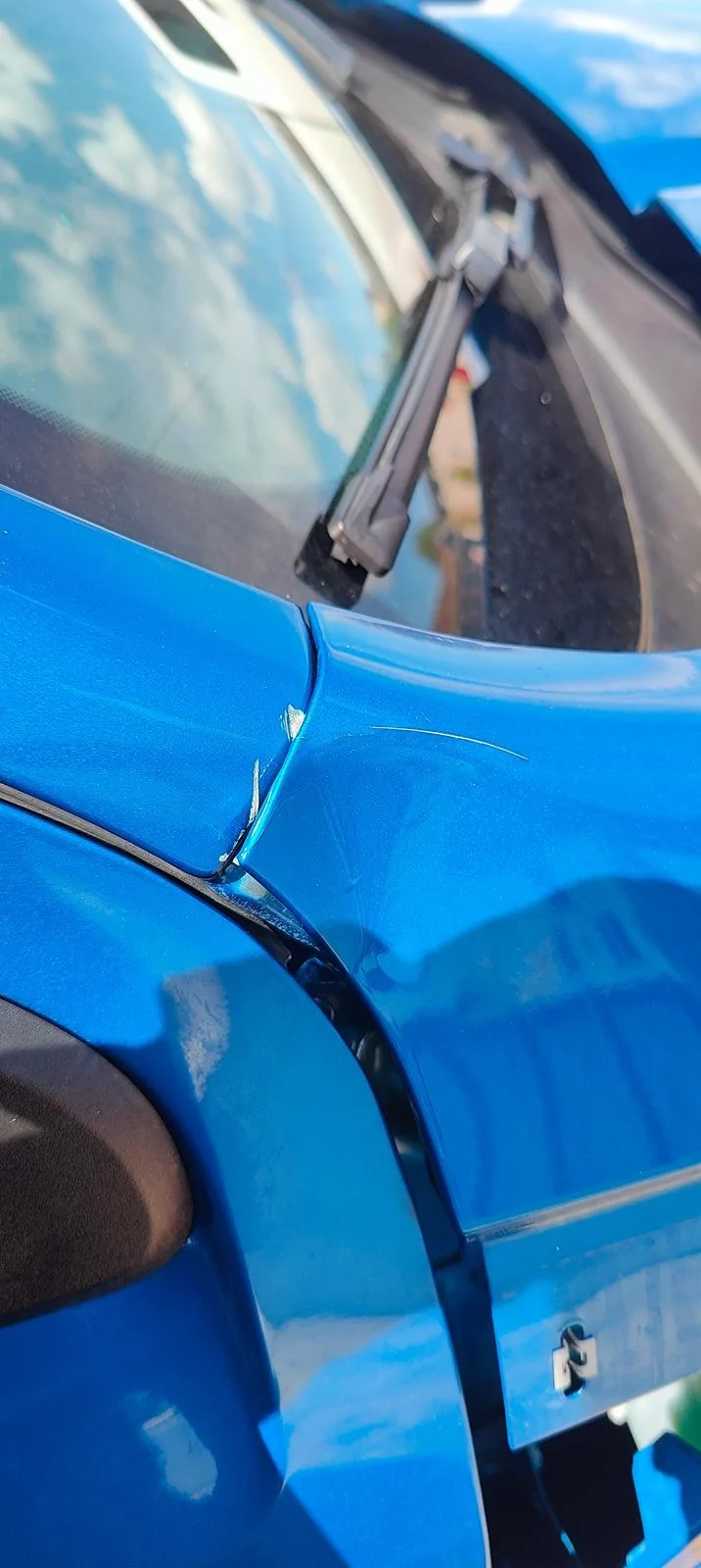

Bonus fender gore...

Hey I said gore.. and I said I'm gonna dribble touch up paint on it... these trucks were $19,995 for a base when I got mine in 2022. Ultimately it's the most versatile econobox a guy could ask for...
Shit a whole wheel fell off and it was $1000 to get it in livable conditions. try that on a 3 series BMW or a Kia Sportage I bet you'd be up schitts creek real quick
