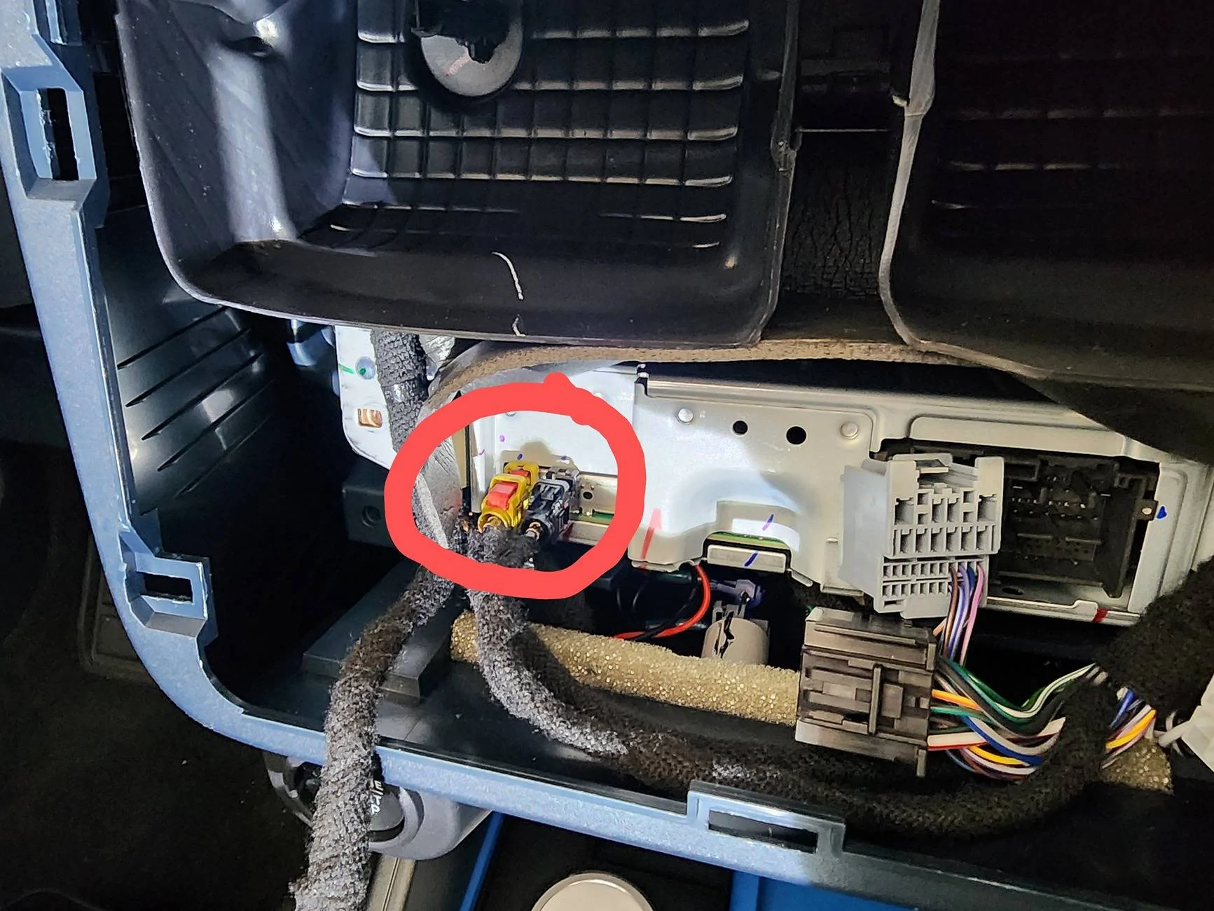

I'm in the process of upgrading the stock non-B&O stereo system on my 2025 XLT, but I'm stuck. I have installed new door speakers and a powered subwoofer and I
am now trying to find a place to mount a Kicker key 4 channel amp. I purchased a break out harness (and the amp) from plug N play kits and have already
tested the system and done the self set up through the kicker amp (it sounds awesome), but now I am trying to find a place to mount the amp in the dash.
The harness from plug n play has very short runs, so it limits the location of the amp. It seems there might be just enough room behind the radio head to fit

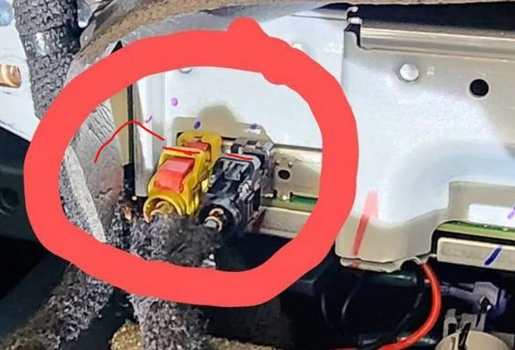

amp (maybe not), but I need to put the head unit out to confirm. My problem is removing the two wires as pictured. I have removed the small read tab
from one of the plugs, but it still will not budge. I don't want to break the connectors, so please, does anyone know how to properly remove those two connectors
without breaking them ???

I did call my local Ford mechanic and he explained how to release the connectors. I did see that the area above the cabin filter door location would be perfect if it was smooth, but this whole Velcro idea is my new favorite. I think I will somehow mount a metal plate to that area and use Velcro to mount the amp. I will abandon the behind the radio module idea. Thanks to everyone.

To the question, looking at the yellow one, there is a red piece. Above in the picture there looks like a latch that would kind of pull up and back. Movement like opening a door. I'm not 100% sure, but looks like a latch on my Sprinter RV, kind of releases the connector when you open it and also seats it when you push the lever back down on install. Please share what worked when you get it figured out.
Or maybe it pushes down?

2025 XLT Maverick hybrid AWD, 4K tow, 2019 Ranger
