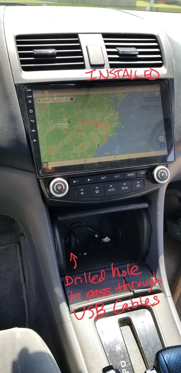

I just installed an after-market wireless apple carplay head unit in my 2003 Honda Accord lol. It seems silly to have to "downgrade" technology in a new vehicle, but knowing I can dish out cash for an upgrade later would make me more content.
