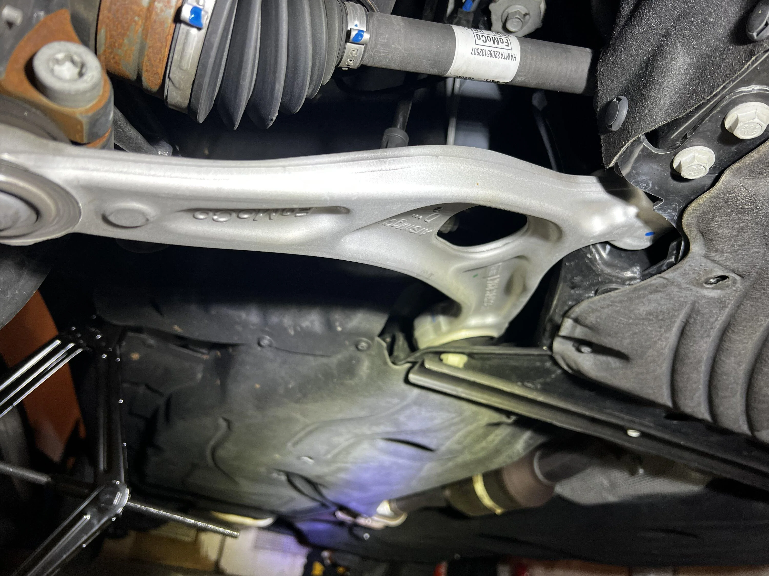

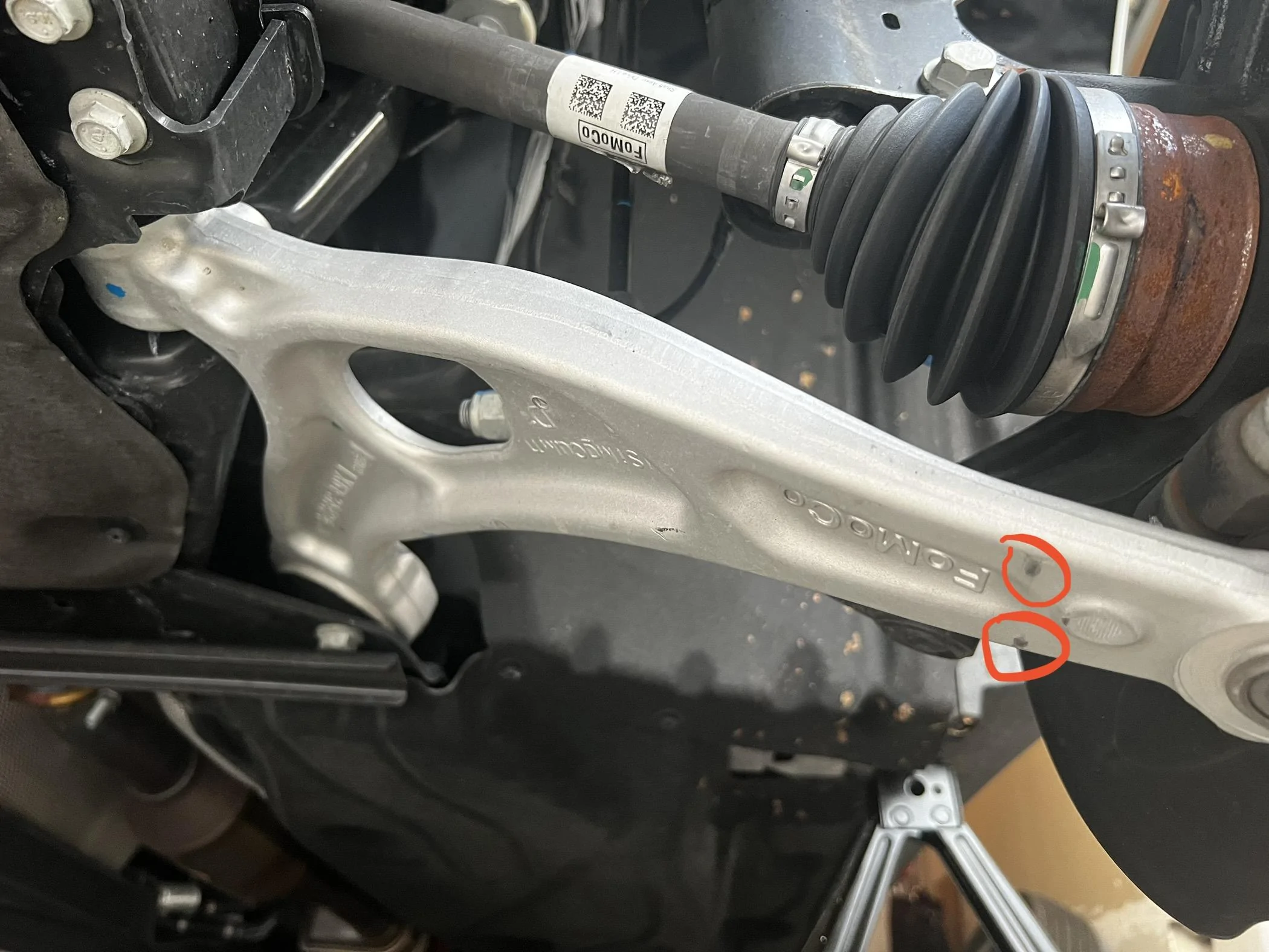

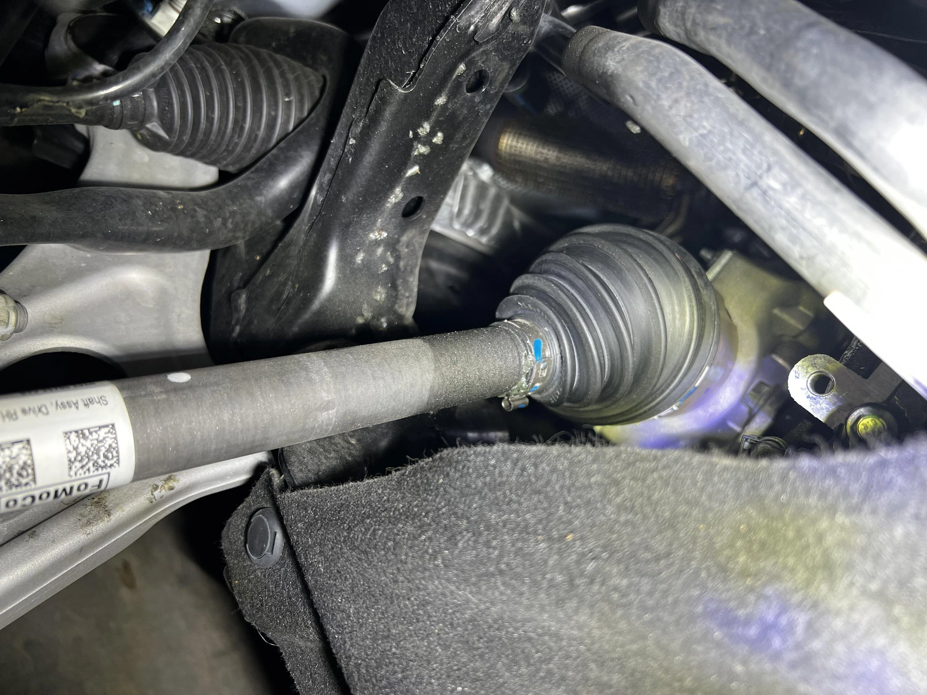

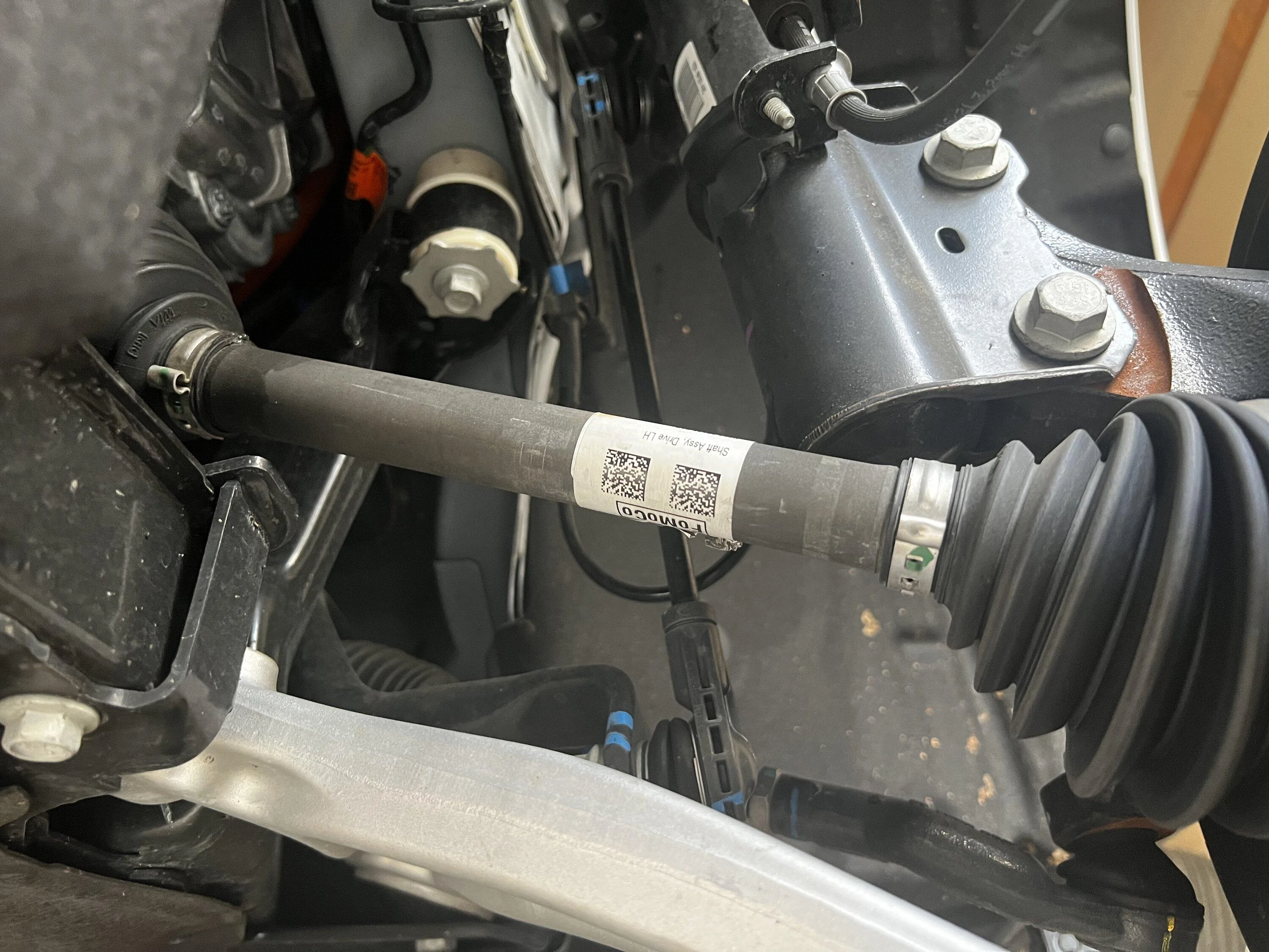

Alright folks, i climbed under the vehicle myself and realized Both Cv axles are leaking at the inside boot. Not a mention of that. I’ll attach pics below. I will also attach a pic of the only scratch I saw of the “A” arm or control arm. Where it is scratched, there is no way anything was flung into the axle. Such a weird thing for the dealer to call my claim physical damage.

For reference: the first 2 pics are from drivers side, and second 2 are from passenger side.
