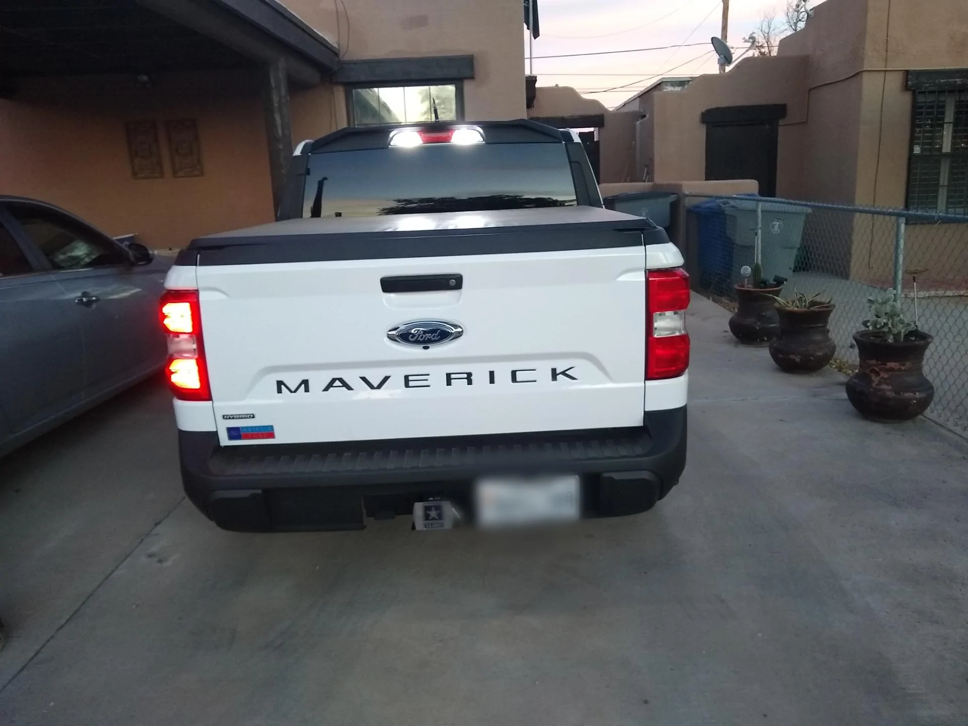

They said it was "grounded out" it didn't happen again.
Odd indeed. I experienced the issue again last night, and when I turned the switch off and then back on, it worked. It's quite peculiar that toggling the switch resolves the problem. In my opinion, this doesn't sound like a grounding issue.
