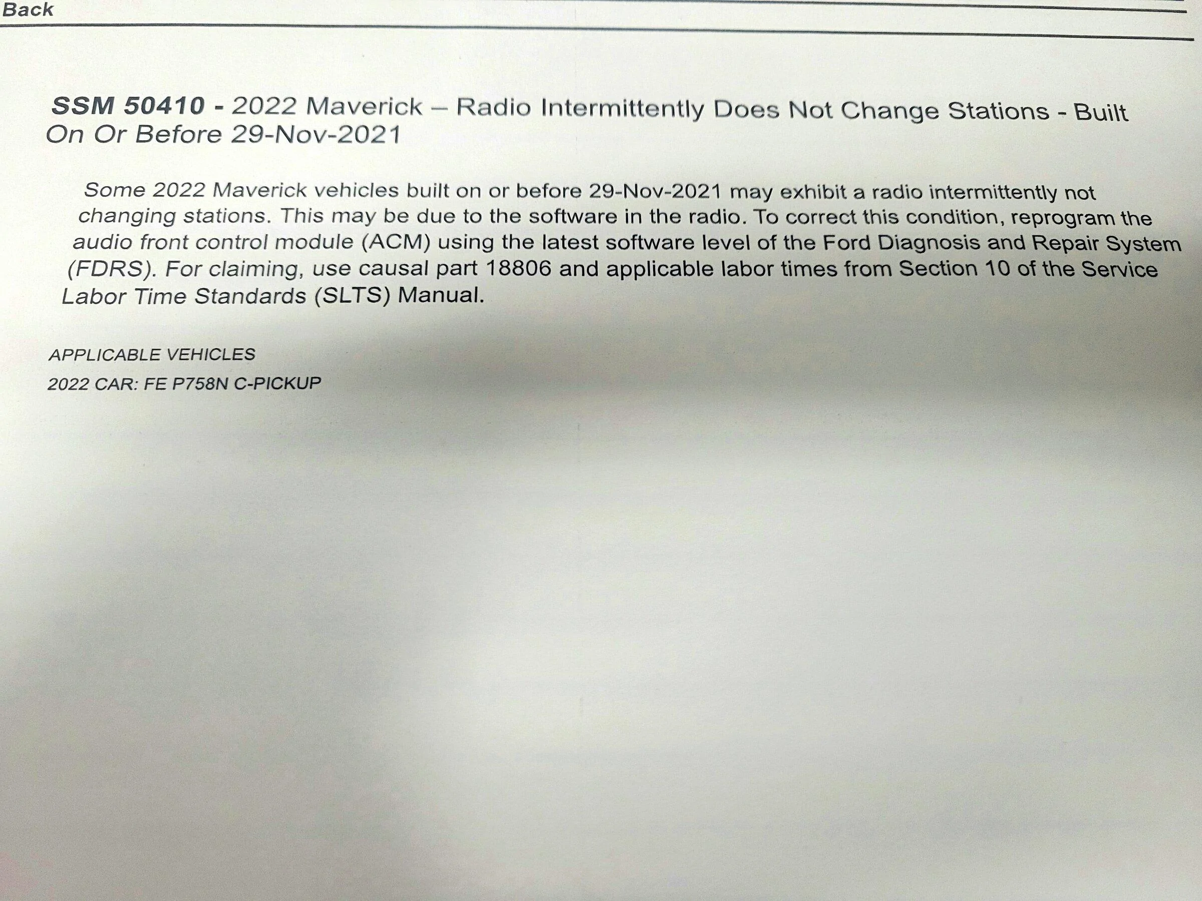

Dropped my XLT off today for the update..Radio hasn't worked right since day 1..freezes, won't change stations etc. I called about it as it was late in the day. Radio is fixed , but now they have a check engine light (wrench) , and they can't figure it out. Been working on it all day. My radio glitch probably turned into a month long ordeal with Ford tech support and my hybrid Maverick. Lets hope not.

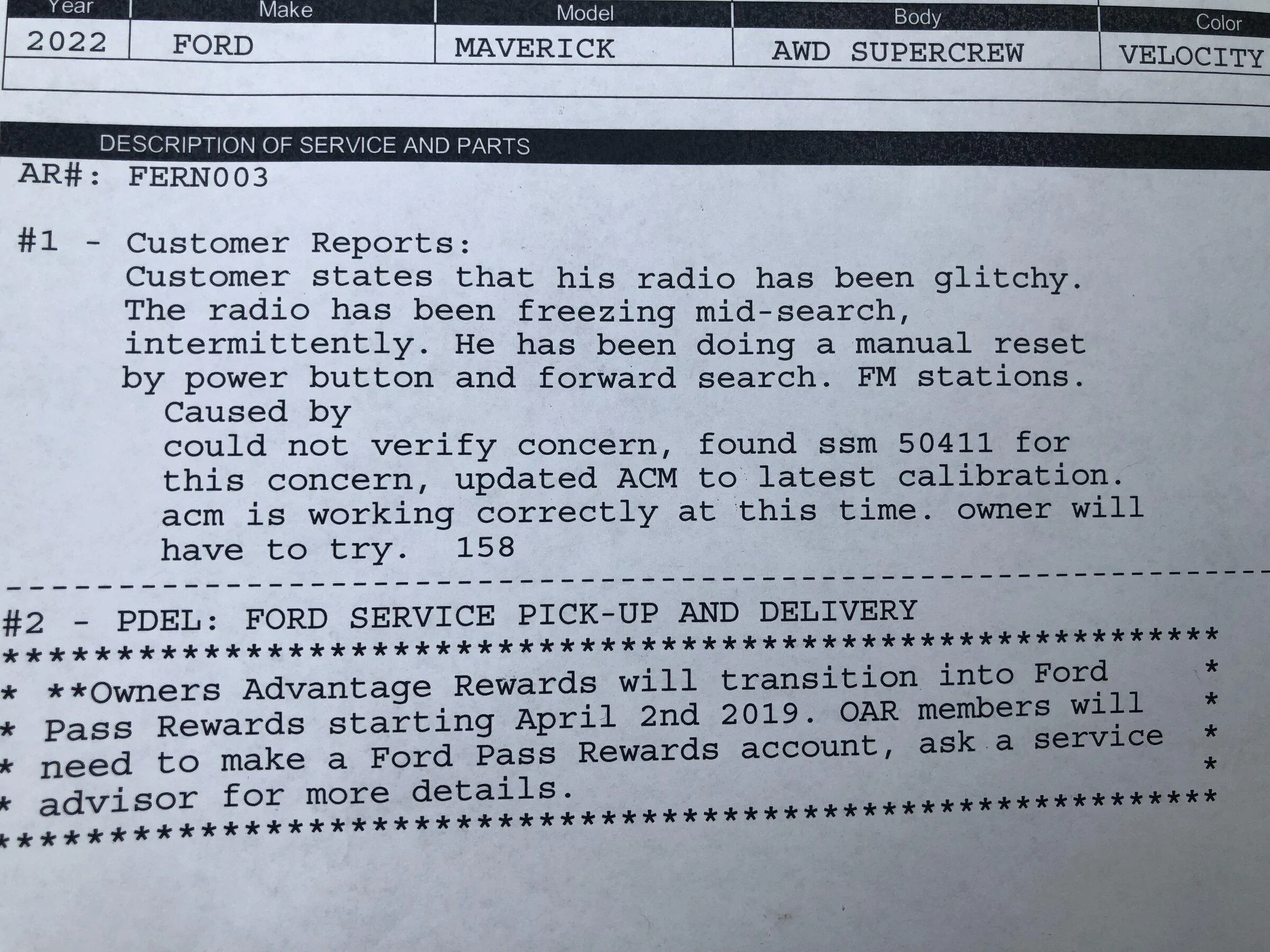

Appears to be fixed. Took local Ford all day to load the update. See attached. Have scanned for stations a few dozen times without a glitch. Funny Ford must have missed this in their field and lab testing. I guess testers don’t listen to FM radio (0r satellite:)

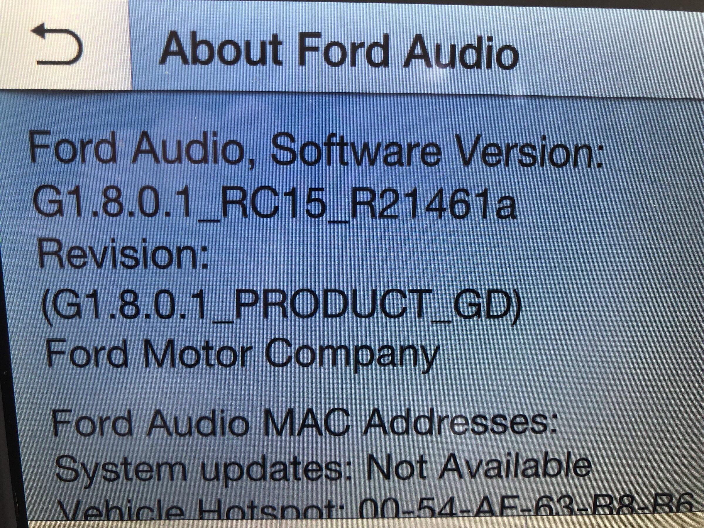

Looks like the update is to the same version I have in my Maverick that was built November 29th. So that should mean that Mavericks built from November 29th onward should have the latest software.
Ford Audio Software:
Version G1.8.0.1_RC15_R21461A
Revision (G1.8.0.1_PRODUCT_GD)
My Maverick was built on 11/29, delivered on 12/13 and I last checked for updates on 12/17. At that time there were no updates available.

I am assuming that the update would show up in this software version since this is the only software information that I can see and was after the fix. I think my build date was 23 nov. was made clear to me and other posts that only the dealer can make. I never saw an update as available when I checked at home. Didn’t take a picture of the version that. Has originally.

I think the software version is the same, the calibration is newer.
