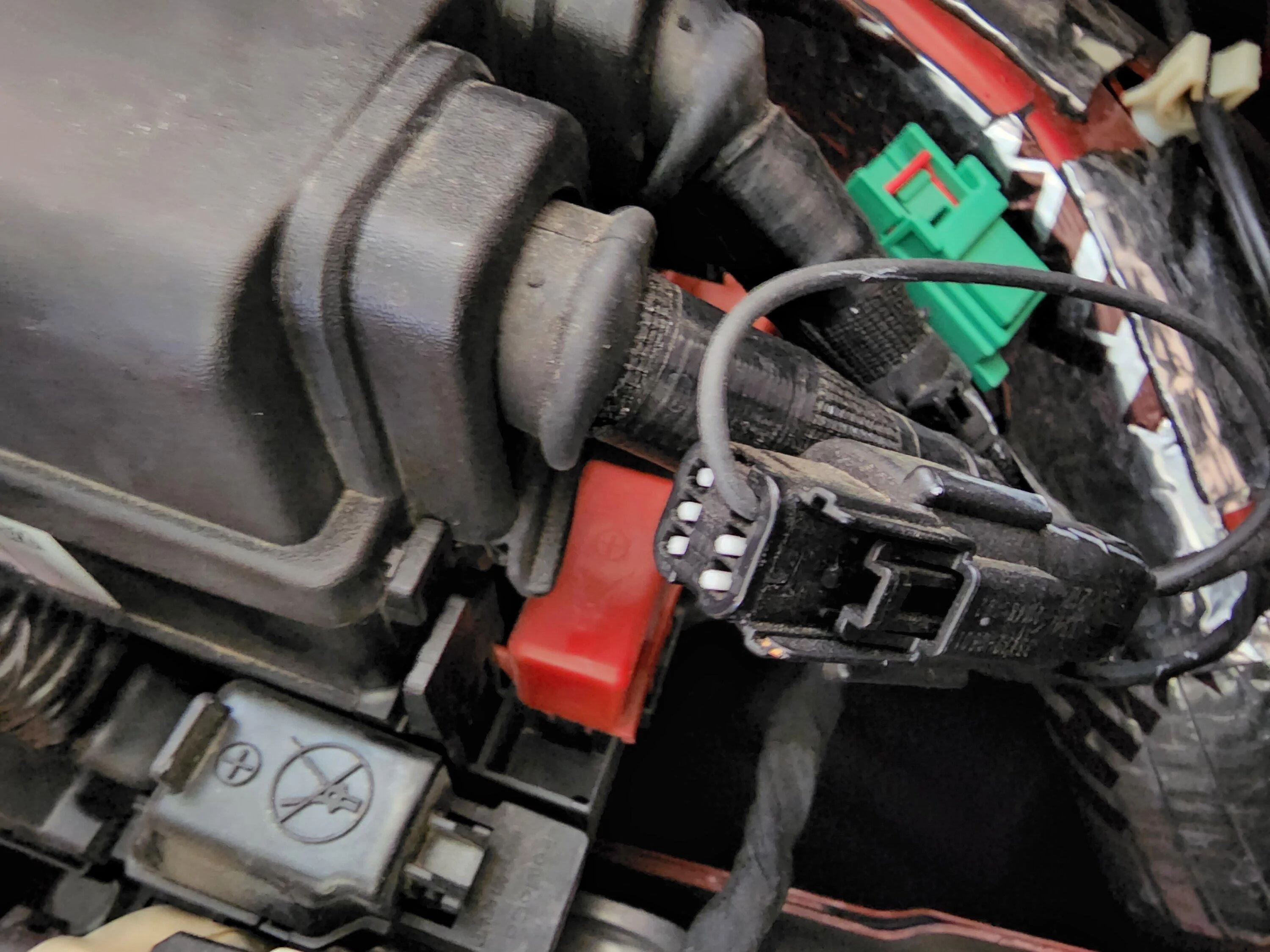

Monty, that stud is either threaded or at least serrated, i didnt check what size threads though, i would think a 6mm or 8mm.
You can always use the positive battery stud that enters the fuse box on the engine side.
We are talking some amps here so any mods/add ons need a fuseable link or some type of fuse.

With the hybrid battery cable in question, i went under the hood to make sure i knew exactly how to energize the Mav. I recomend anyone who hasnt checked out where/how to connect jump box to do so by the owners manual.
What i saw on mine is the positive connection is on the front side of the fuse box under a red plastic cover. The red cover is a little tough to remove and access is to the engine side. I would recomend at least identify if not remove the red plastic cover, just in case we need to jump it. Hope this helps anyone out there in the hybrid family.

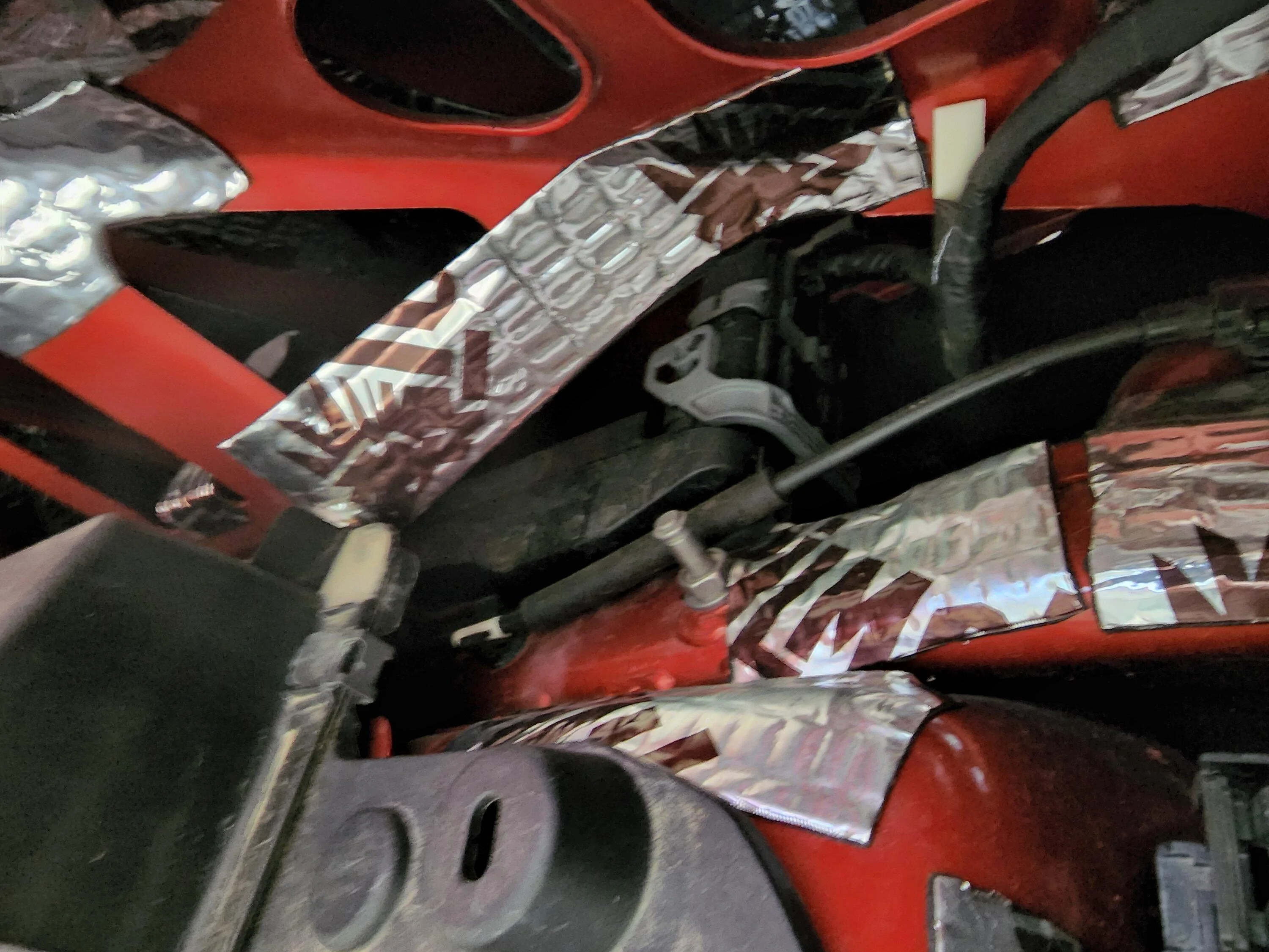

Wax..no seat of the pants..i did alot of tap tap..this was like my 10 vehicle i have done. So i have a basic knowledge of audio systems and more importantly the environment which the audio is to perform. Theres 2 sides to the audio 1) what everyone does..improve the OEM equipment
2) what everyone misses..improve the audio environment to make 'dead' space, including bass traps and extended use of CCF. This one does more for me. Ever hear were the guy puts 2000w into 4 12"s and everything rattles..panels..the entire car.
