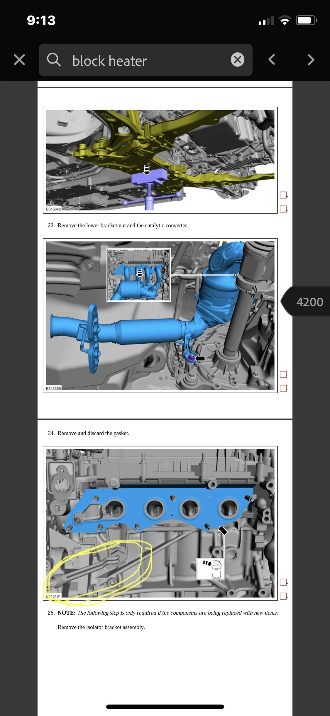

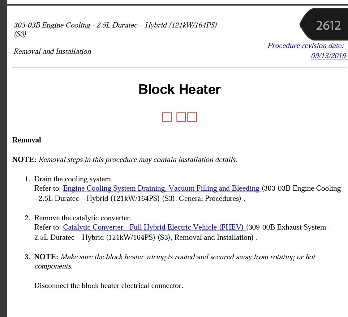

Part number JX6Z6A051D
Best I can find is about $84 before shipping. Anyone install it themselves? Trying to find where to screw it in but empty handed.
Ford wants like $120 for the power harness alone. Anyone who can wire an outlet knows it's like $20 at the depot.
Can it be a DIY job, yes. Should you attempt it if you have little or no experience working on cars, probably not. First you need to drain the coolant as that’s where the heating element sits and you need to refil it and bleed/burp the system. Second it’s not an easy spot to get to without dropping some exhaust components. There’s a plug there that you need to remove that was factory installed and screw in the block heater.
