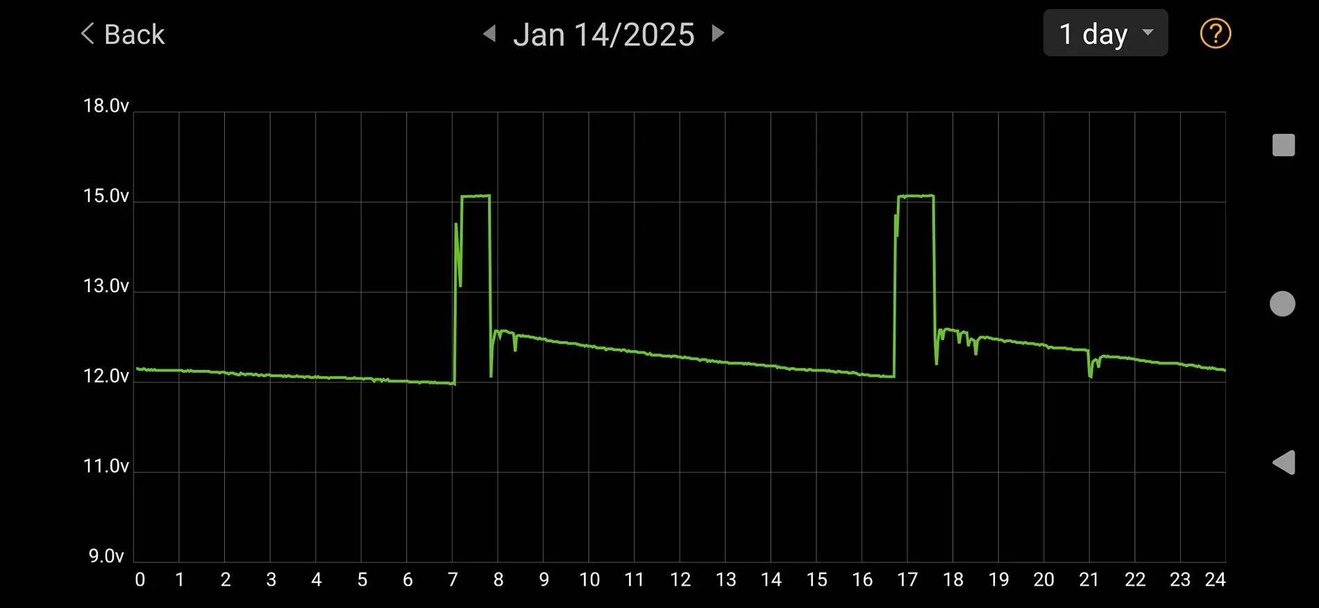

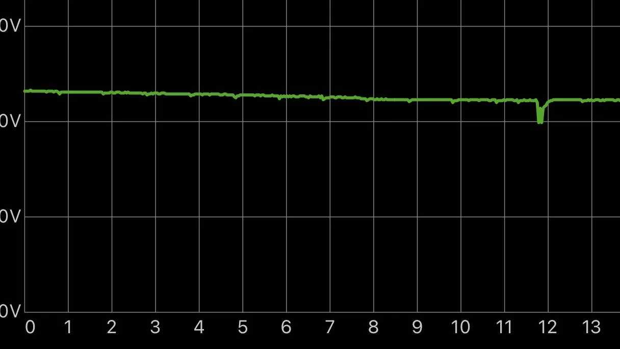

Hadn’t thought about that rather obvious cellular possibility! I’ll try just turning off the connectivity, and see if hourly voltage dip still happens……..Bill P

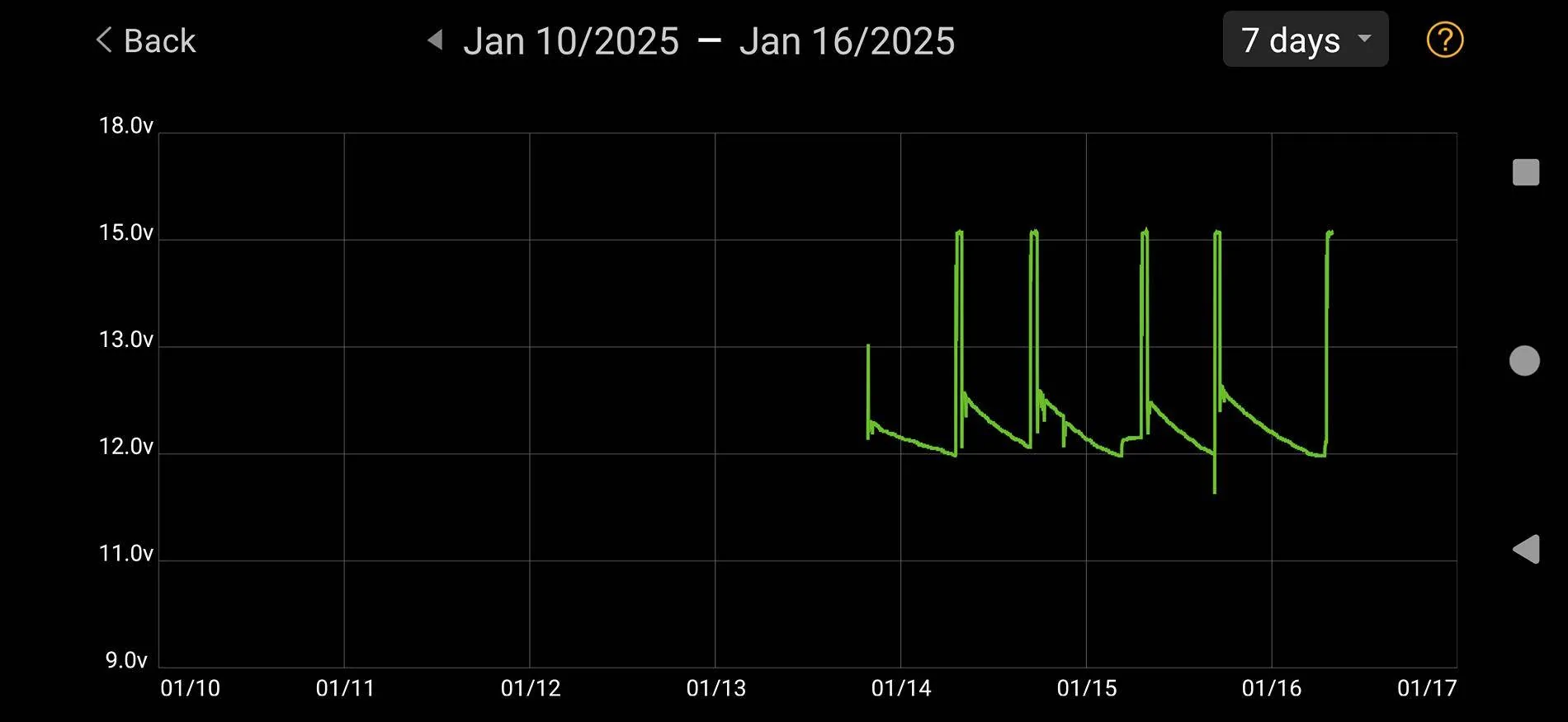

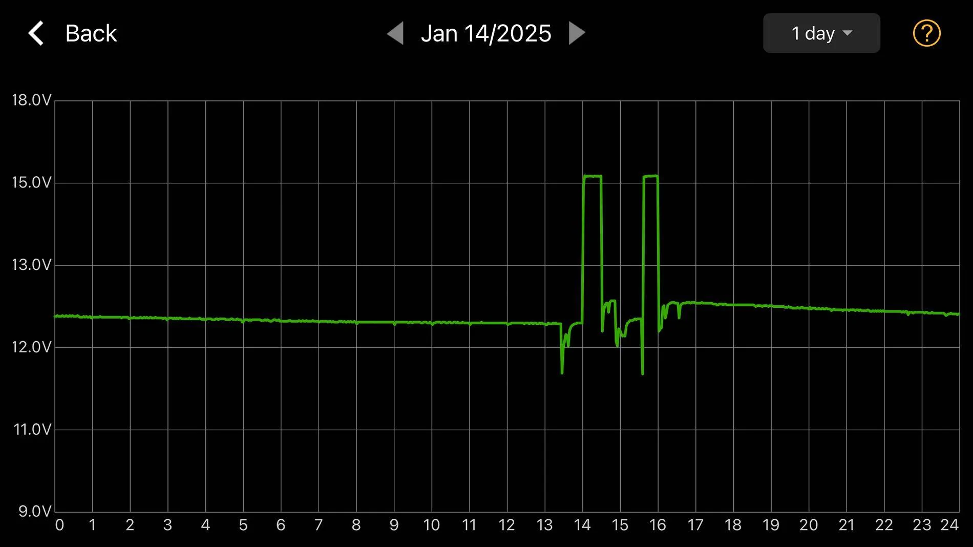

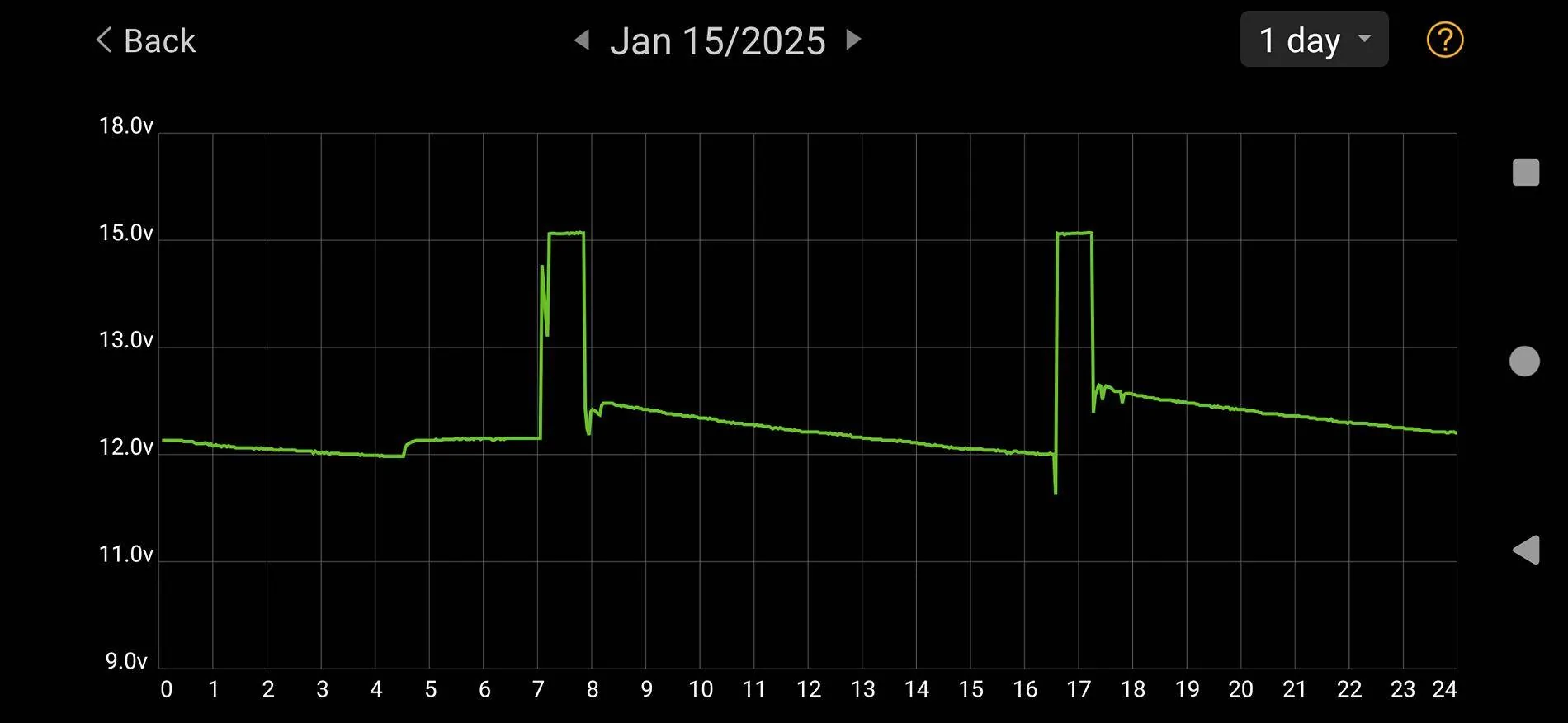

update 1/17-
Graphing before turning Connectivity off:
After turning off: still slight variation, but no constant 1 hr dips
So, this tells me, what we’ve known all along, it’s an ongoing draw on the battery
And because the PCM isn’t telling the DCDC to charge at a rate between 4.5 and 13.5 amps…….., the battery never is able to achieve a high SOC !
Of course you could always take a 12 hour ride, as Ford suggests “ drive more”, to allow that 1 amp charging to do something over a longer time! Bill P
