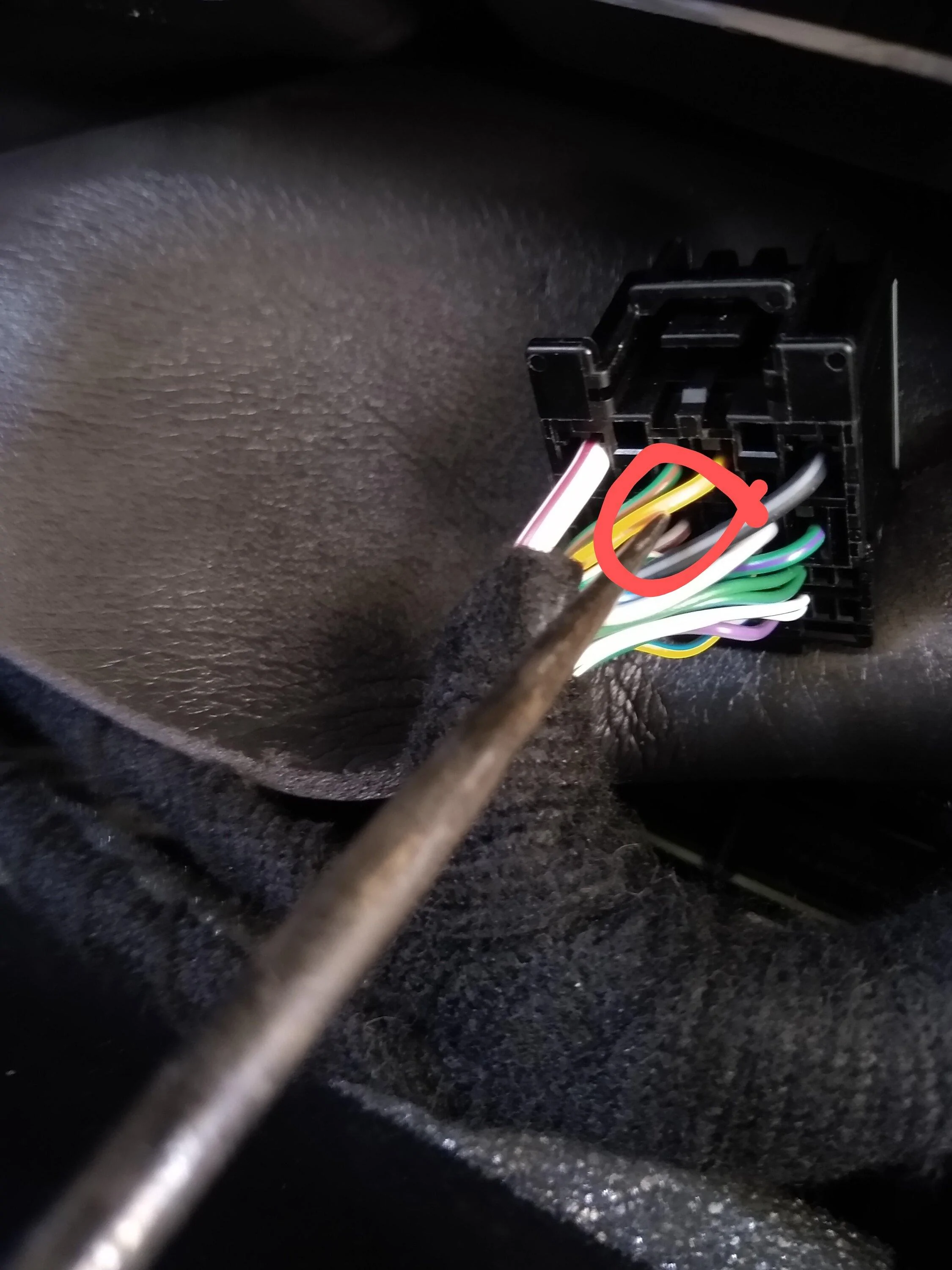

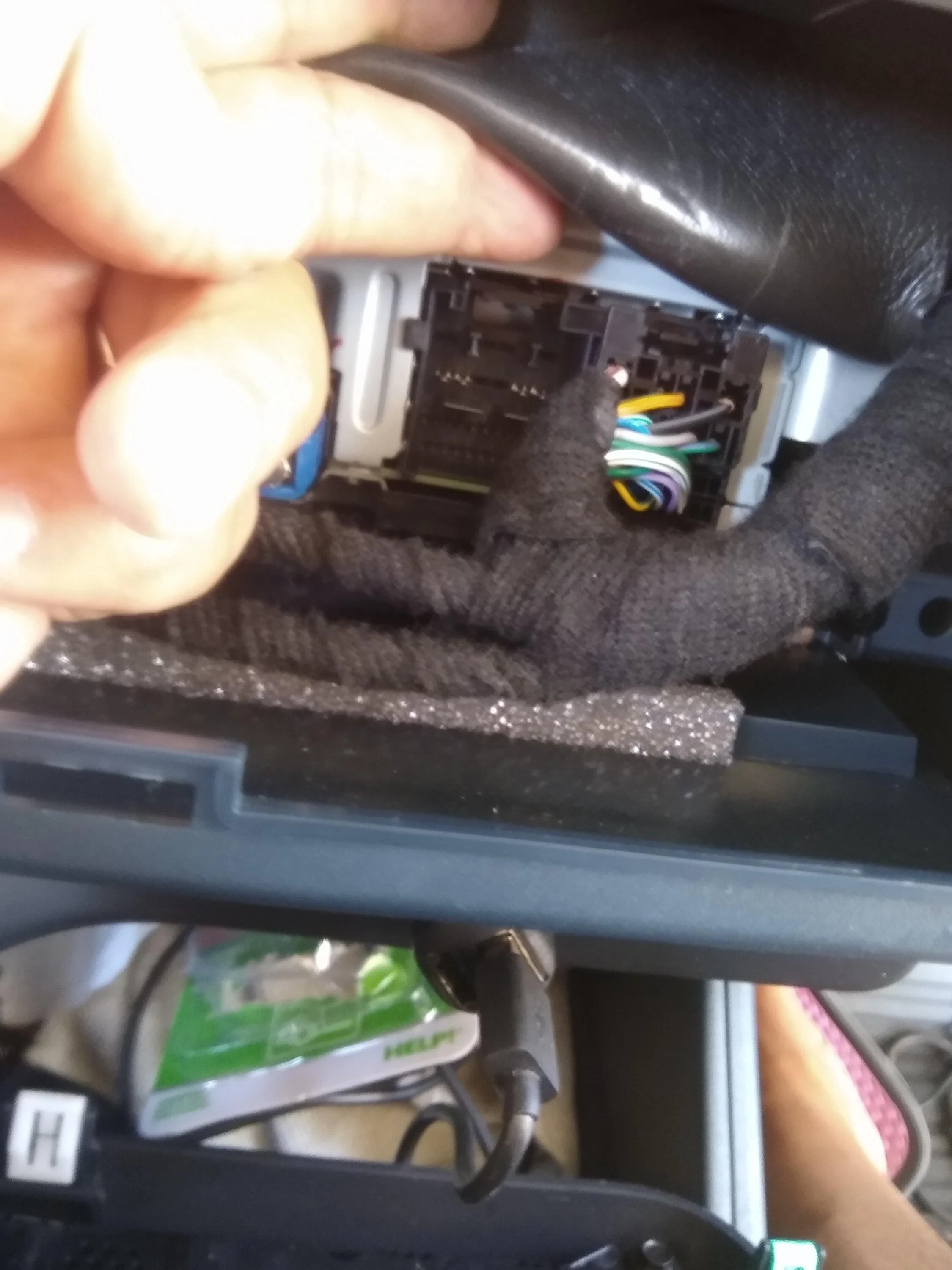

Mavito, I connected the sub remote to the radio harness yellow wire. It comes on with the head unit and turns off at 30 second - 3 minutes after exiting and locking the truck. I used a simple screw tap. The radio harness is accessed by removing the AC vent cover and lifting the black foam cover to expose the plug. Hope this helps.

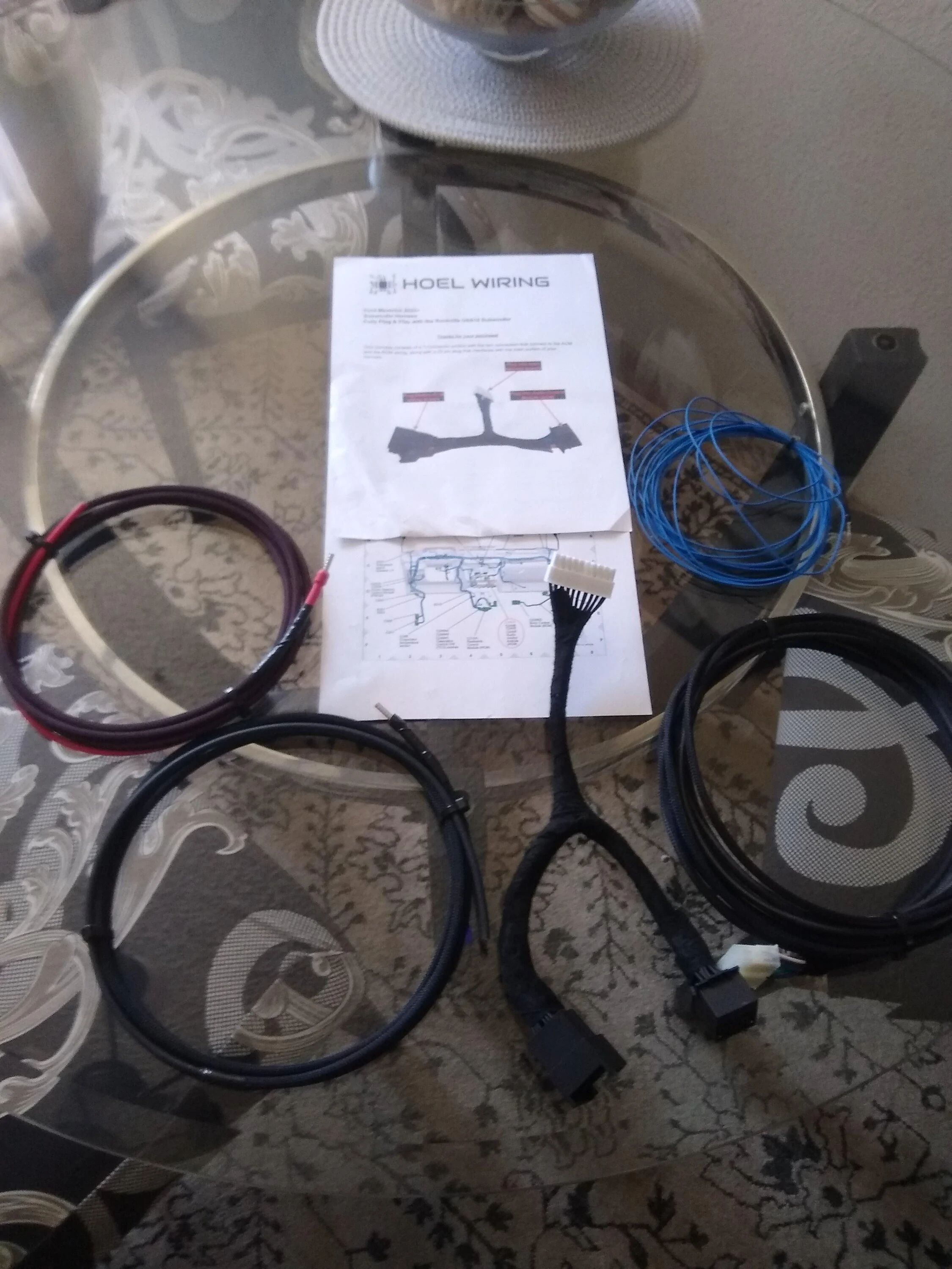

Mavito, you can purchase the plug and play wire harness from Gus at hoelwiring.com and you won't have to splice into your speakers as another option. Hope this helps.
