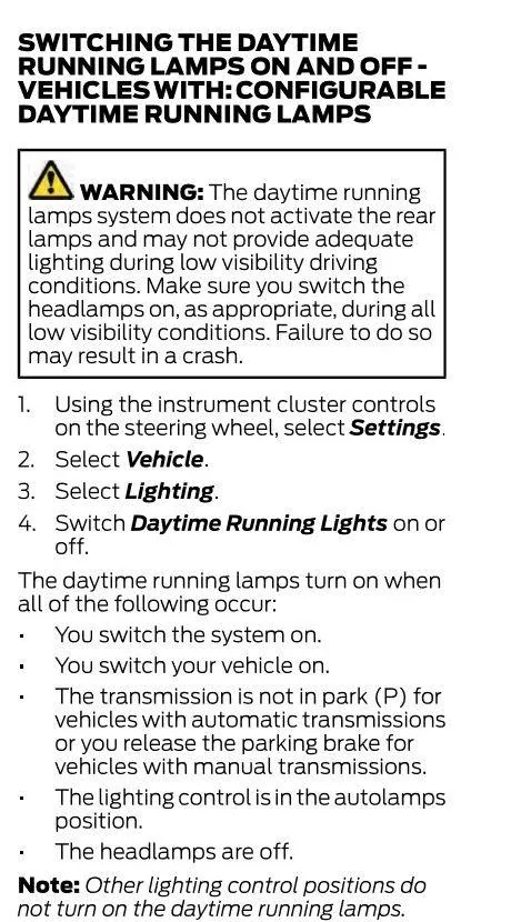

Sorry I meant to say the lights are always on no matter day or not daytime running lights. So the lights are bright.It's an option in the IPC but probably not present on Canadian Mavericks with DRLs being legally required (similar to how fleet orders can spec DRL always on). FORScan could enable the option.
Do Canadian Mavericks have configurable daytime running lights?Page 95 of the owner's manual. Relevant section below:
Our Cdn cluster does not even have those options.Do Canadian Mavericks have configurable daytime running lights?
Good of you to not only help out a member with a solution, but also to remind us all to . . .Page 95 of the owner's manual. Relevant section below:
