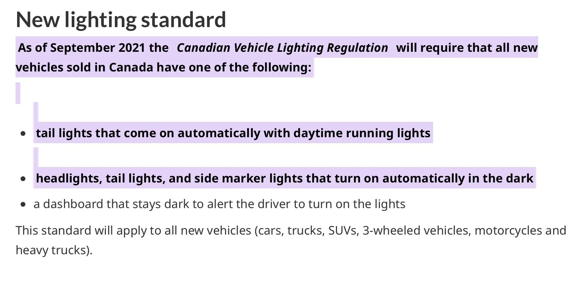

I just found out during the last hour that daytime running lights (front and back!) have been mandated on new vehicles sold in Canada starting in 2021. So when my Maverick arrives I can expect front and rear daytime running lights?

I think I jumped the gun a bit.

All cars sold in Canada have front DRLs that cannot be turned off. They are on when the car is on. The new standard means that one of those needs to be true on every car sold in Canada
  • the tail running lights are always on with the front DRLs (car on = lights on, my Smart Fortwo is like this),
  • the headlights/rear running lights turn on automatically when it is dark out (which is the case for all Mavericks, my XL with no add-ons has this), or
  • that the dash stays dark until the driver turns on the lights (my 2012 Corolla was like this).
The major issue that we have is that many vehicles have lighted dash consoles that are lit when the car is on, but not necessarily if the headlights/tail lights are on (I know the Civics that don't have auto lights are like this, and many more). You notice this when it's dark and the driver in front of you hasn't turned their lights on. This is because their dash is lit and they don't notice that their lights aren't.
The goal then is to reduce the number of vehicles on the road in the dark without lit tail lights.

Yup, and it's about time. Cannot count how many times I see people driving around at night with just DRL on and nothing else.
