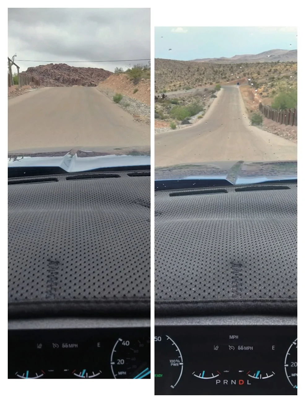

🤔Hmmm
I drove down the road aways found a nice Hill. I tested both up and down I recorded the uphill portion.
I put the Maverick in park. You can tell by the gear selector. Took my foot off the brake, you can tell when I did that, because the Maverick rocked a little bit when it locked into the gear.
I even open the door parking brake never came on and the red brake light never illuminated.
