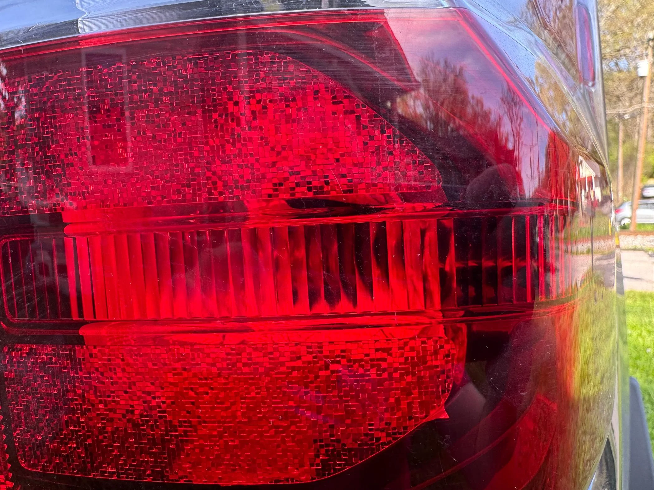

Can’t you just fill the tail lights partially and do the sides first then flip and do the rest without filling all the way so the reflector cups never get removed? This would seem to get the look while leaving them fully functional without sacrifice… to anyone that’s done the zep trick, could this work?

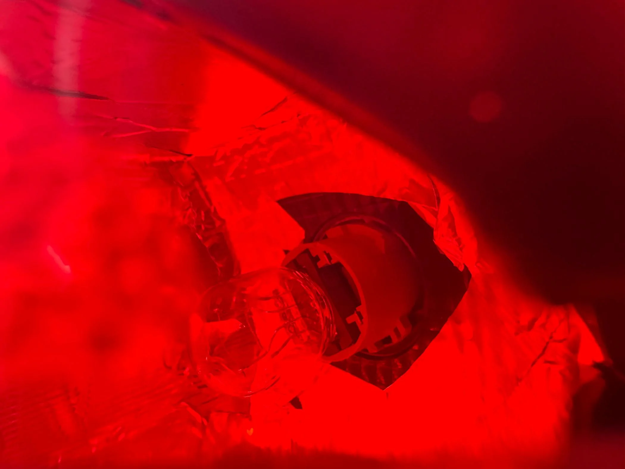

I tried filling them up only partway up to the lip of the reflector on mine and it did leave some chrome in the base where the bulb sits, but I think either the fumes or whats left as it was being rinsed were enough to strip most of it. I just went back after and covered the cup with silver hvac tape.
how did you accomplish this? small tape pieces thru the holes or did you take it apart?? any pics of final product?
swerver15
Jan 25, 2024
Chattanooga
24 Maverick XLT
Yes, I cut pieces and carefully put them in through the hole, it was a pain to do but I wanted to. Unless you get right on top of it you cant really tell. If you get right on it you can see where I couldn't angle enough
