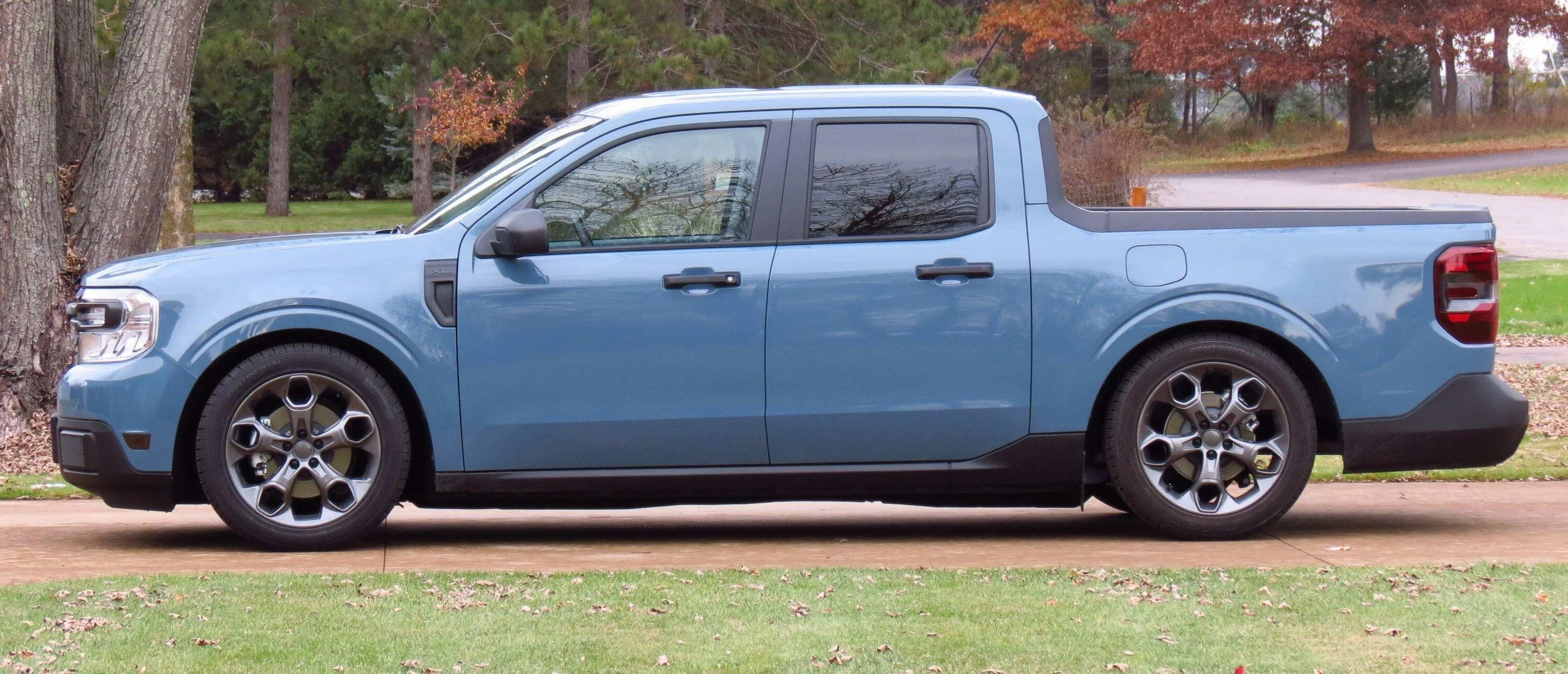

I have Sillver's coilovers. They're not cheap and they're not just show. I've been super impressed with them and had great results so far. At a bit more than 3/4 of their standard model's max drop, I measure the truck being 5" lower (I measure at the wheelwell lip).
Ford Maverick How low?  AutoX, height vs avg track width truck1-jpg

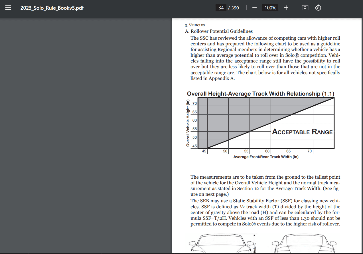

Truck dimensions can be seen on ford's website, and that is what they would refer to, and if i want to compete in it, i will have to prove it meets the rules.. because as stock it would not pass tech. I've been running with the same orgs for 10 years, and these are the rules we follow. This is the same reason the fiat 500(non-abarth) and the ford fiesta (non-st) are not allowed to compete if not lowered.
our local clubs use scca rules and guidelines and it's in the rules:
https://www.scca.com/downloads/66191-2023-solo-rule-bookv1/download
Ford Maverick How low?  AutoX, height vs avg track width 1699883227971
