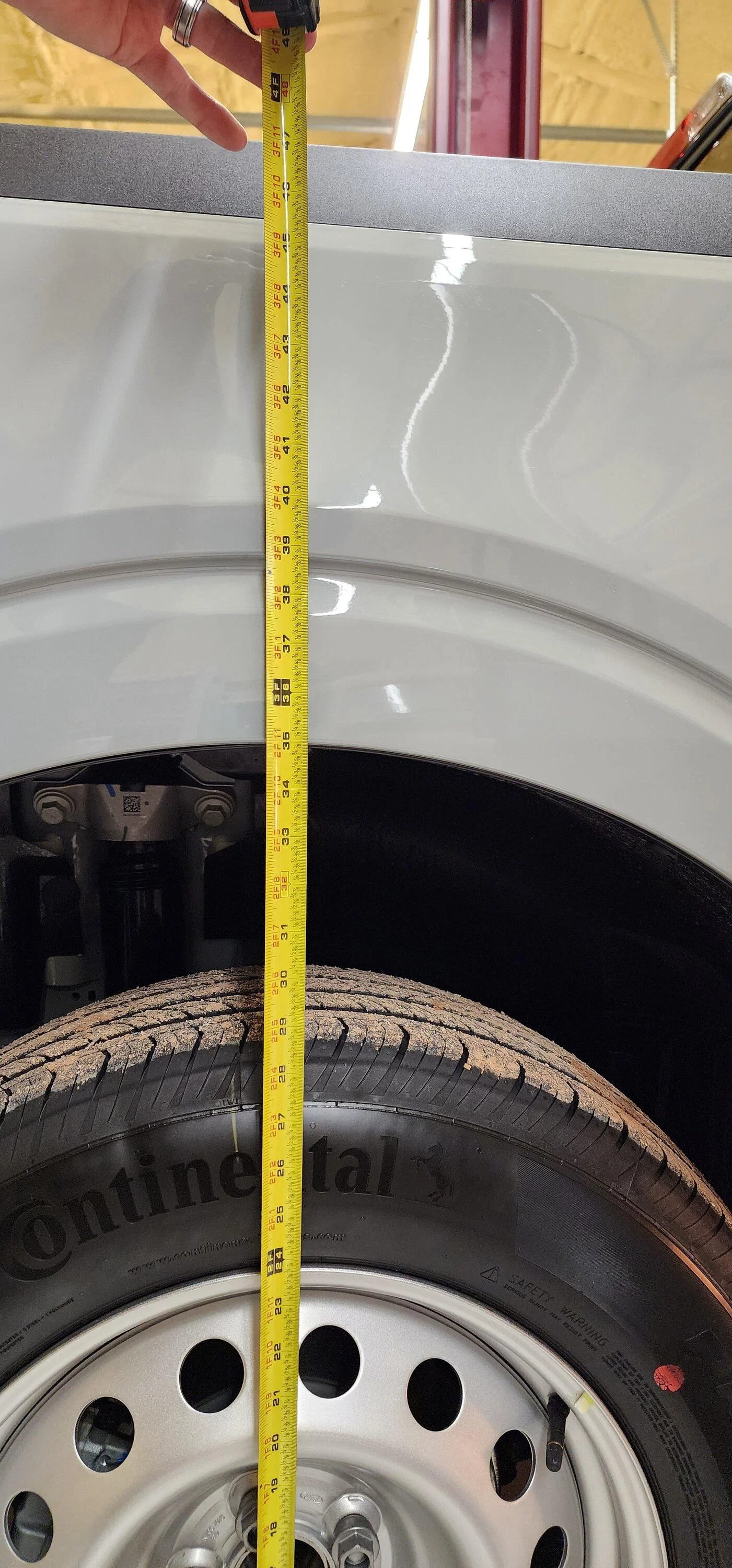

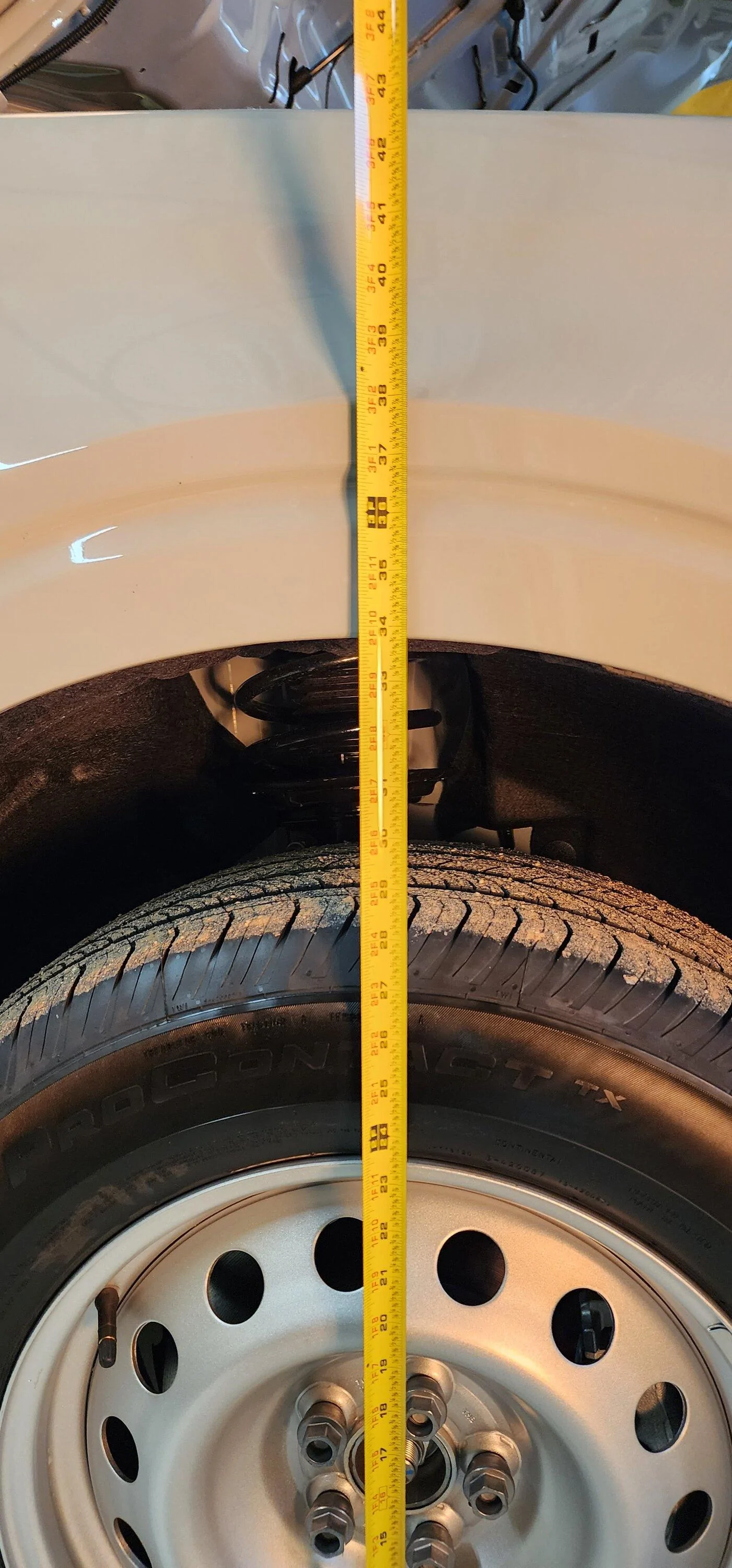

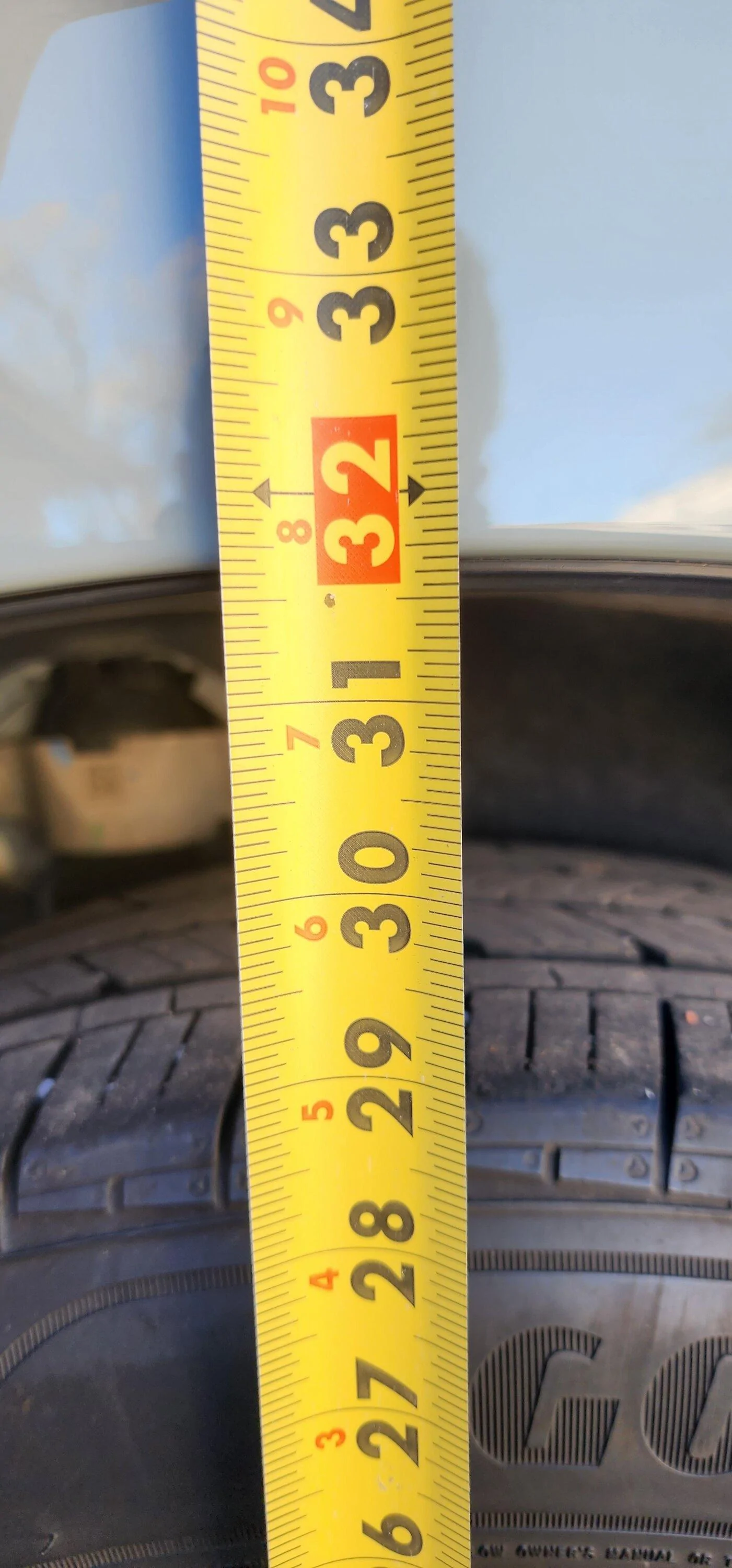

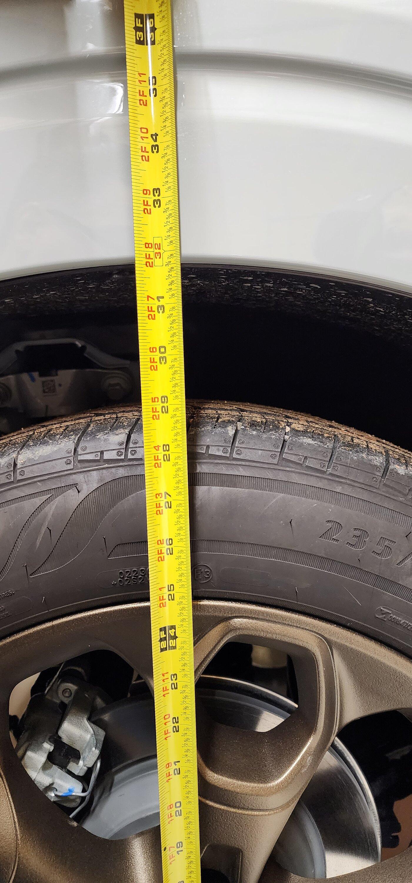

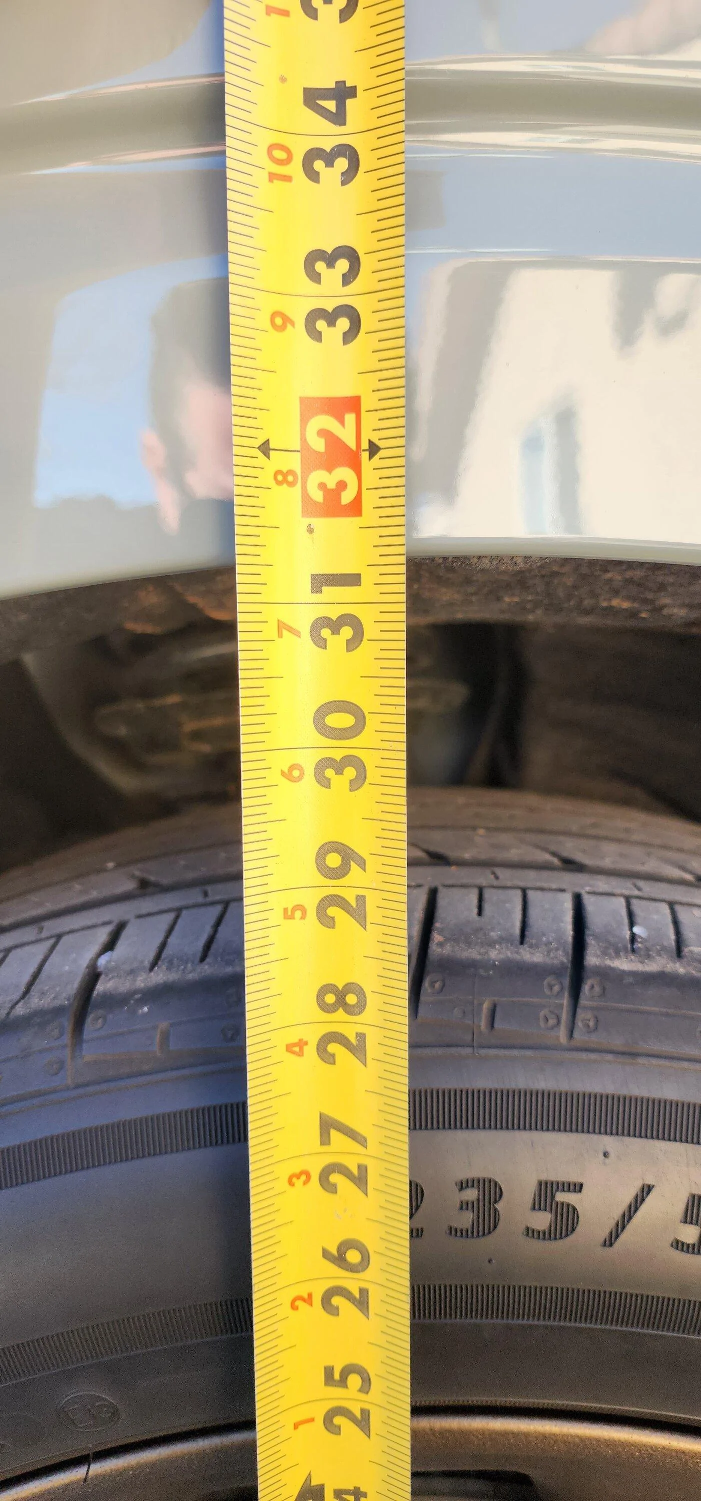

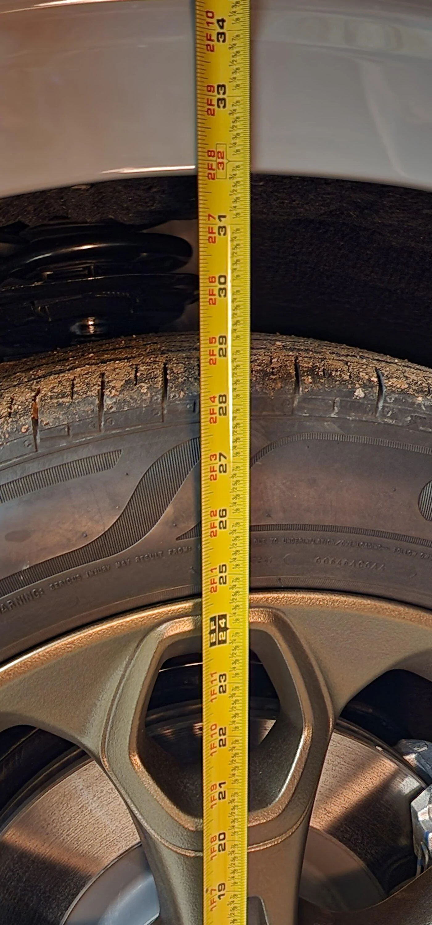

Copied this from my build thread in hopes others may find this helpful. Link in signature.
I've put 2900 miles on my '23 since I lowered it on 12/31. I measured the amount of drop again today and the springs have settled a bit. I'd still like it to come down 1/2" more in the front.
Front stock:
Front dropped on 12/31:
Front dropped after 2900 miles on 2/18:
Rear stock:
Rear dropped on 12/31:
Rear dropped after 2900 miles on 2/18:
One thing I mentioned earlier in this thread, my 235/55R19's are SLIGHTLY taller than the stock 17's so the amount of drop is actually more than shown on my tape.
Front: 34 13/16" stock to 31 13/16" dropped.
Rear: 35 13/16" stock to 31 5/8" dropped.

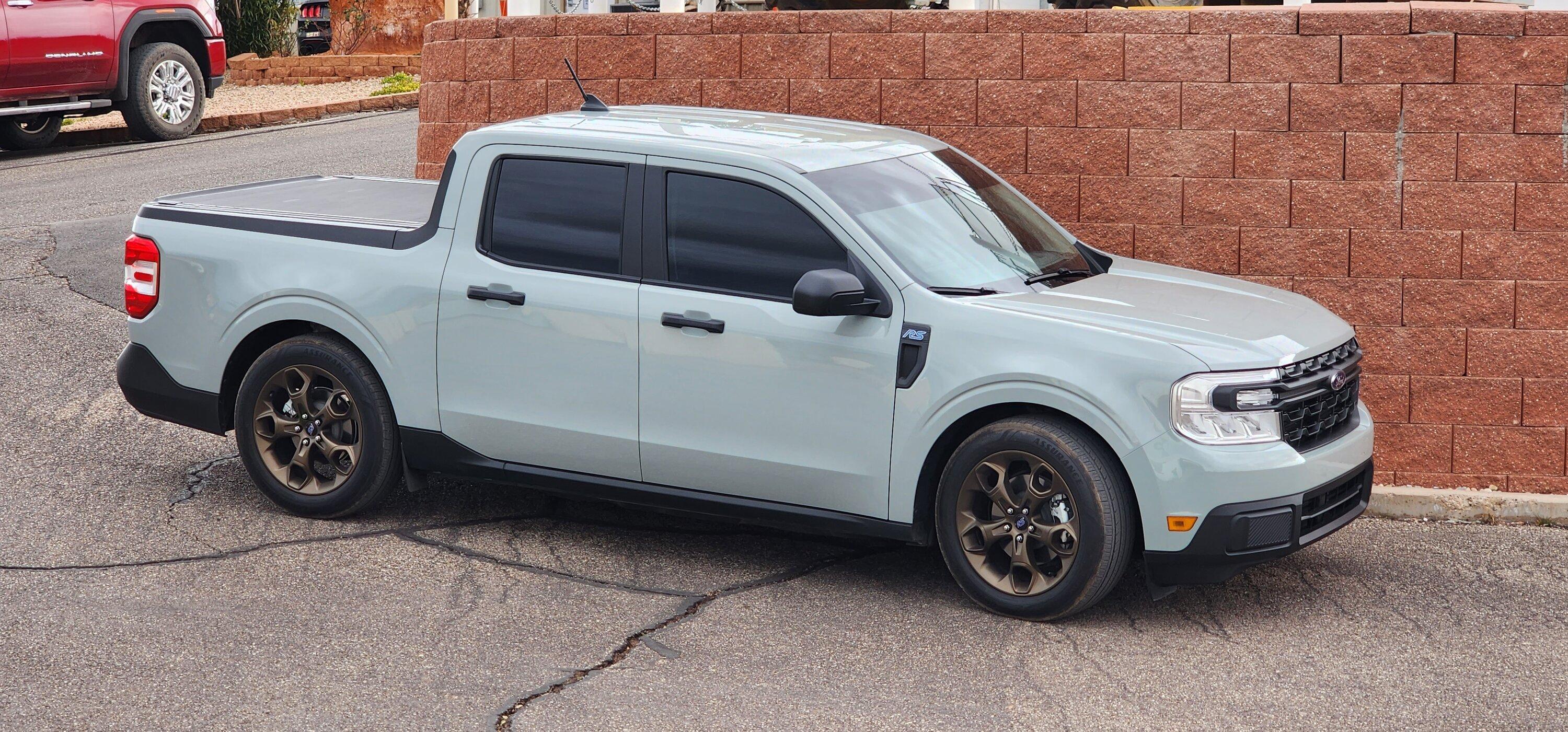

I'm sharing this so others have an idea what to expect - roughly a 3" front and 4 3/16" rear drop.
I hope this helps others. Super happy with the ride and handling. Thanks Eibach, great R&D and product!

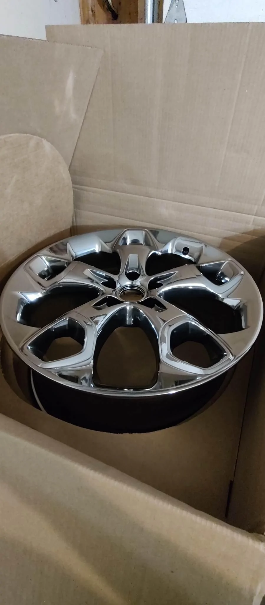

Thank you for sharing all of info and pics, I'll probably be referencing this for my own. Those wheels are even the ones I'm wanting to go with, but probably a chrome type finish. That wheel design always catches my eye on the Escapes.

I remember the first time I saw the wheels, I knew I had to put them on SOMETHING one day, LOL.
I will advise though, my sandblaster had a NIGHTMARE removing the factory coating to get to the bare aluminum. Take that into consideration, as they're SUPER labor and material intensive.
I preferred powder but had I known I probably would have chosen paint.
