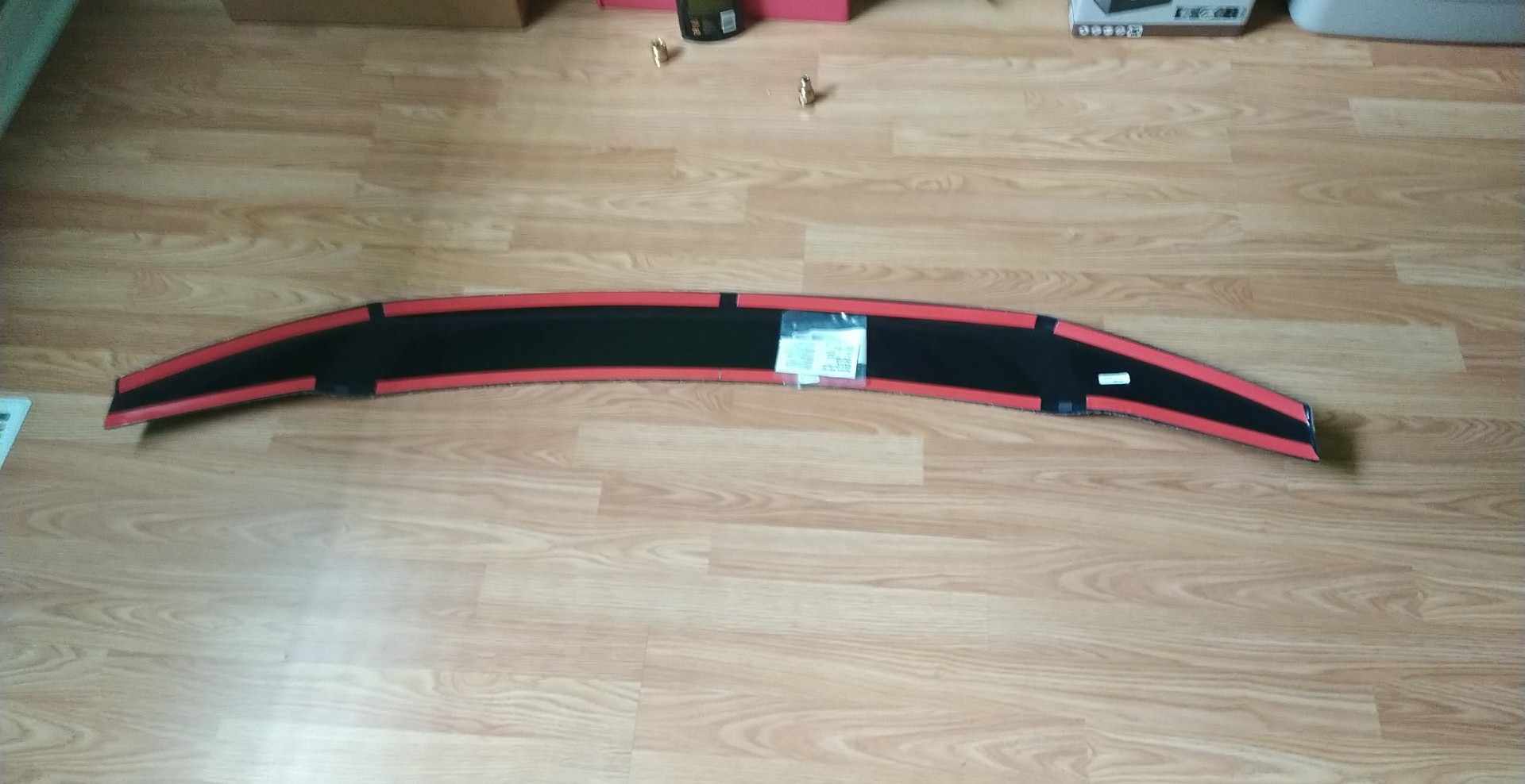

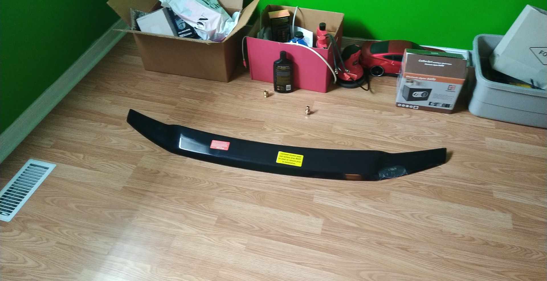

Please take a look at the attached pictures.
Are there any major concerns with the stick on type?
When you dry fit the deflector apply some blue painters tape along the top edge so you'll know where to stop applying the adhesion promoter on the hood. ....
good luck

Does this adhere under the hood or on top of the hood? It is in direct contact with the hood? I had one on another vehicle and it faded in a few years. If I ever have to remove it, I wander if vibration will wear thru the paint at all, and if adhesive tapes will damage the paint on top of the hood.
good luck
Yea. That is never coming off without damaging the paint, and the plastics tend to fade and dull over time. Not sure about AVS, but another brand I had once did.

They can be removed with heat, slow pressure and finally adhesive remover w/o damaging the paint. The video I posted is a representative sample, the Ford accessory is manufactured by Lund and installs the same way. Lund carries a lifetime warranty....
