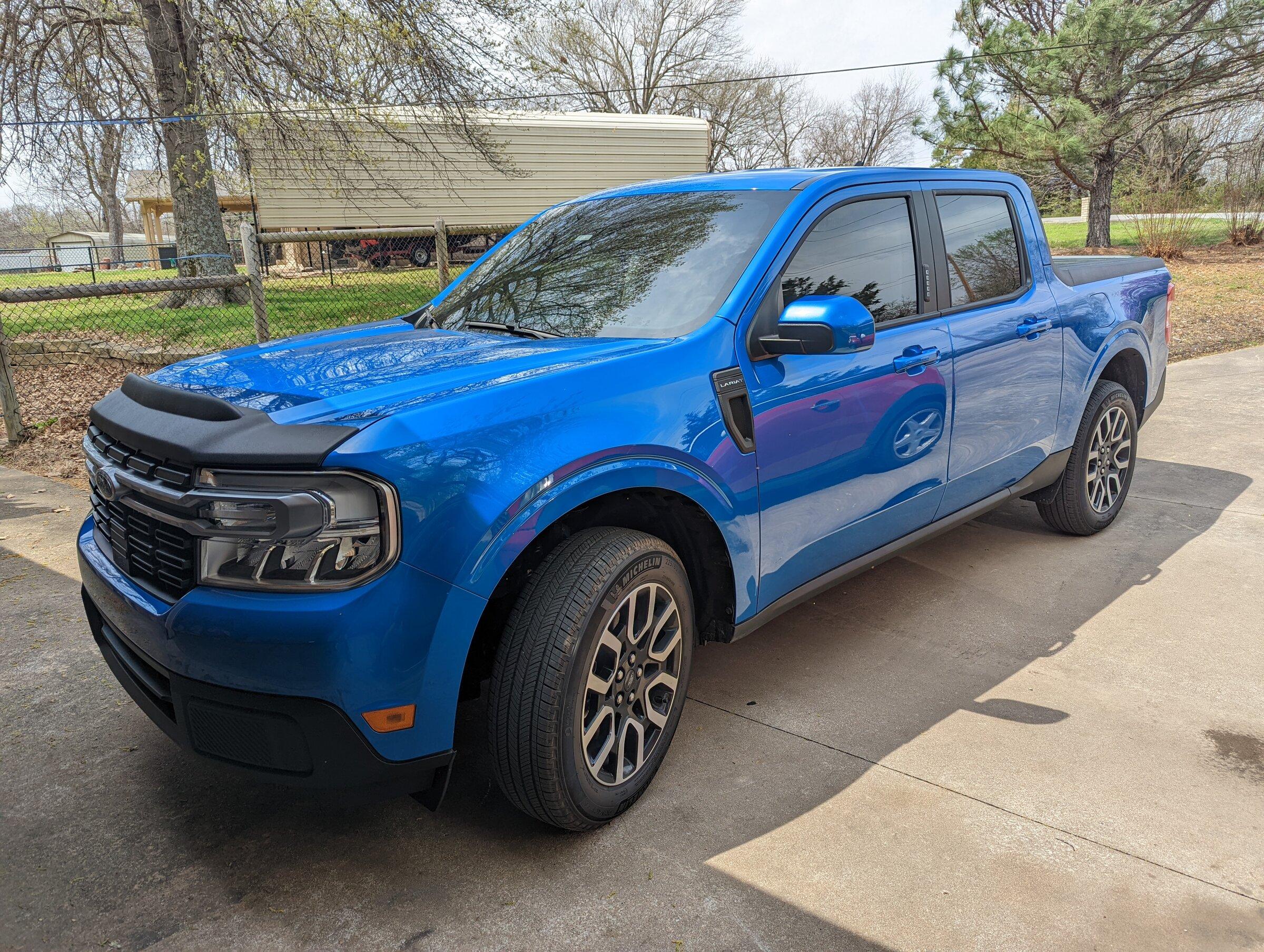

I wasn't going to get one, but then had a rock hit my windshield today and crack it. While I was at the dealer, removing a bolt from my tire from this morning as well, they had the VNZ6Z-16C900-C in stock that seems discontinued online. Used $89 in Ford points and just installed it myself.
If it helps at all with rocks/bugs I'll be happy. Doesn't look too bad, but would prefer it in Velocity Blue.

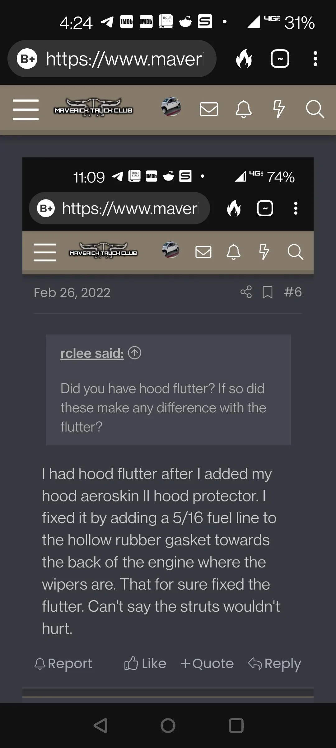

Another fix is go out to autozone and buy a 1/4" fuel line, but that didnt make the flutter go away entirely for the other Mav owner. (this is a fix ford recommends!)

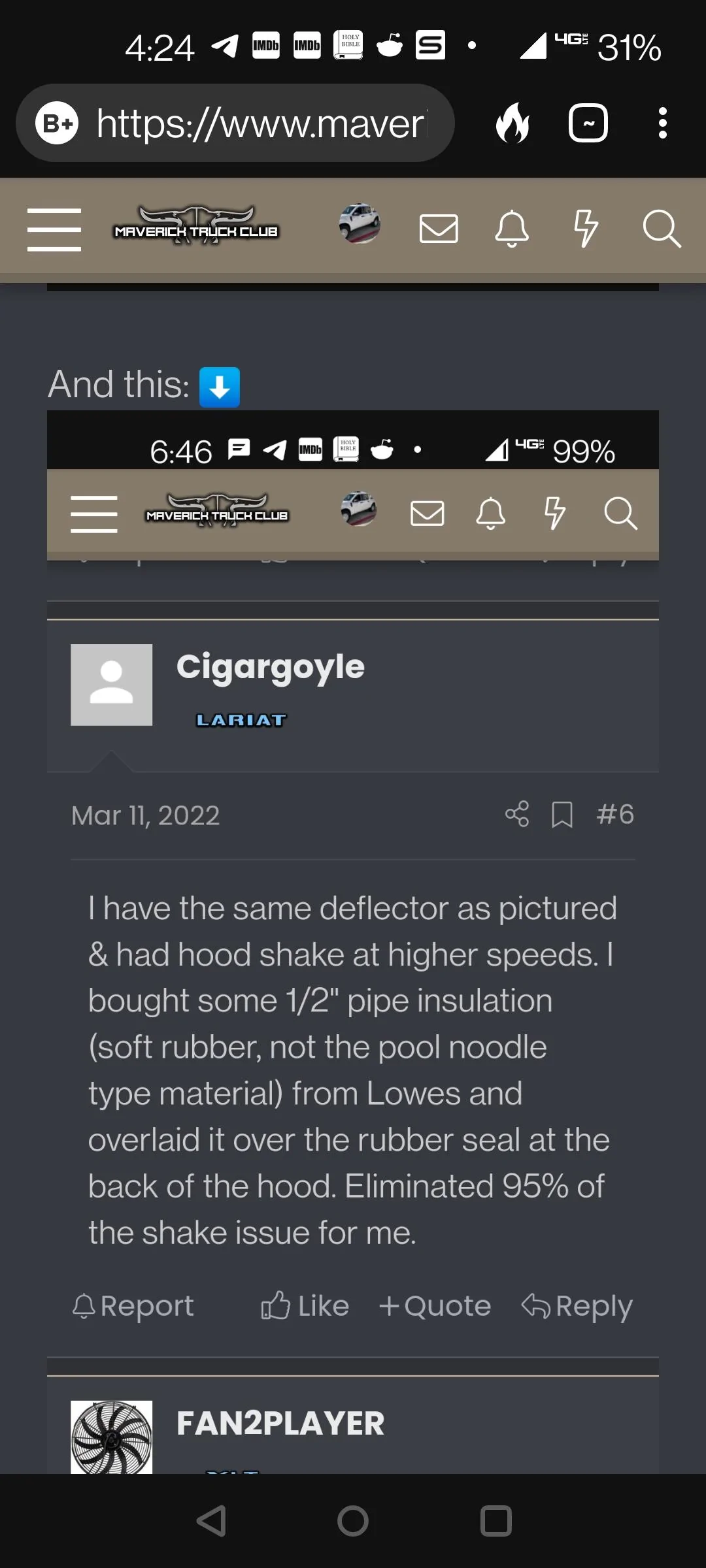

The only reported fixes have been, take off the matte deflector (that some speculate was removed from Ford's website because of these issues), or buy something like this:
Ford Maverick Hood deflector recommendations? 1649793430830

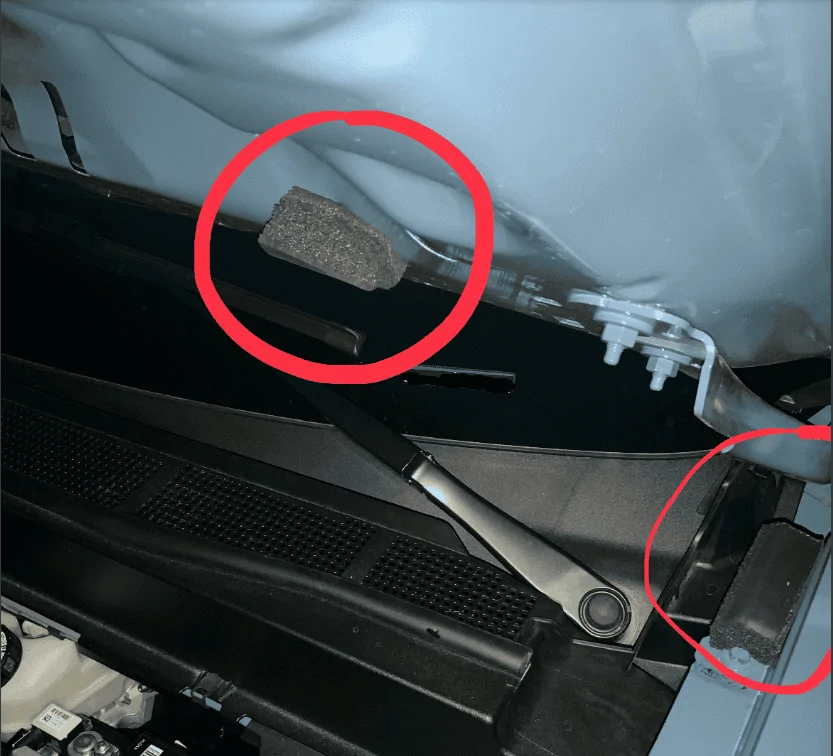

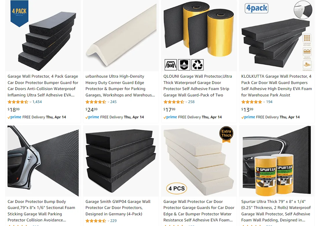

Or ghetto it up by buying some garage wall protector and do something like this (forum member said it made a big difference, but not that it fixed it entirely):
Ford Maverick Hood deflector recommendations? 1649793491551
Ford Maverick Hood deflector recommendations? 1649793770826
If I missed another fix, then someone let me know. Anyway, figured Id summarize what I found in the forums when searching for a fix for the hood flutter, primarily noted by owners of the textured hood deflector.

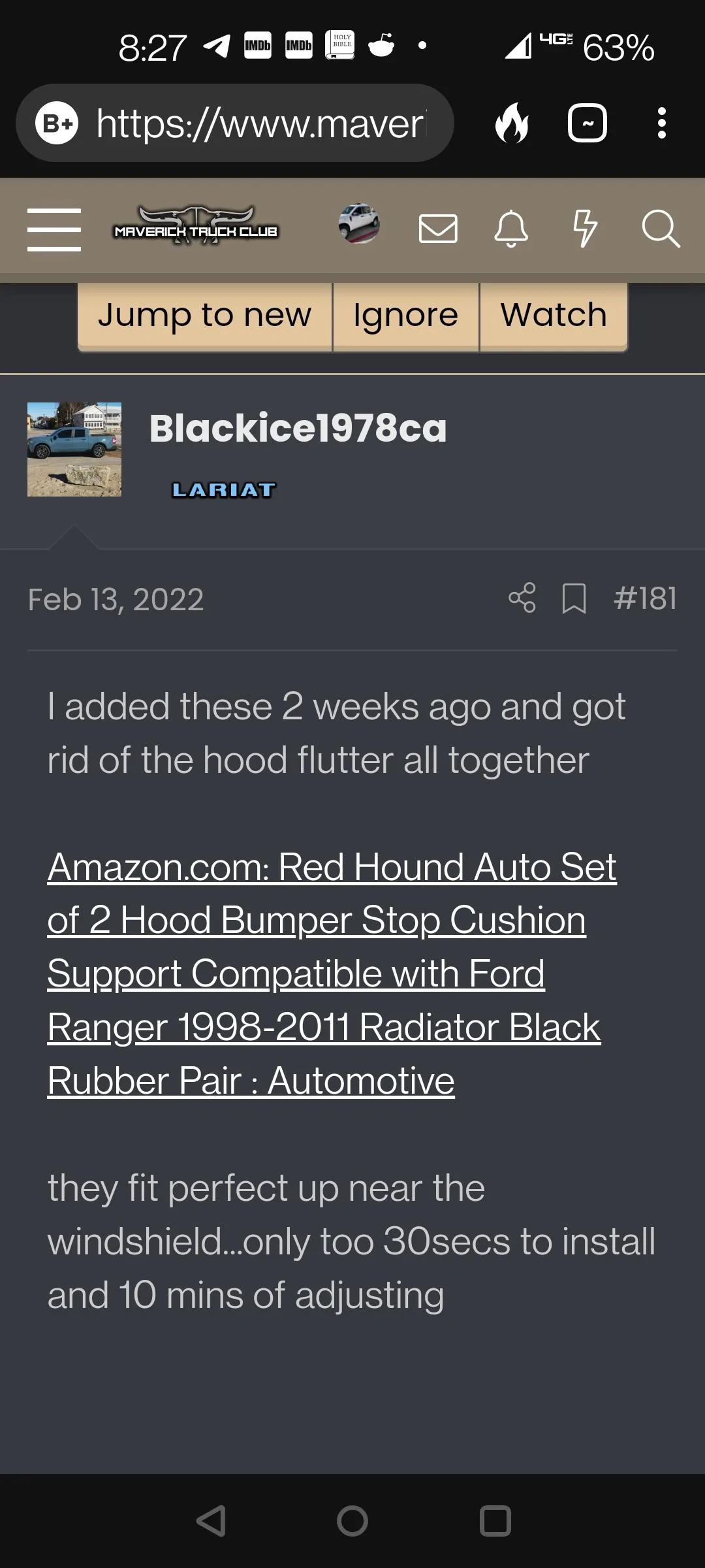

I can't find the original post about the bumper stops, but it seemed like they said it was 100% fix.
Also Rodog800 , who used the kilmat said he tested at 75-85 mph and flutter was gone.

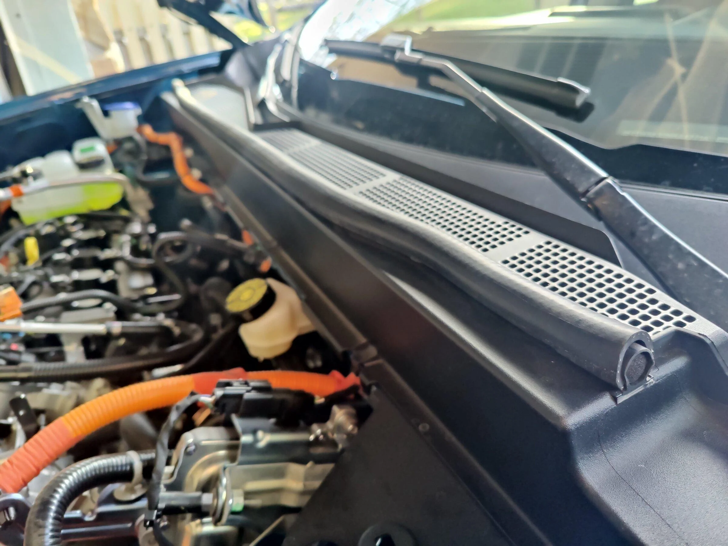

Bought 4ft. of 1/2" heater hose for $8 at AutoZone. Split it lengthwise and put it over the rear hood seal.
Almost removed all the flutter at highway speed. Still a little but it's in the middle of the hood, more like flexing. Could have been there before and I didn't notice.

I found the post on bumper stops.
What I don't like about that idea is all the force is being pushed up on the hood at the very edges, instead of evenly liked the piece of hose does.
It may also lift the hood above the seal defeating it's purpose.

I had the same thought, just listing all the different reports of fixes. So far I think your 1/2 heater hose idea makes the most sense. It would be firmer than the 1/2 soft rubber insulation mentioned above. From the picture you posted it looks good on.
Could you post what exact hose you bought?

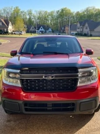

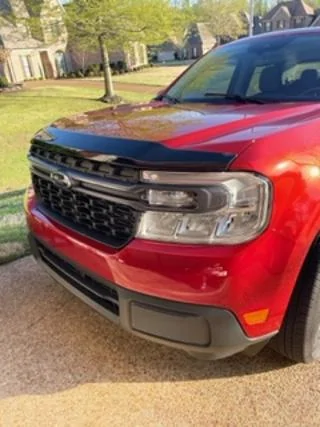

I added the Lund Aeroskin hood deflector today. It looks good but I've not checked for the hood flutter yet. Hopefully it will not be there.
Ford Maverick Hood deflector recommendations? Mav_hood protector_a
I did the hose “mod” today and the hood shake is completely gone!
