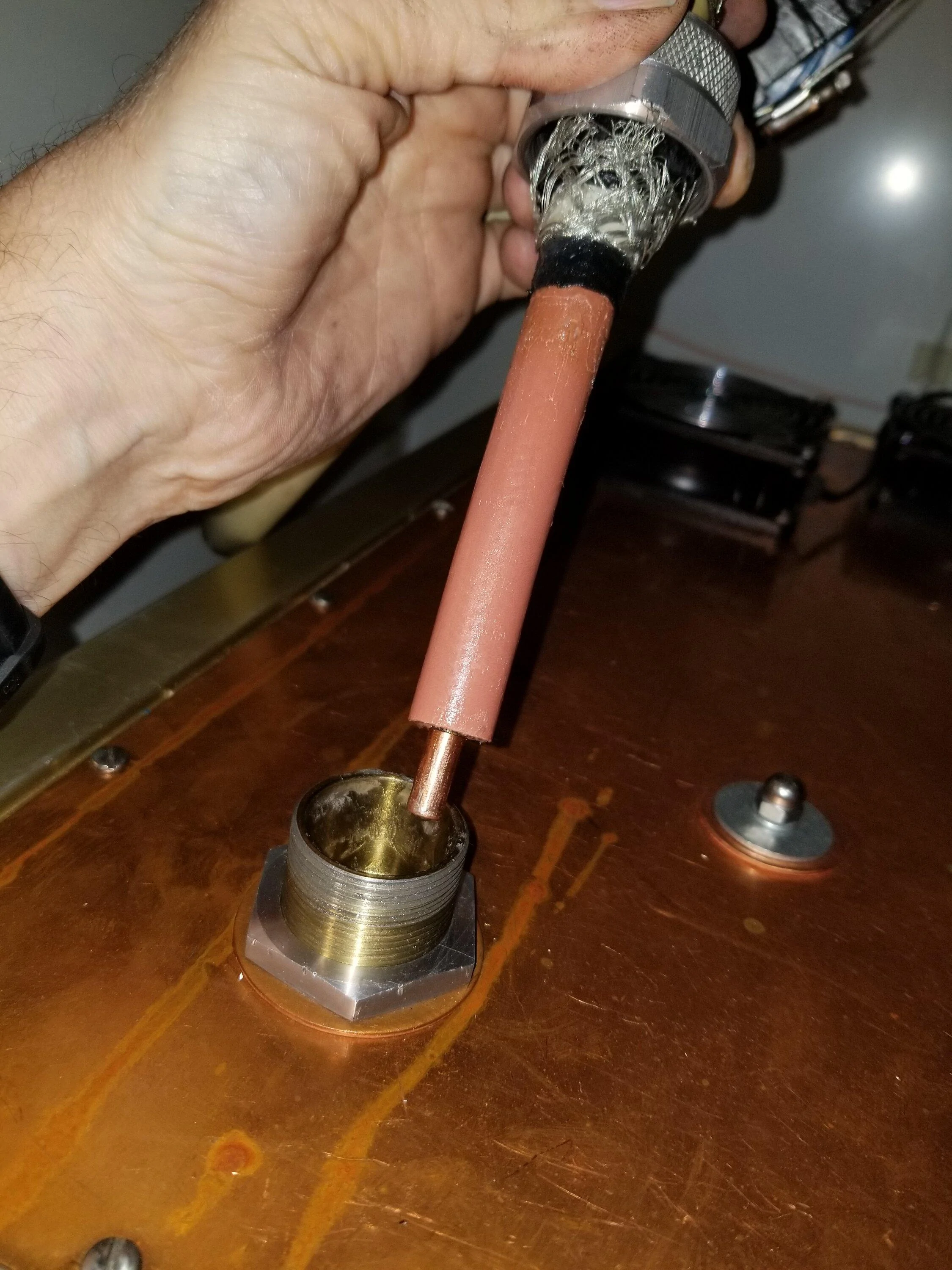

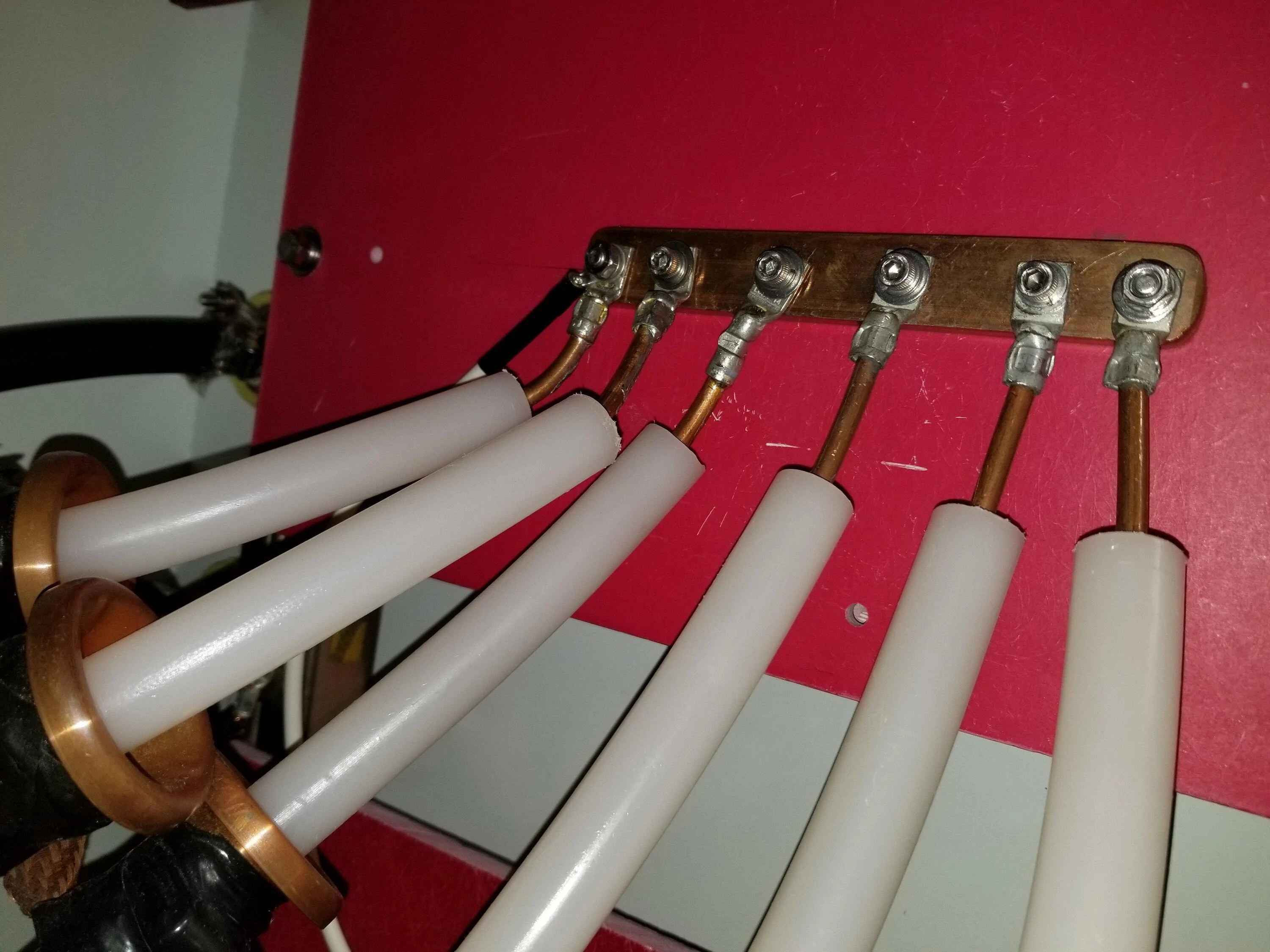

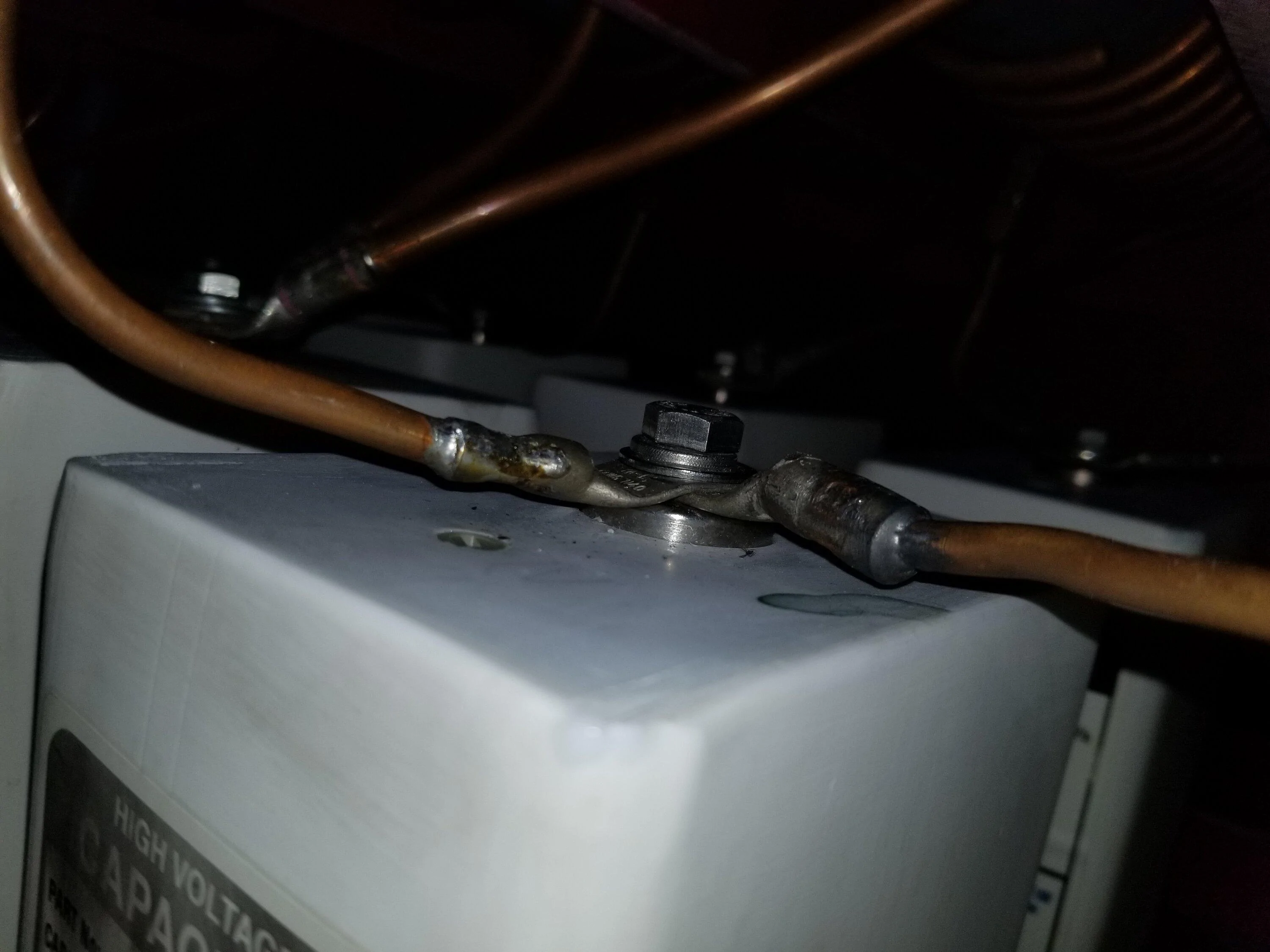

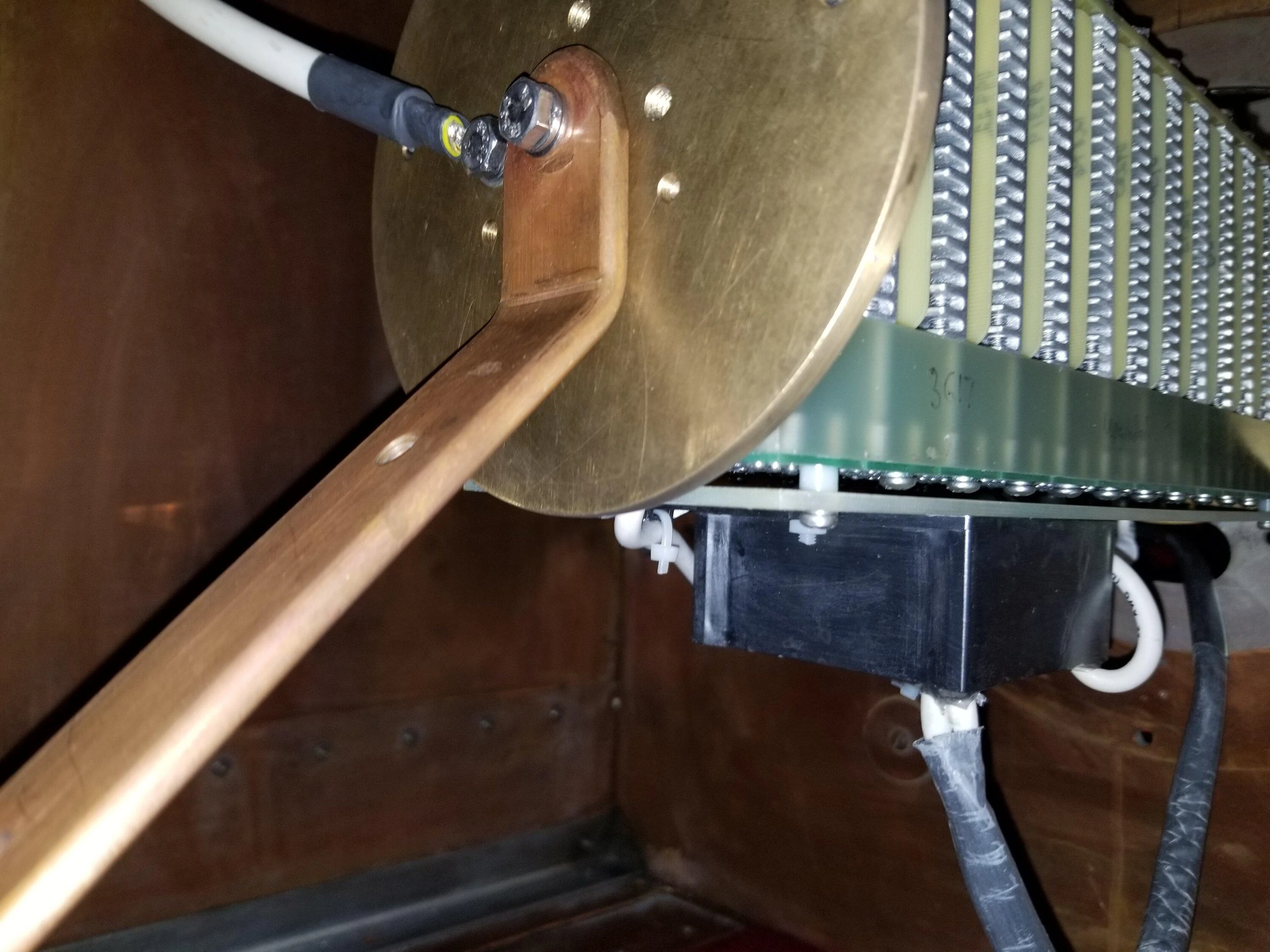

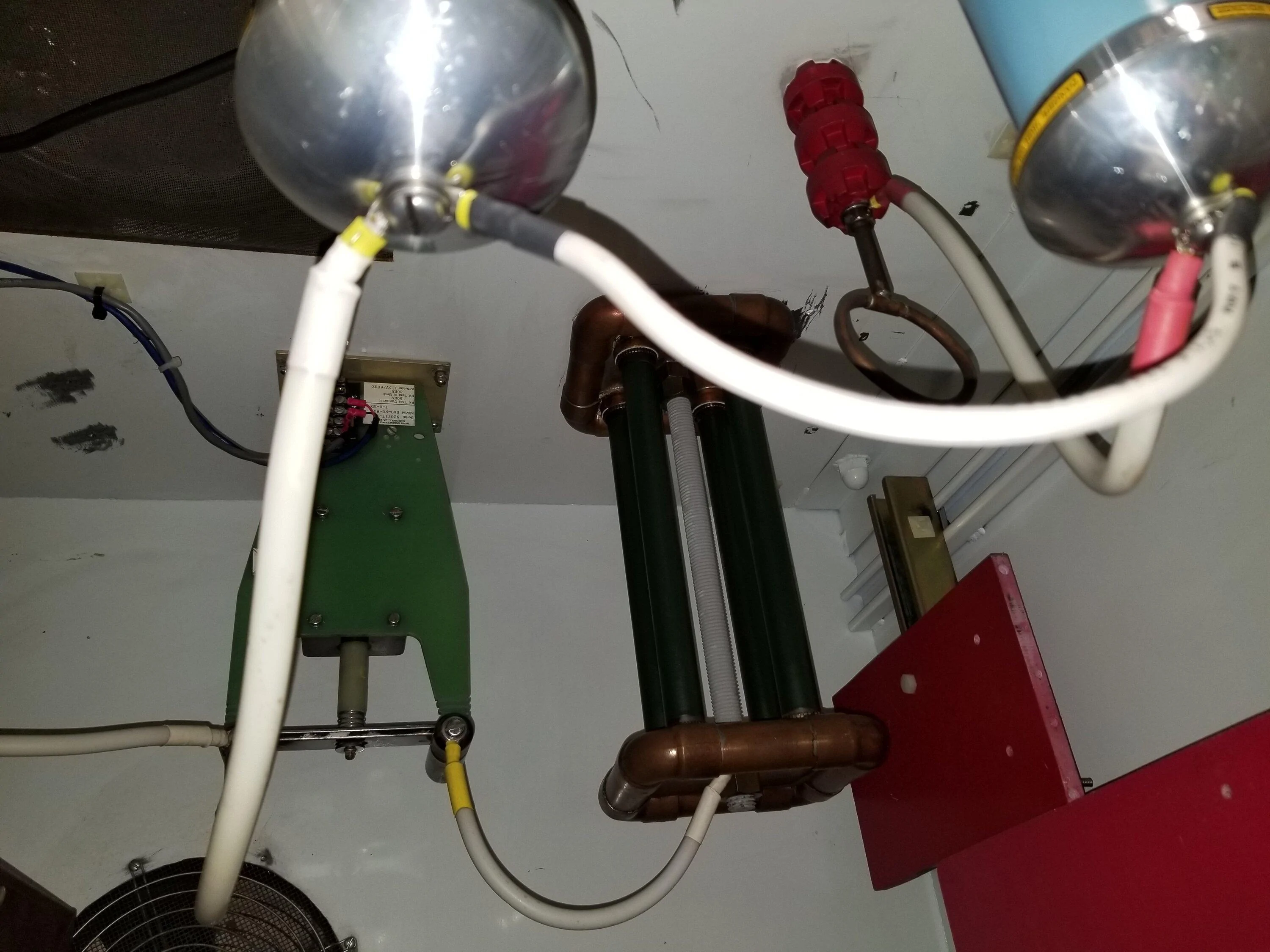

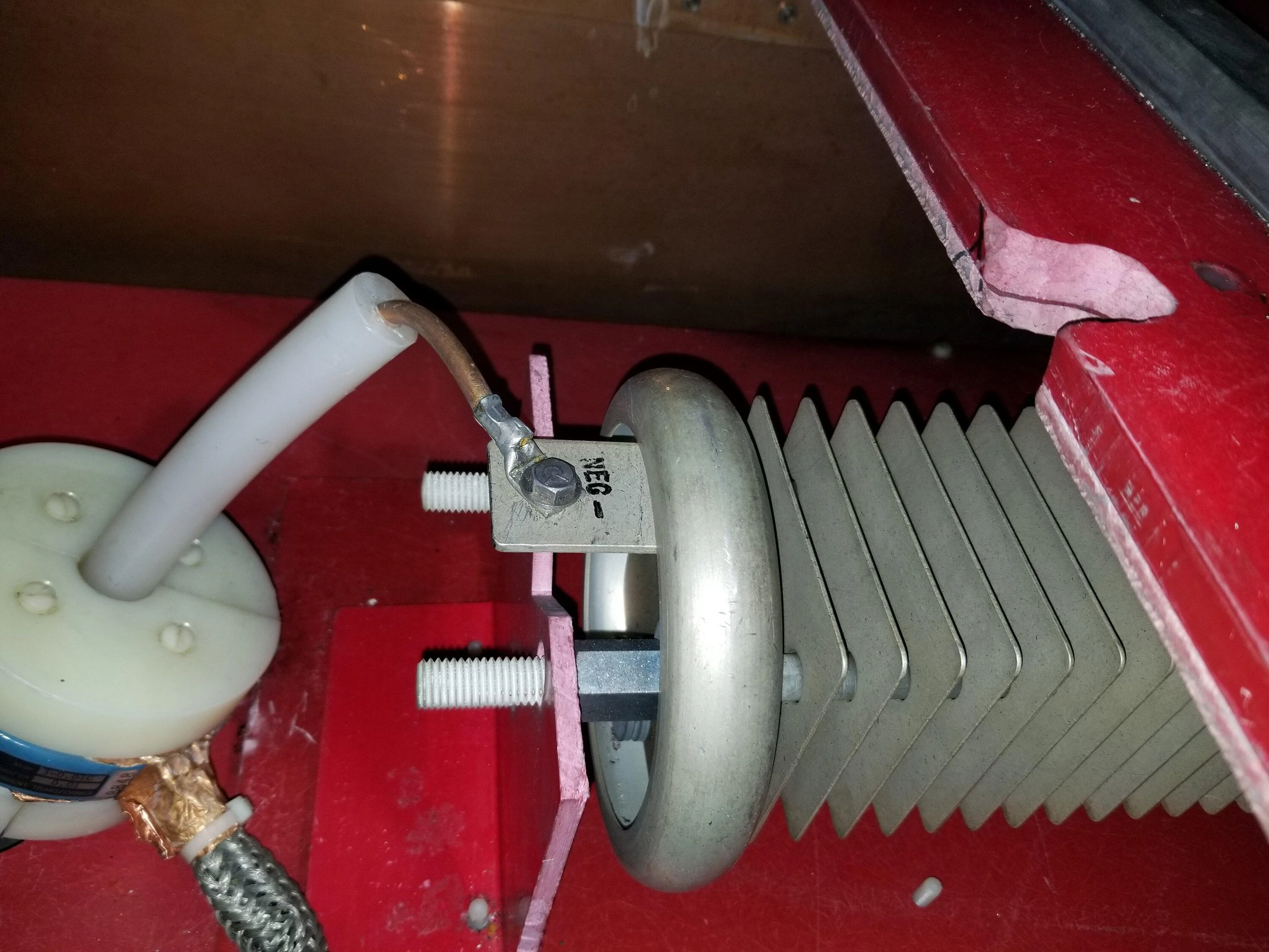

Someone here was making connections on their Maverick and asked me to post pics of connections I made. Some of these are over 110kV. I always solder the lugs, if you don't they oxidize, overheat and fail. I have more but they are in the tunnel and I can't get to them.

This cabinet is the Pluse Forming Network of an RF Modulator. We're inside of a big Partical Accelerator at Argonne National Laboratory
