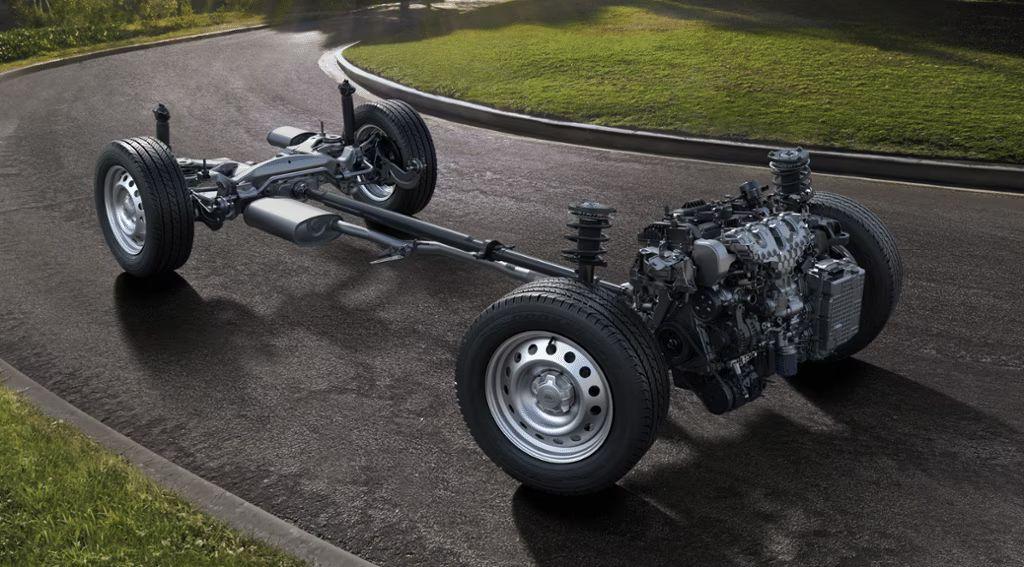

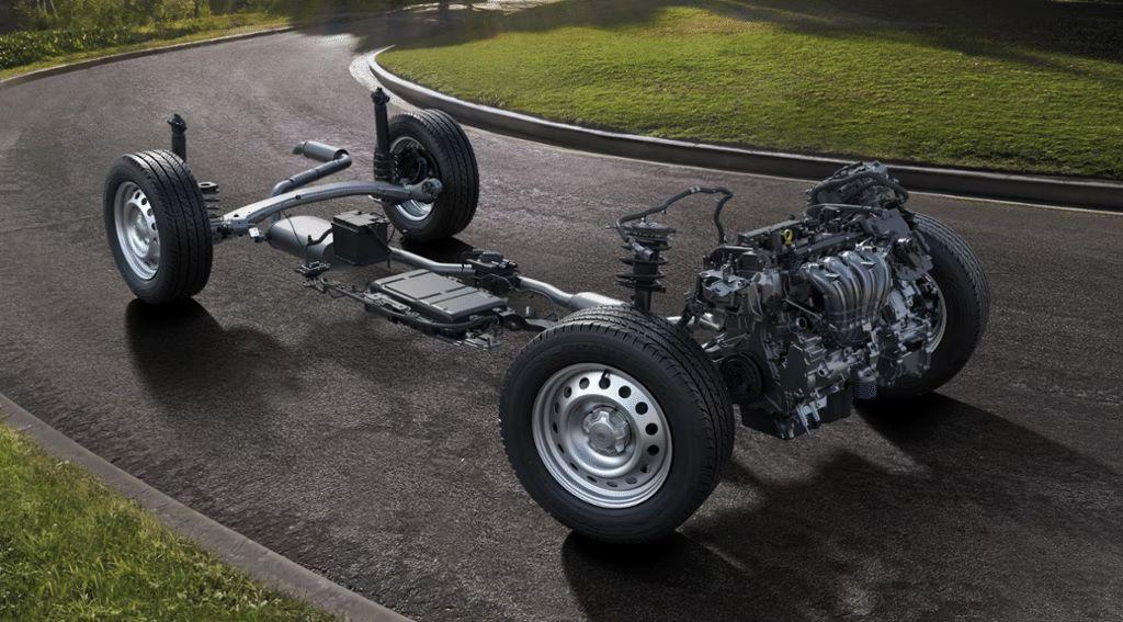

Specific to your question, "Do these models have the same body, and suspension and brakes?"
All hybrids are Front Wheel Drive (1st image), and most EcoBoost models are All Wheel Drive (2nd image) with a different rear suspension.
Ford Maverick Hitch Carrier FWD
Ford Maverick Hitch Carrier AWD
